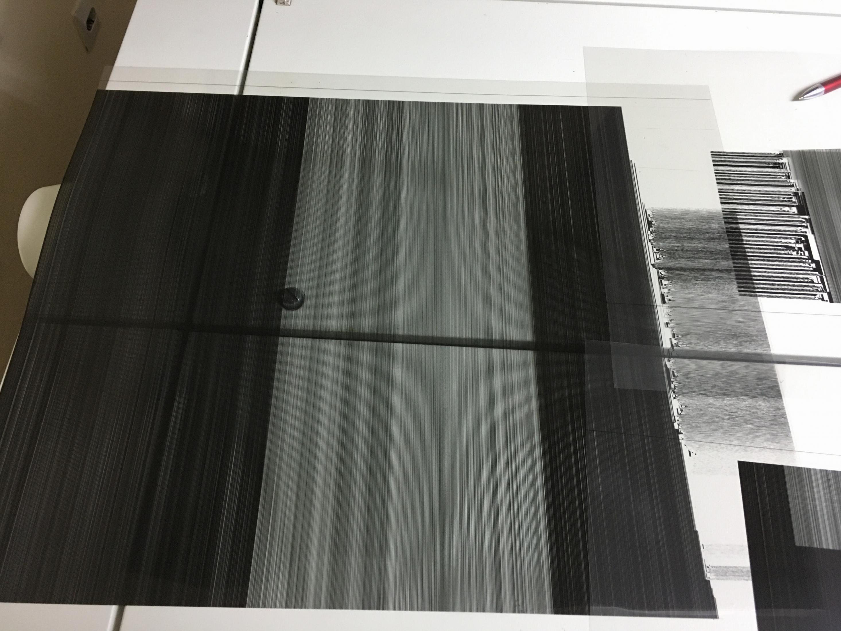

Hello,
i have big problem. Screen works perfect until start recording. Its comes to 20% and for a few secund finish. When film come out there is just a stripe or some undefine shape.
Anyone have same problem?

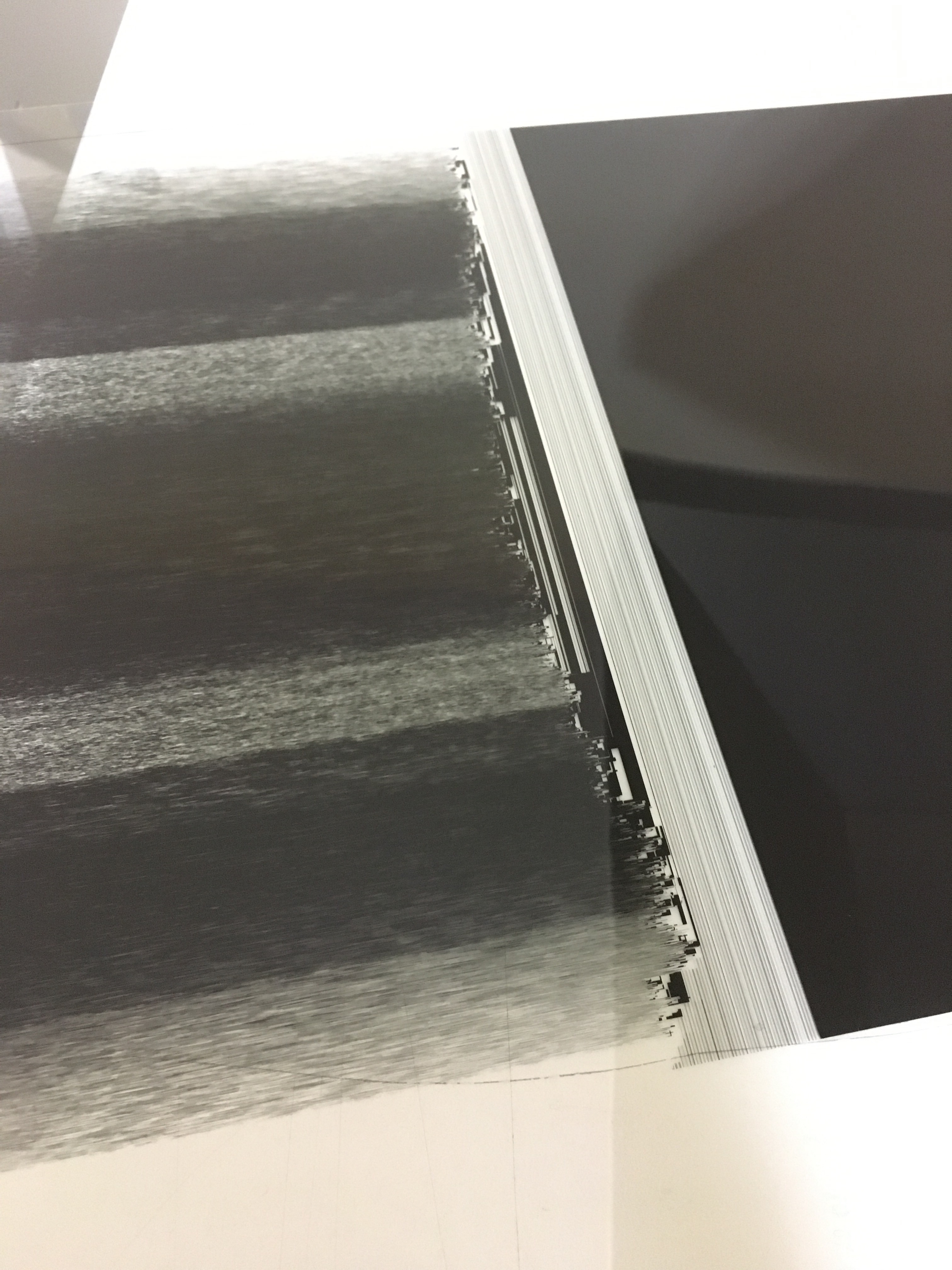

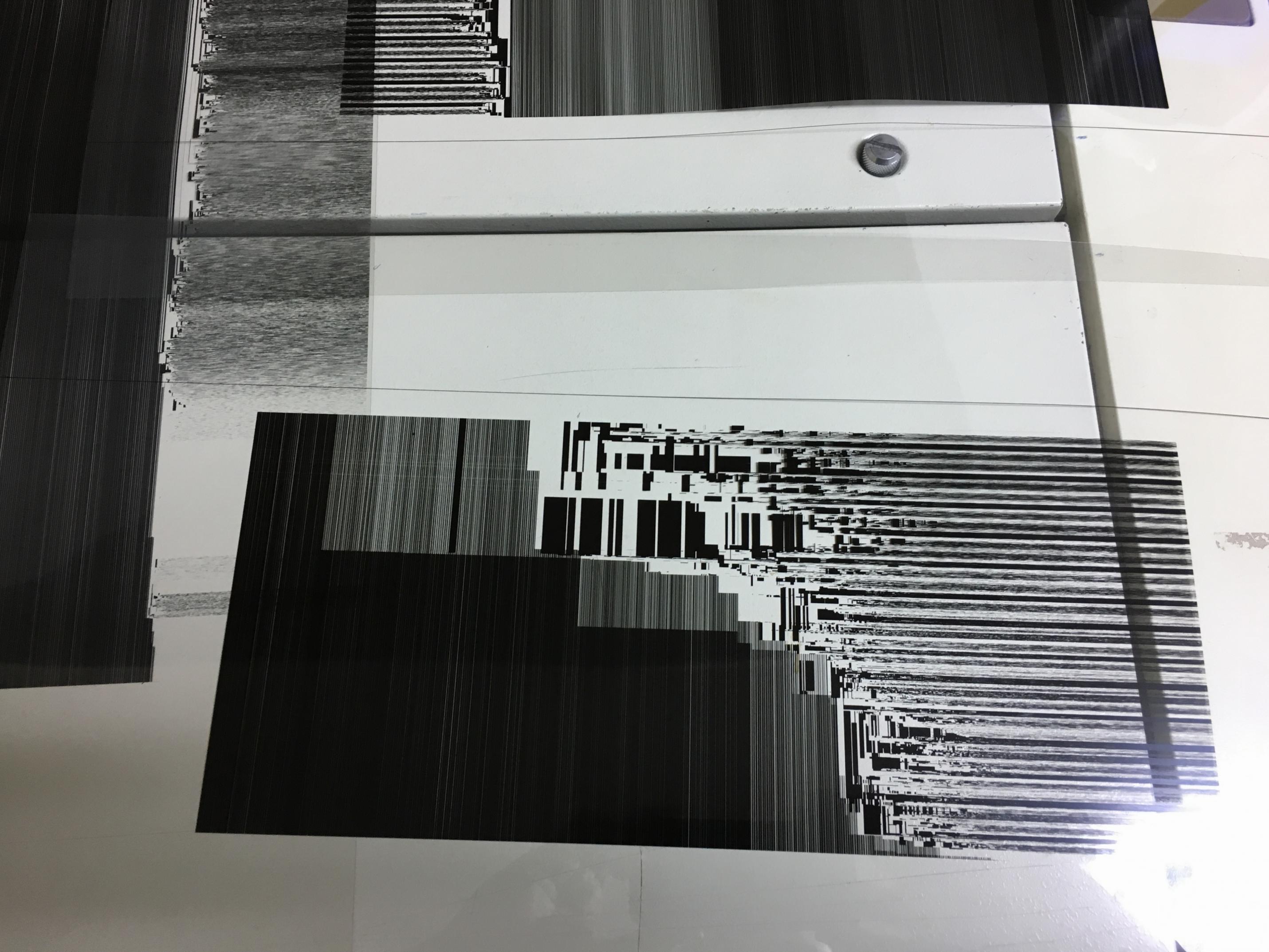

Problem is in Imagesetter, i just connect another RIP and its same.
Any suggestion what i should look on imagesetter. I have one more for spare parts, just to know what to remove.
If memory serves, if the hard drive is going out, it's possible to put a second one in there. It was done at one place where I worked, but it's been a long time ago. Just getting another drive would be a challenge, also.
