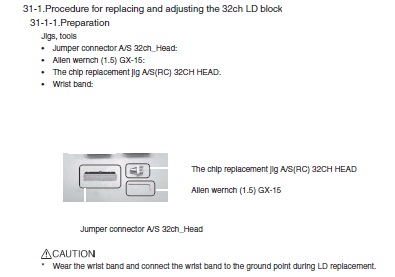

The tools for changing the Laser Diode.
Please open the attached file.
Hope this will help!
