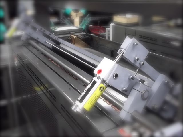

Interesting discussion..... to me worth spending some money to figure it out. Get rid of the ductor maybe? Duct gone missing.jpg
Interesting photo?
Interesting photo?

The rest of us can't tell much from that photo. Is that part of the ITB? It looks like the device pictured may move back and forth across the ink fountain. Again, can't tell much from that photo.
Al

What you see is the back end where there are two air cylinders that activate levers on each arm, that engages and disengages the blade. If you look closely, you will see the dark new pickup roller and the white blade mounted on the grey support bar. Nothing moves across the press. What you are seeing is just the method to clamp and anchor the unit to the press.
I delivered the unit on Friday, did some further assembly there and since the press was down, Jason3791 decided it was a good time to see how it fit in the press. Good thing too, since we found there were some issues that need to be addressed but basically it looks good at this early point in time.
As you know Al, I am not allowed to talk about this technology on this forum so let's not get into too many questions.
By all means do not violate any of the forum restrictions. I just wanted to put you in touch with the reality of what can and cannot be seen by the rest of us in that low resolution photo that we get via the internet. Don't loose your objectivity. Make an effort to forget what you do know about that photo and try to limit yourself to what your web browser delivers. My browser barely shows me the stuff in the foreground. I have to take your word for it that the fuzzy objects in the far background are anything like what you describe. My comments are about the picture, not about your engineering work.
Al

Al,
I did not take the photo and I did not post the photo and it was also a surprise to me to see it here. I think Jason3791 was just having some fun to post it early. It seems he intentionally made parts of the photo blurry. Looks quite artistic to me. :-)
Anyhow what is important will be the results and when that happens they will be made public. Details of this particular version are not so important since there are numerous ways to apply the technology.
