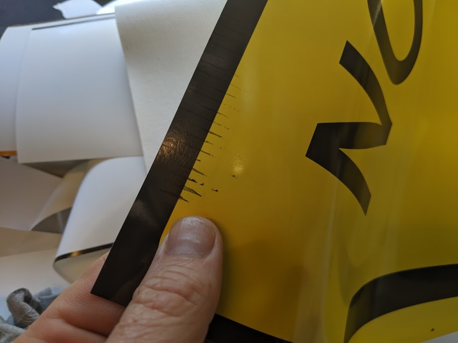

Hi I'm Jimmy
I am having this problem on every print but only when printing 24x18 size poster prints - it doesn't happen when I print 24x36 - it happens in the same spots every time and it looks like the paper is coming into contact with something it shouldn't that is smudging ink on it. Any help appreciated!
That's what's known in the trade as a head strike. The media is buckling in that spot for whatever reason and the printhead is hitting it as it passes over it. On the ipf, usually that caused by too much ink for the media, so the media cockles and that causes the buckling and the head strike.

Thanks for the help - it was the print head striking the paper - I switched from a glossy poster to a semi gloss and I think the new paper had a bit more spring to it and was why the print head was catching it - I increased the vacuum to max and raised the print head height to standard from low setting and all is well now. Thanks for info!
