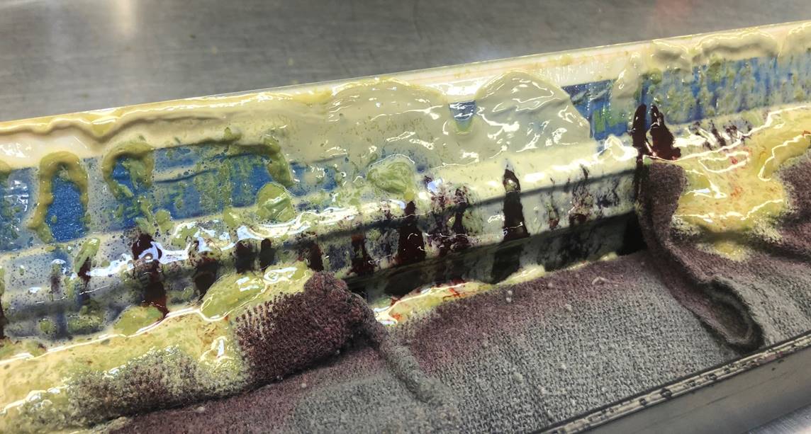

Update (about the Calcium Slayer & Flush):
The attached pic shows the crud after one application. We did it a second time and hardly anything came off the rollers.
But it's important to note that prior to this, we performed 3 cleanings with another product.

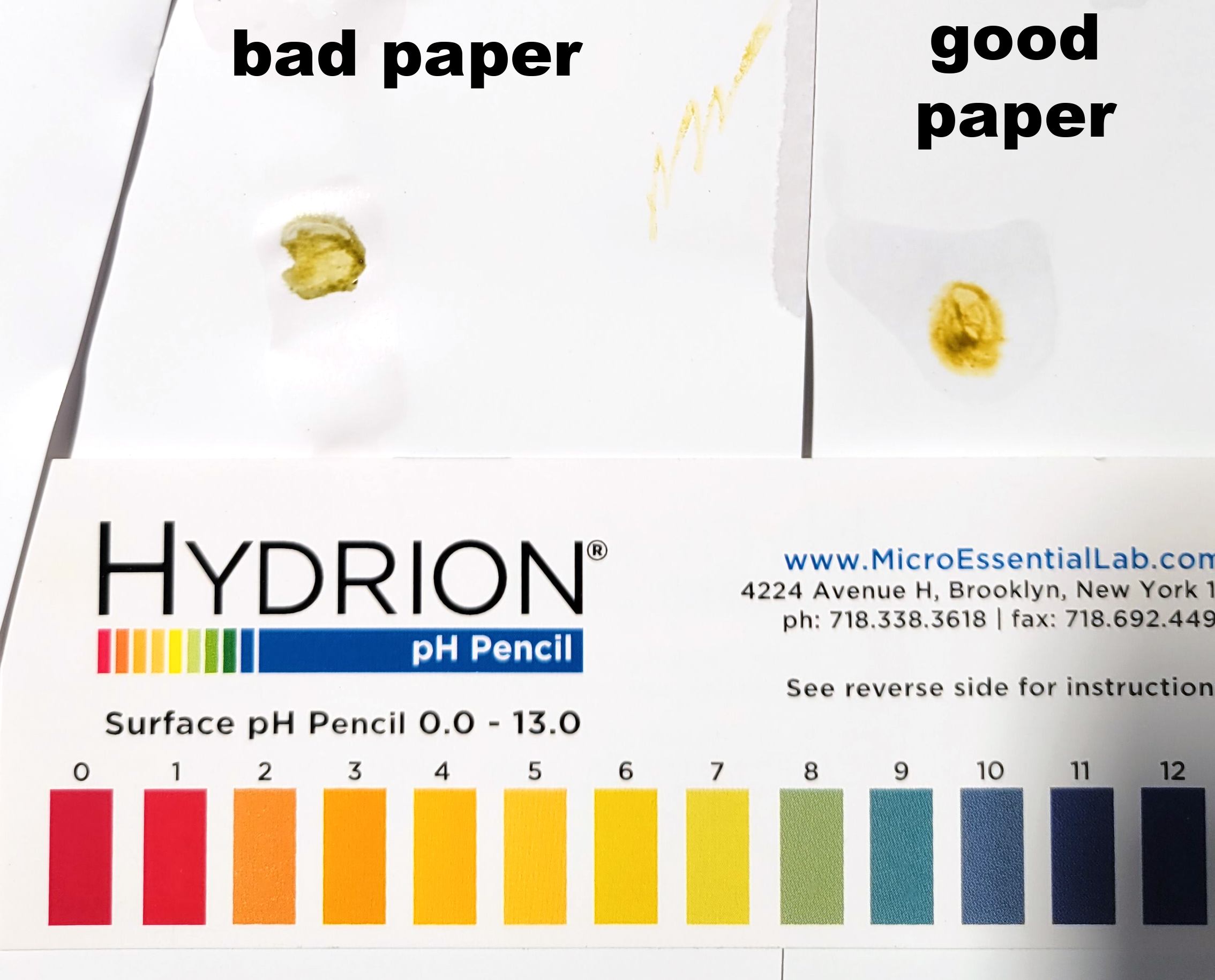

UPDATE:
Acquired a pH pen that shows approximate pH.
After several attempts to create a clean example, this is the best I got. See attached.
question: would you think this difference in pH necessitates a different FS for each paper?
(what's not shown is our previous paper, which had a very similar pH to this new paper; keep in mind, the previous paper did not produce "splody dots")

Welcome back - curiosity,
Are you using TopKote manufactured by OJI Paper of Japan?
if so what GSM?
What makes you think that this paper is causing you problems?
Using the Hydrion Colour Chart Display - I read pH 6 which is Neutral.
Regards, Alois
Yes, we are using TopKote, 100lb gloss text, 197M
I think it's the paper because our previous paper (Endurance 100lb), of which we have a small amount remaining, when tailed into any set running TopKote, does not produce "splody dots".
I read the pH closer to 8 (sample on the left).
Hello, curiosity,
I strongly suggest you re-test and try to show an image, not a "Splody Dot".
Have seen your Paper Salesman about this problem? OJI Paper are a top-class manufacturer of Paper in Japan.
Your reading is in the Alkaline pH area. Your next task is - show a picture of the Plate Image Area of the printed image.
Regards, Alois
curiosity, OK.
1) At the start of your post, you showed a picture of your so-called "Splody Dots" on paper. NOW show an image of the same area on the plate.
2) When you re-test pH, write a capital letter and a line, reasonable size.
Regards, Alois
