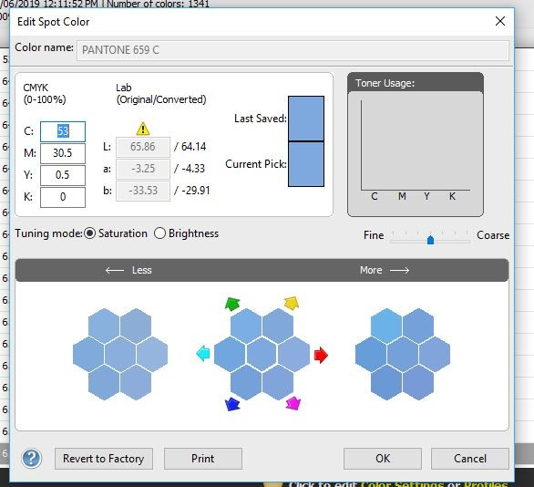

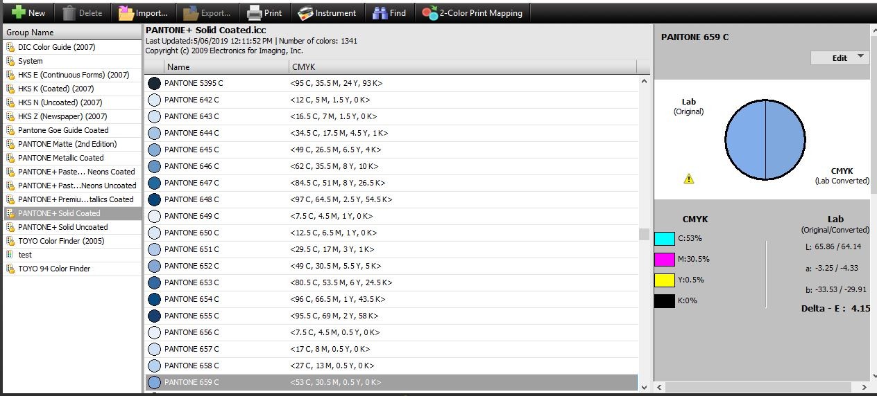

Hi there. I'm running "Fiery Command Workstation 5" my rip is an Ex-P 2100. For the life of me I cant get my Pantone spot colours to change when editing them threw command work station.
I'm doing all the obvious things. eg making sure the name is exactly the same in the file as in the list. For example PANTONE 659 C is exactly the same in the file as in the spot colour editor both are written as PANTONE 659 C.
I'm processing and holding the file. I have tried removing the Raster. It does not seem to make any difference if I create a new colour or edit an existing pantone colour. Maybe someone can flick me a link (I have tried youtube)
Your help is much appreciated. thanks Simon

Are the calibration profiles selected the same, in the job parameters color tab on the job and are you editing the library for that calibration.

Do you have "spot color matching" turned on in advanced color settings for the job? Is it just one problematic file or any spot color from any file? I've seen a few PDFs where the colorant name had a space at the end.
I once had some strange caching problems that required me to delete the entry and recreate it to actually update the values. When I was diagnosing that, I changed the values back and forth from a contrasting color (like making Reflex Blue yellow) to the values I wanted to make certain they updated correctly.

So just want to go over a few things you may have already done:
!. In "Color Management" window the "Spot Color" box is ticked ("Spot color matching")
2. It doesn't matter if you have v.2 or v.3 library. What matters is the spot callout in the file is spelled EXACTLY like the respective Pantone in the library.
3. Check the job properties of the file in CWS to see what Output Profile it is using. Go back to Device Center>Resources>Spot colors and at the top most likely a drop down make sure the output profile matches the one being using in the job properties for the job.
These are all things that need to be established to effectively make this work as far as changing spot values. Also not sure if your sending through Acrobat or not but to eliminate human error (conversion happening that your not aware of) just drag and drop the file into the hold. This of course assuming #2 above has been addressed.
Good luck!
BTW I would be more than happy to check if the works on my end for you if you would like to attach it.

It has been my experience that if you have multiple versions of any of the Pantone books in there, it absolutely does matter which version you are using and sending. Just my 2 cents.
So it may cause conflicts on some machines however I have never heard of it being an issue. However, again, that may not be the case for all machines. The thing is you can actually have multiple libraries v3 and 2nd edition coated for example and when it looks up the Pantone it actually will start with the library that is first in order from top down. In other words if v3 coated is on top of 2nd edition coated it will first search in the v3 library.
What is possible is giving this situation the operator can actually be trying to change the 2nd edition for whatever reason and yes that would not result in a change.
So I have notice that the difference being the recipes have been reworked from library to library so in that case yes it might matter in that case because the formula has changed (if at all).

I haven't used a Fiery in a while as we've moved to GX on both 2100 and Iridesse but from memory rather than making a generic across the board adjustment is makes it against the specific calibration and maybe stock that you select when running the adjustments.
If you set that to the same at the top of the spot colour adjustment screen (again from memory) and change the spot colour to something way off then set the same stock and calibration in the specific job will it work?

As I recall, your edited color definition also has to reside in a group on the top level of the group list, since the color management does a look-up from top to bottom in the list of profile groups. So it uses the first definition that it comes across.
