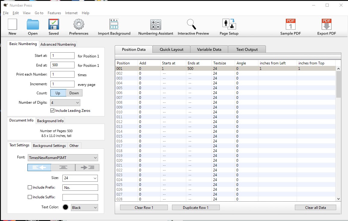

We use Number Press 8 to number everything, including 3NCR. It was very inexpensive and you just set up the numbering import a pdf of the background image and it generates a PDF of the entire file for printing. We use it for receipt books, half sheet 2NCR and many other forms. We have two licenses and all of our forms and backgrounds on shared network for both to access.
