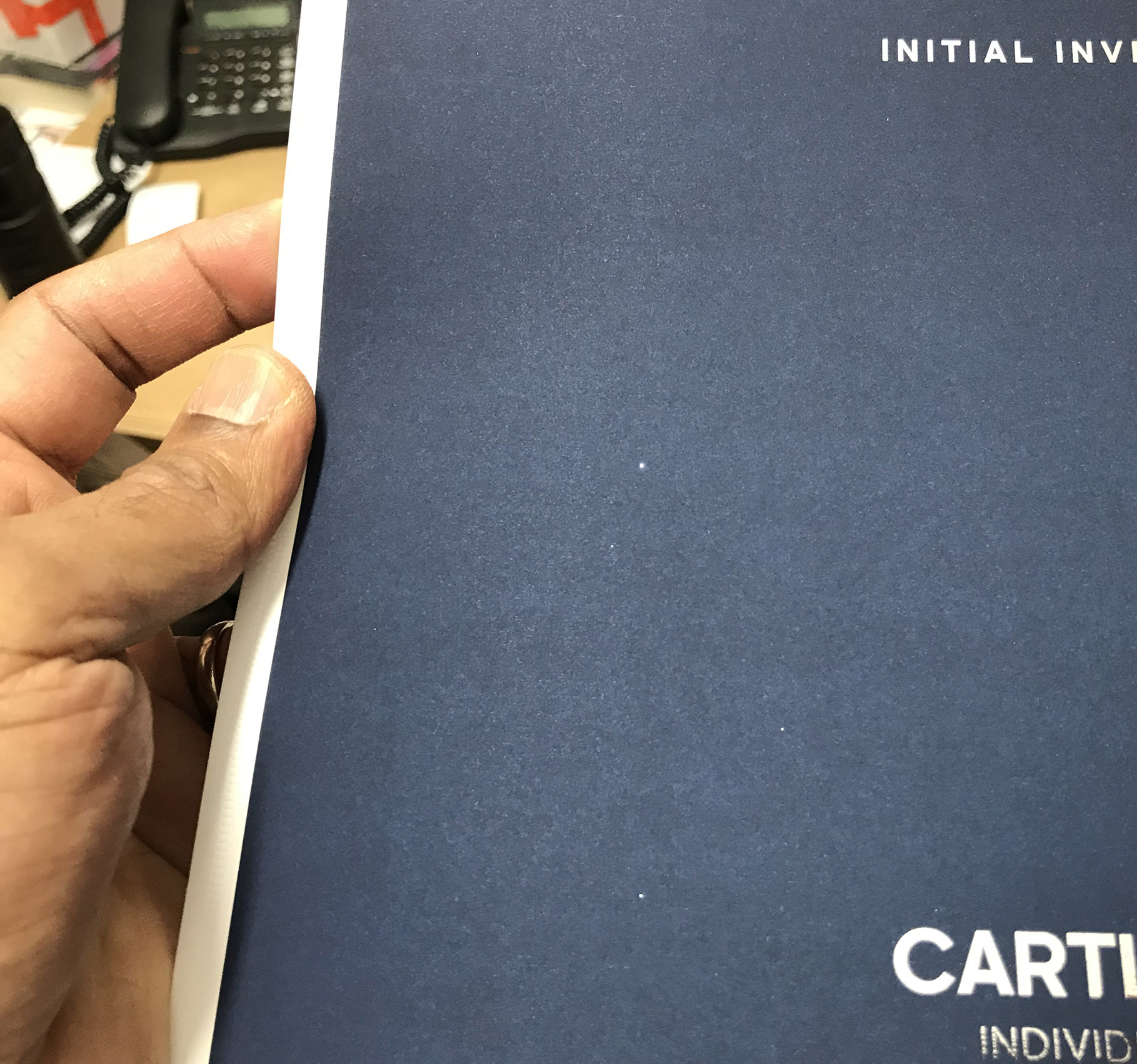

I've got a Vivid Matrix 370P along with Xerox Versant 80 Digital Press. When using the Matrix for foiling on plain smooth paper its perfect...very fast, accurate, clean and no foil spots. But when I try and foil onto Soft Touch Laminate I get random spots of foil in different positions on some of the sheets (not all sheets).

Attached is a photograph showing you my problem. The pic shows the spots larger than they actually are because of the shine from the lens. They are actually more like glitter spots, but they are all over the sheet.
