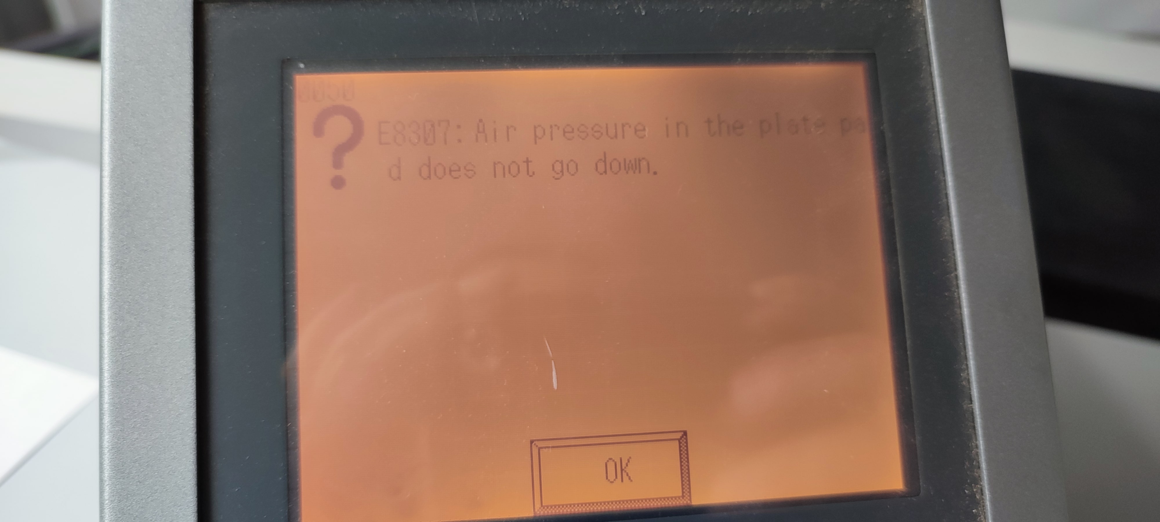

Have he following error, anybody here knows where I could troubleshoot?
E8307. Air pressure in the plate pad doesnt go down
Insufficient vacuum, worn out suction cup(s), air leak somewhere or vacuum sensor incorrect adjustment. Most likely first or 2-nd from this list.

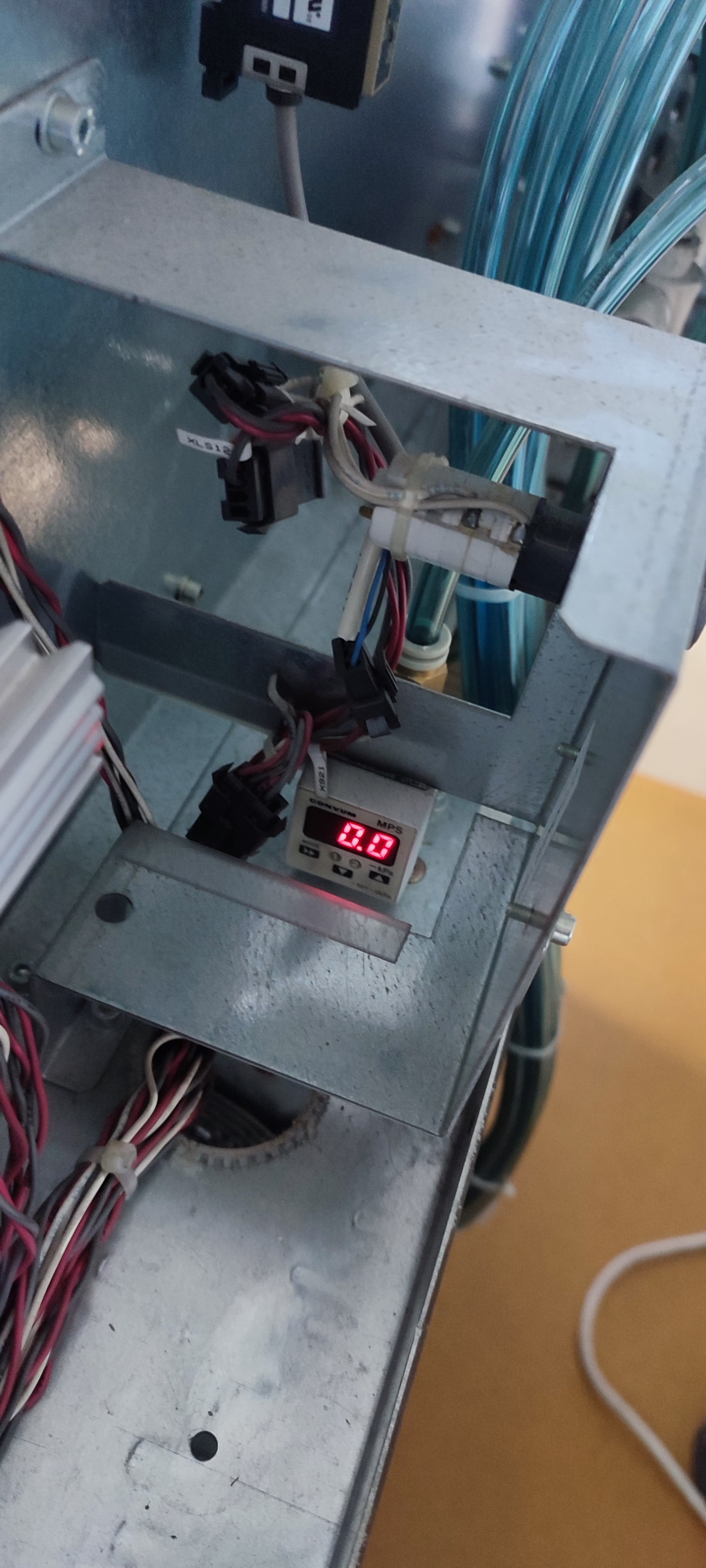

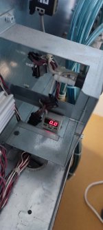

Not sure how to adjust vacuum.. its on 56.2 when the gripper is going for the plate..

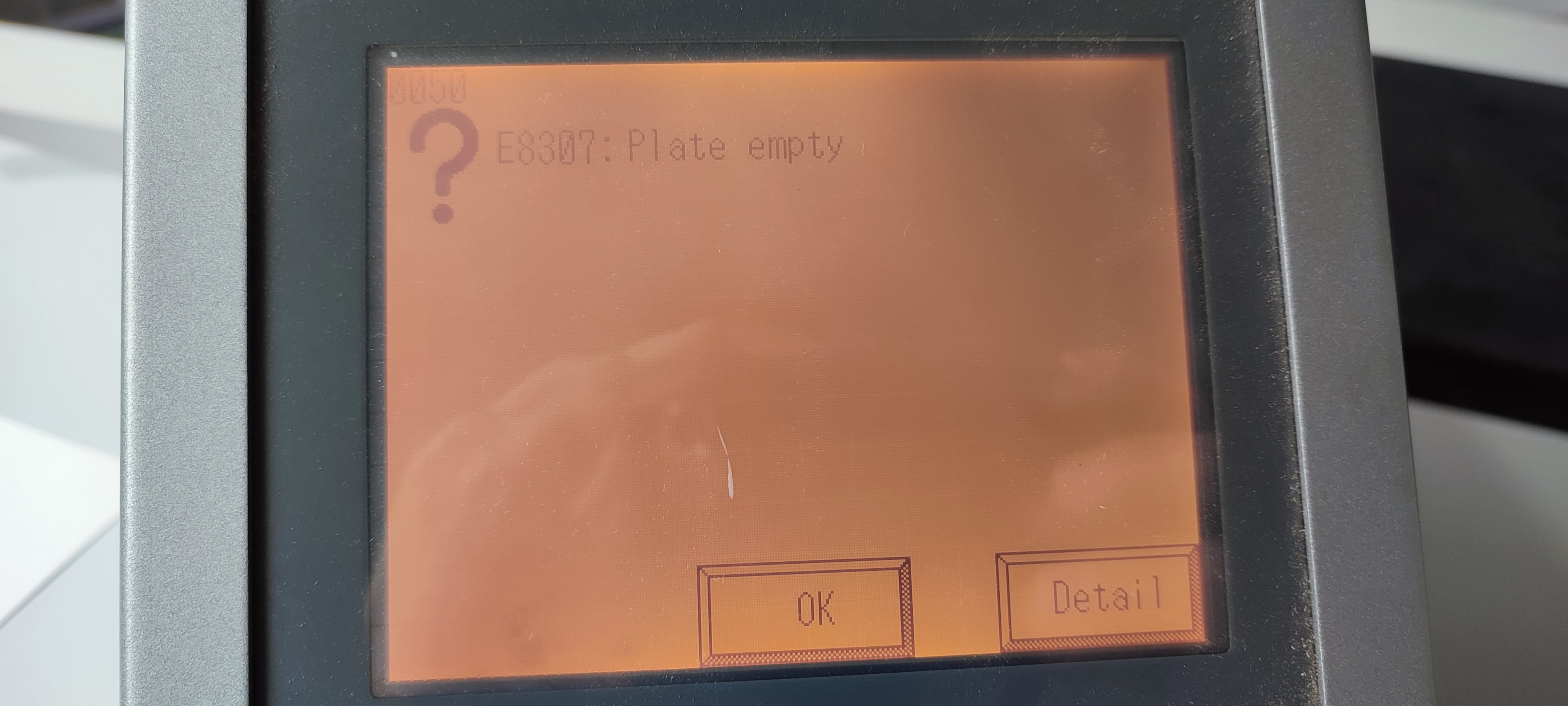

Hi sir;
You must test the sensor for plate empty, clean it, and look, for loose connector, or loose wires, or dirty wires, or corroded, clean with special electronic contact cleaner.
2) If the probleme persist , after you done the step mentioned before replace sensor
3) you can test the sensor easy; with the camera eye from his cell, you will the sensor with light blue, normally with the eye YOU can NOT do it, since is I.R.
4) look, for to see if there are voltage, in the sensor too

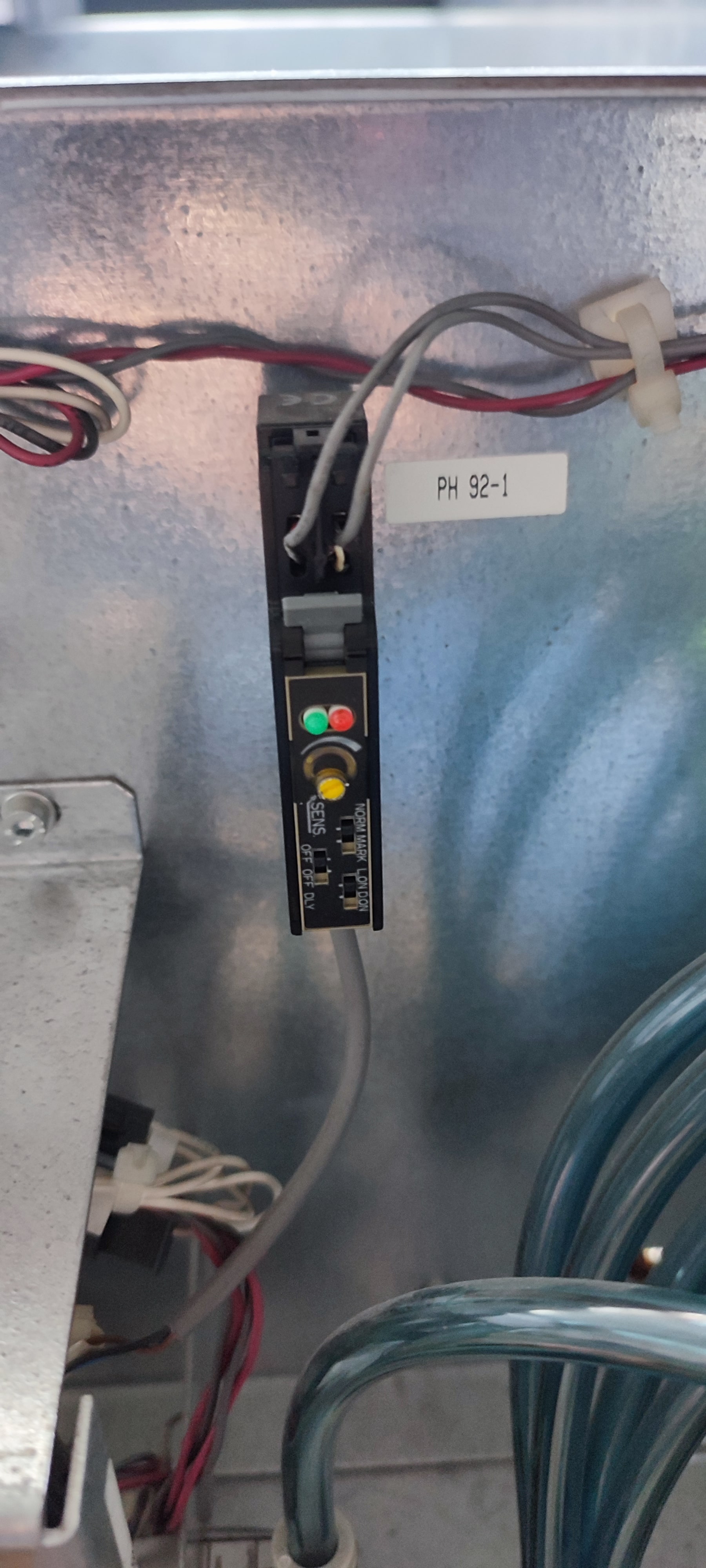

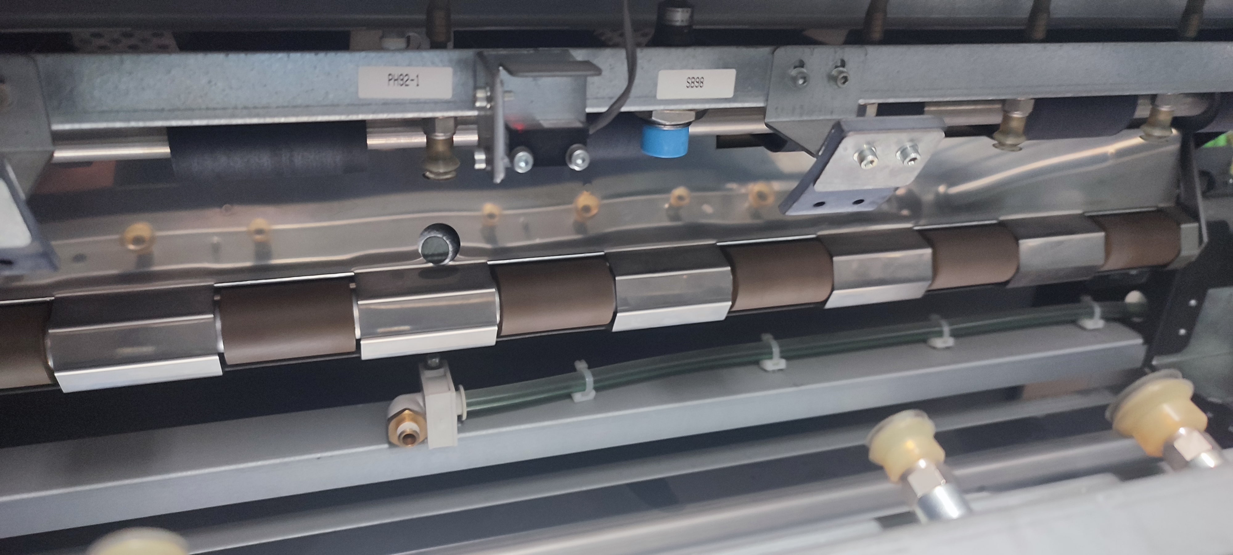

Here are two sensors. Is it one of these?
Sometimes the loader works, is 84 pressure normal when loading a plate?
The red light sensor works fine. But the blue one doesnt seem to do anything.
When should it beep? When it detects metal?
Instead of replacing the blue sensor, first try moving it further down closer to the plate. Also, those suction cups should be replaced, or at the very least cleaned.
Attached two other sensors. If I get close to the blue sensor it works..

vance, you will notice some sensors have a sensitivity trimmer you can play with and check the LED sensor switching state on and off. Can also change sensor distance to target and/or parameters in software before deciding the sensor is damaged, matter of fact they rarely need to be replaced. One more thing I don not advise you play with the vacuum sensor programming which is quite complicated just leave this one alone. If there's a vacuum problem check pump efficiency/leaks/hisses first.
