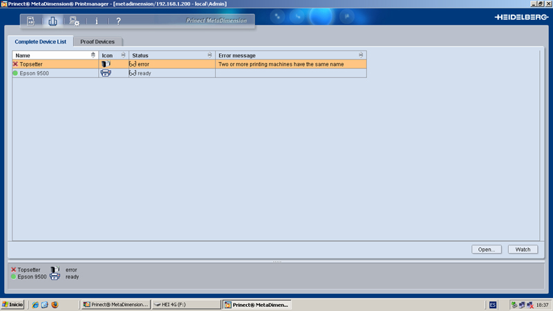

I have a Screen CTP PTR-800 with Harlequin RIP.
I buy the PIF Card from Screen to connect the CTP directly to RIP Metadimension.

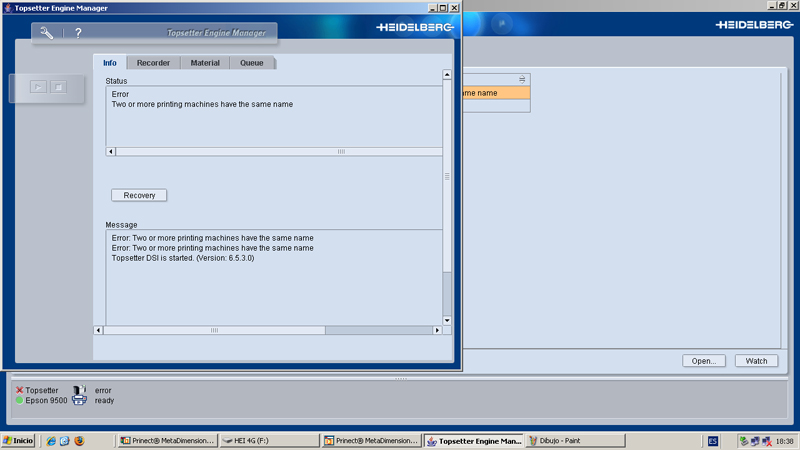

But I have the follow error: "Two or More Printing Machines have the same Name"
I believe that the CTP have a repeat printing plate or Comments with the same name, but not I donn have any of of these, also only have 3 plates, so there not much to check in the CTP.
If any can help me appreciate.

The issue is in the topsetter, there is two printing machines with the same name, you must verify in nthe Topsetter panel this names
