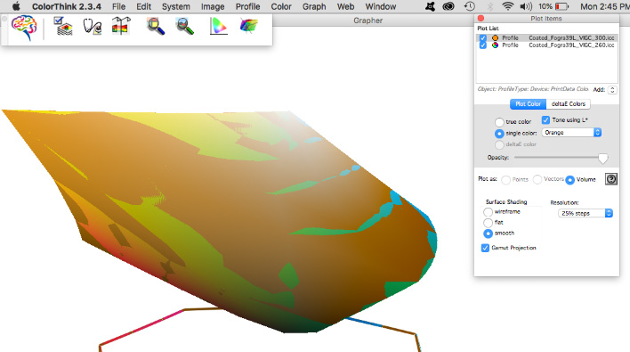

I understand "gamut" as "scope"(?), let us have a look to the lowest L-values at a 3D-visualition of different TAC-Profiles in colorthink tomorrow, I am without the software at home now ;-)
This is what ColorThink shows me comparing Coated_Fogra39L_VIGC_260 to Coated_Fogra39L_VIGC_300
The 260 TAC shows an insignificantly larger gamut (color volume) than the 300 TAC - even in the black where it's both insignificant and irrelevant.

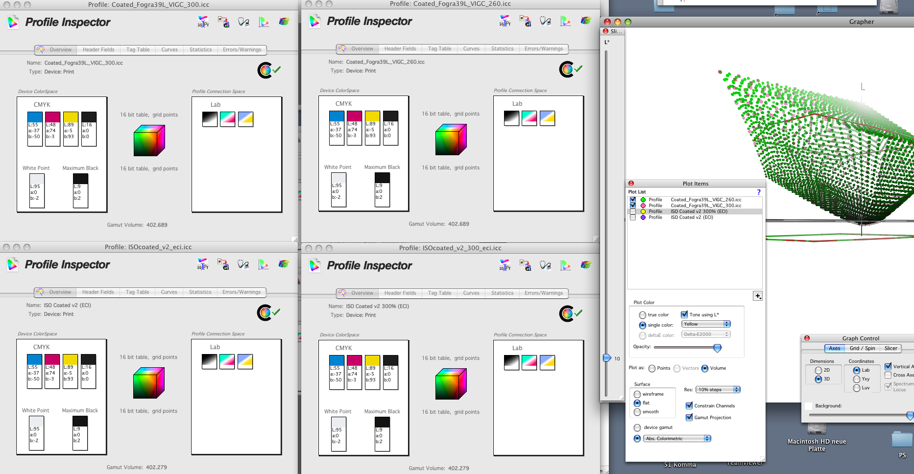

Wow, surprise, surprise, i did not expect that:
Also the ISOcoatedv2 (TAC330) and the ISOcoatedv2_300 (TAC300) are coming with exactly the same Gamut compared together:
402.279
The two VIGC´s (TAC 300 and TAC 260) with a slightly bigger one: 402.689
But all four are based on the same Characterisation Data set FOGRA39 what means same solids, White Point and Maximum Black (and same screen of course...)

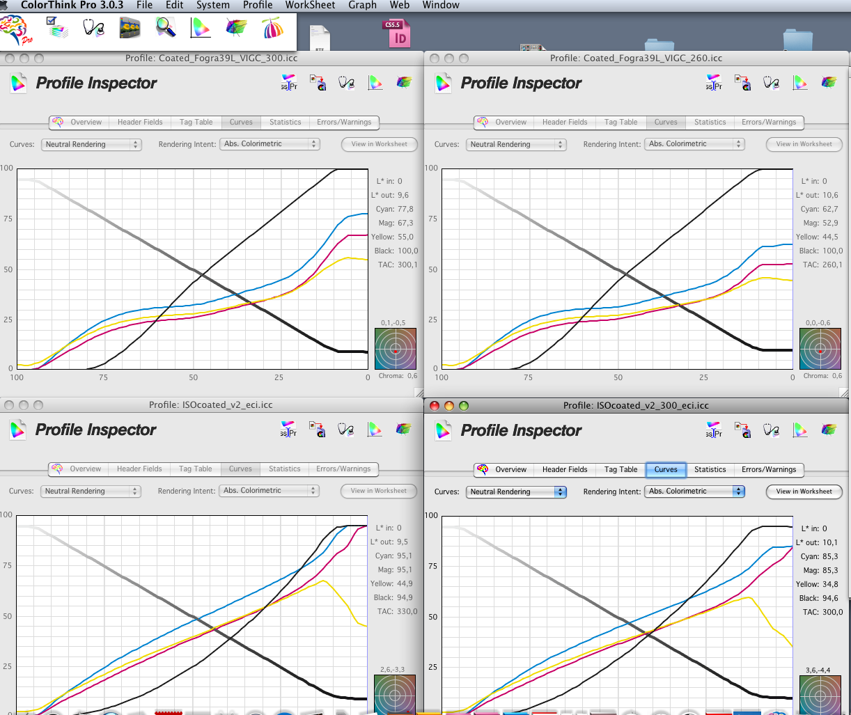

But there is to find a darker Maximum Black by the higher TAC´s if you look at the neutral rendering, as i expected
VIGC_300 L*out: 9,6
VIGC_260 L*out: 10,6
ISOcoatedv2 L*out: 9,5
ISOcoatedv2_300 L*out: 10,1
might be the reason for the congruent gamuts is to find in the fact, that the separations are coming from one and exactly the same data set FOGRA39L which is made by a chart with color patches up to 400% and the measured XYZ-/Lab-values from all patches are determining the aims for a separation, but than i do not understand the (slightly) gamut increase in the VICG-Profiles compared with the ISOcoated ones...?

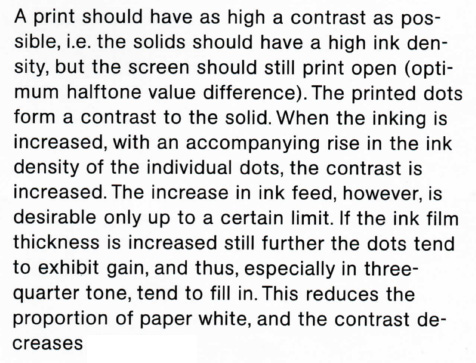

Hello, Gordo/ Ulrich and fellow Lithographers/ Pre-Press
A PDF - Colour and Quality = Farbe + Qualitaet.
Regards, Alois
  • Colour and Quality # 1082.pdf
Regards, Alois
Thanks for that.
Here's the salient paragraph:
That applies in a film to plate workflow where linear film is the standard file transfer protocol.
In a CtP workflow one would apply a dot gain compensation curve to restore print contrast
Ulrich
