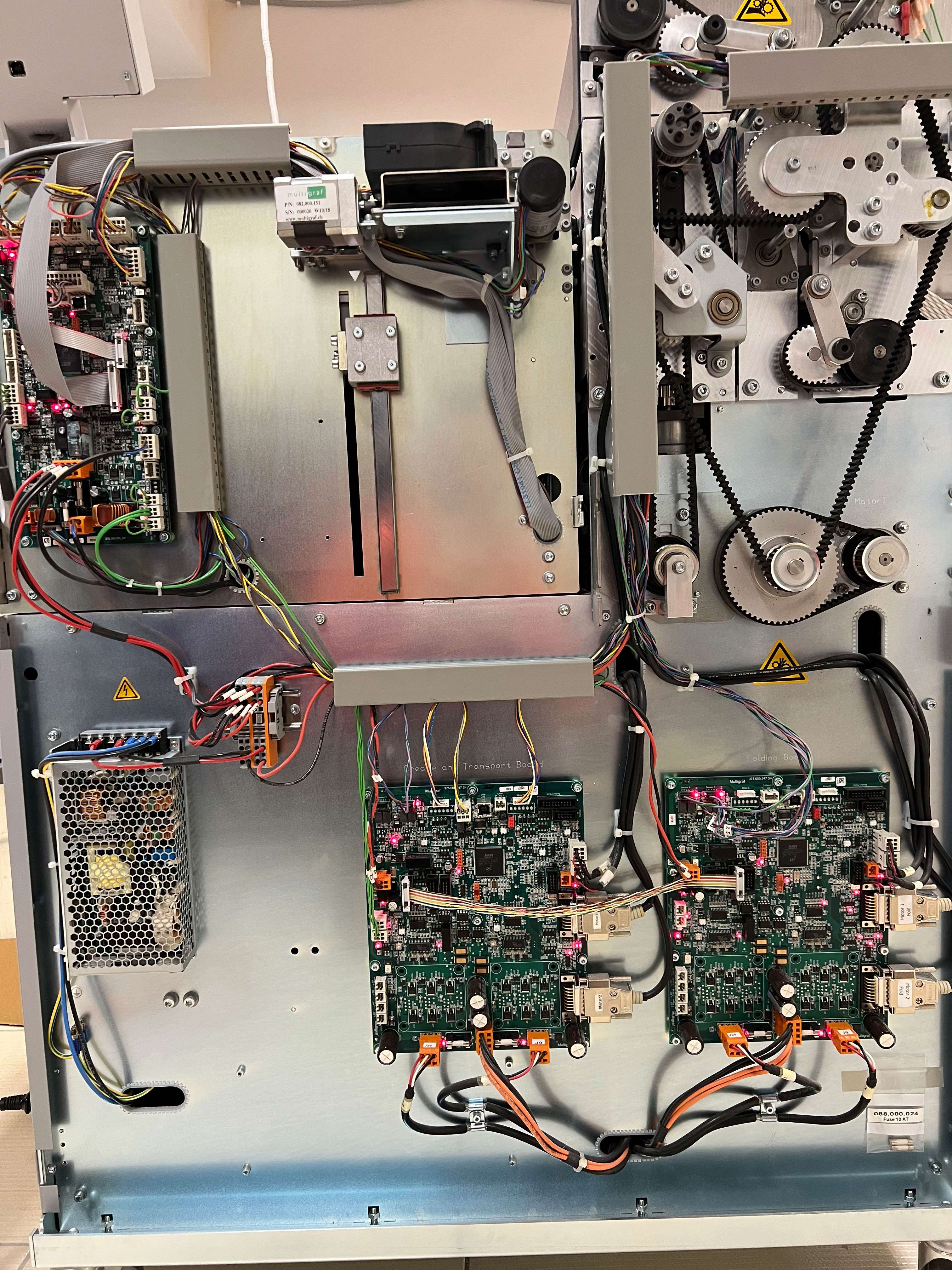

Motor Circuit Board 2 controls the fold motors. Motor Circuit Board 1 controls the crease motors. Each board should have 2 fuses on it.
all fuses are good. All motors spining. It feels like its lost its calibration :(

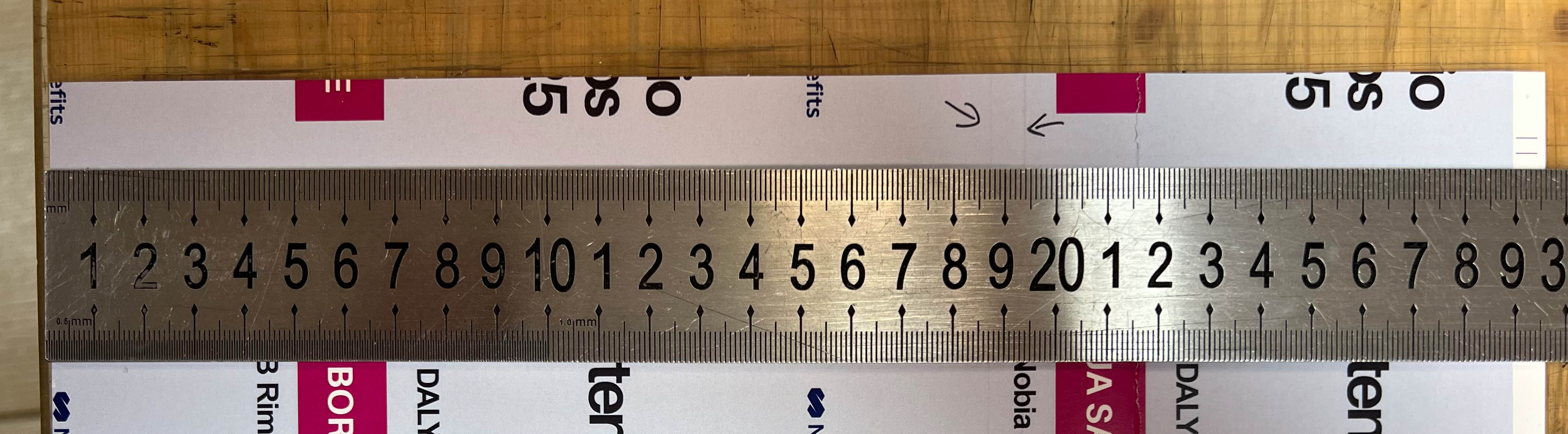

I've added photo of how it tried to make trifold from a saved preset. Obvoiusly it cant count distances. Creasing lines are marked with arrows in the photo.
