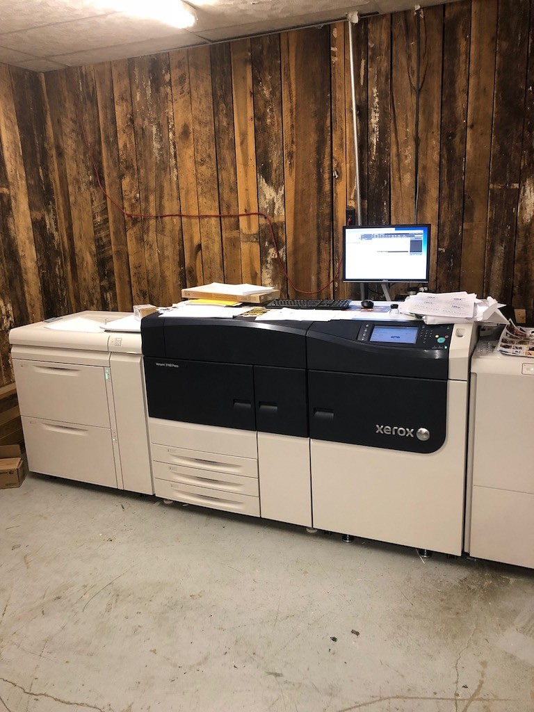

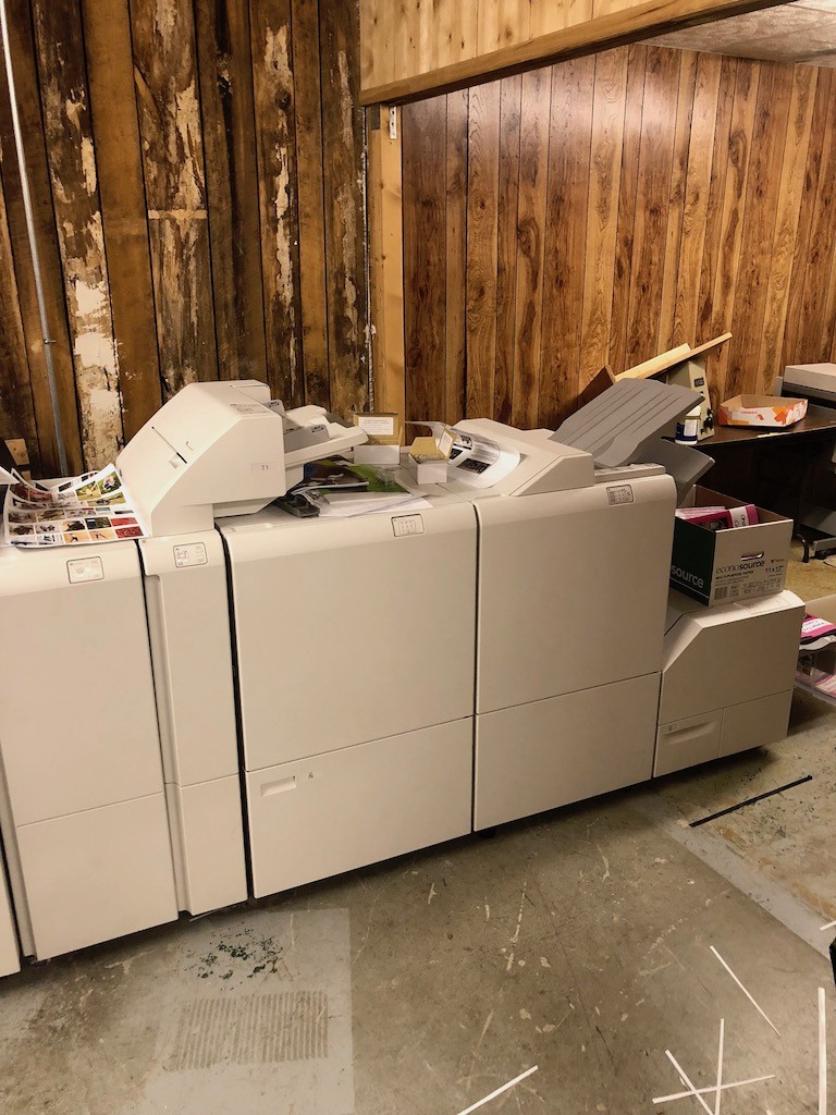

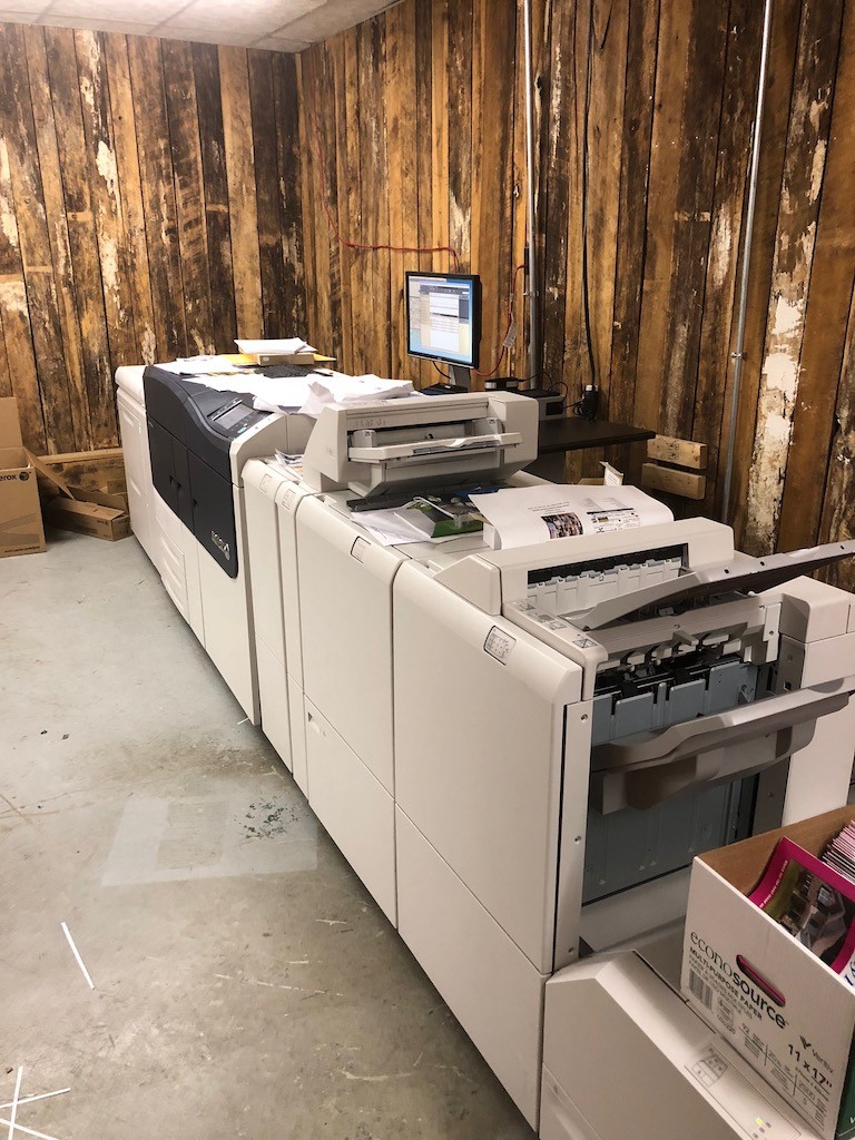

Yeah on something smaller I'm pretty sure you would experience it. Especially for how hard of a fold the machine is capable of. I was going to finish a couple hundred 80# gloss cover programs today. Heavy coverage, 1 sheet bifolded. Went ahead and saw if it would do it inline full bleed. It did it wonderfully, except the spine cracked like none other. So for smaller page booklets I can see that happening. Although the good thing about it is that you can print the covers, score them, and then put them in the interposer and they will still get trimmed inline with the rest of the booklet due to them moving the interposer up the line and before all of the finishing. But we are very pleased with the finishing capabilities of the machine, and the quality is excellent. Most people around us haven't experienced a square folded spine so were really blowing people away with that capability.
Heres a few pics.
