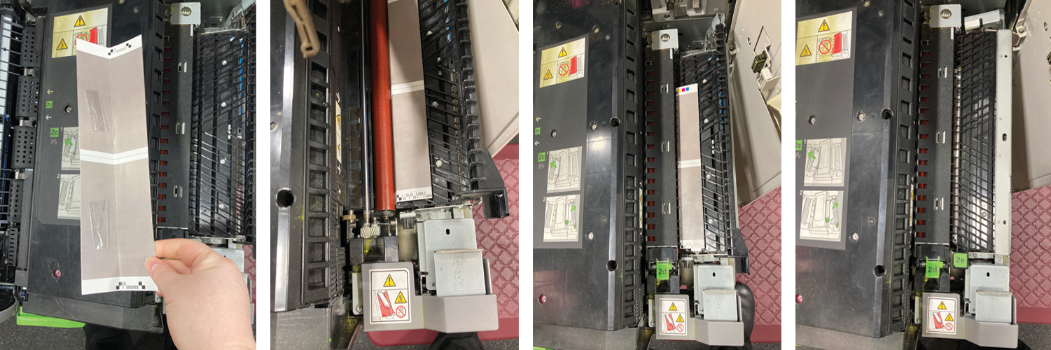

This fixed the wringle on the flap for us on the V2100. Needs to be cardstock. Or like someone else suggested, Teflon tape apparently works also.
