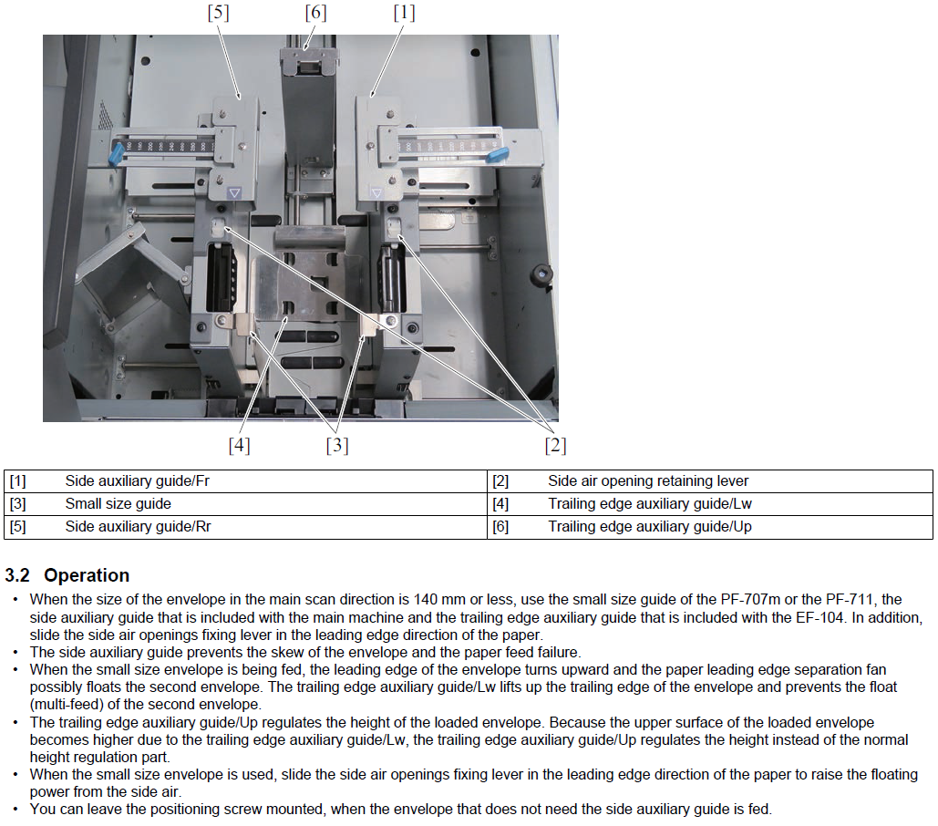

We regularly run #10 envelopes on our C7090 out of tray 3. In fact, we have tray 2 turned on as well (DIP Switch 71-1, set to 1) so we can load one drawer while it's running out of the other. We run them short edge first, and you need to use side-seam envelopes for best results. Make sure you open the small paper guides [3]. You should also install the side auxiliary guides [1,5] (see image below). That's all we ever do, however, the manual also suggests installing the trailing edge auxiliary guides [4,6], and change the side air opening retainer levers [2]. We never need to do those extra steps, but it might be worth trying since you're having issues.
If we get the occasional batch of envelopes that won't feed, we will rotate them 180°.
