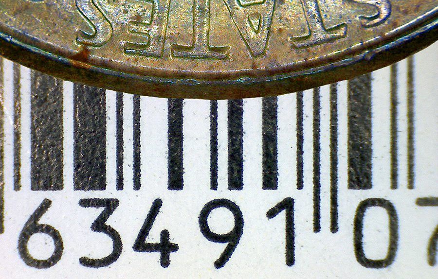

Attached is a close-up photo of a press sheet (with a US 1 cent coin for scale). The press sheet has small speckles of the 4 process colors printing in the non-image area. I've seen this from time to time in other press sheets and was wondering what the cause might be.
It is not one of my jobs but it is sheetfed offset.
Click on the image to make it bigger. Is this tinting/toning?

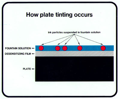

Tinting (also called toning) on the other hand, is caused by contamination of the fountain solution by either ink, or some coloring matter from the ink. Since fountain solution is all over the non image area, any coloration will be likewise.
