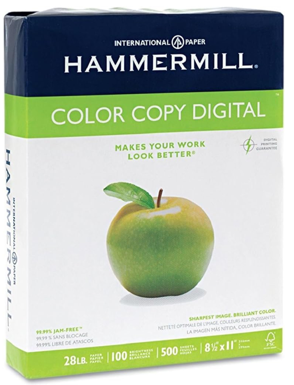

Hammermill makes a number of various different weights and sizes of 100 brightness digital copy paper. I’ve been using it for my printer at home for years and have never noticed it to have any noticeable hue, one way or the other.

Gordo nailed it. (y) I never rely on the expressed Brightness of a stock. I like to have a visual look at the Whiteness of a sheet. I like Navigator in general. Their Soporset brand in particular. BUT, for calibrating the Canon color toner printers, we always used Hammermill Color Copy.
