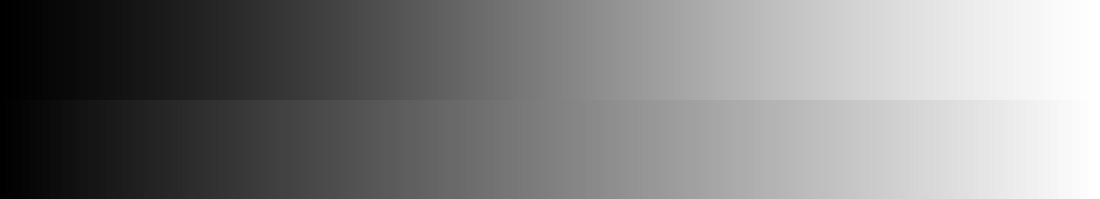

I think the answer (here comes Mr Speculation) is that humans do not see linearly. Instead we see logarithmically and the tone reproduction resulting from dot gain aligns with that - which is why your linear presswork looked horrible.
Here's an example...
Here are two gradients:
Which gradient has the appearance of an even distribution of tones? The top one or the bottom one?
No peeking!
I think most people would say that the top gradient has the appearance of an even distribution of tones. Yes?

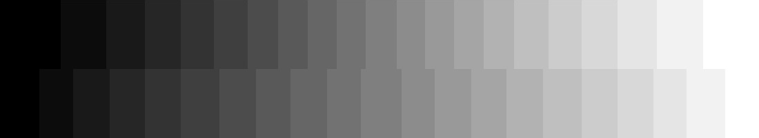

Now, here are the same two gradients but now they have been "Posterized" into 21 steps to clarify the distribution of tone values. Stepwedged.jpg
The top gradient had a logarithmic distribution of tones - i.e. how we see relative tone values - so it has the appearance of an even distribution of tones in the unposterized version.
The bottom gradient had a linear distribution of tones i.e. 5% increments. But, as a gradient it appeared to have a lot of midtones relative to the shadow an highlight tones. Hence, as a gradient, it looked flat, lacking in contrast, and horrible relative to the logarithmic gradient.
So, I don't think the real answer is that printing process are configured to match the dot gain we used to have before CTP - although there's truth to that. I think that the real reason is that, intuitively, the presswork that has the dot gain looks "right" because it better aligns the presswork to how we see than linear output.
Sidebar - the tone patches look scalloped - lighter on one side and darker on the other. These are "Mach Bands" (same Mach speed guy). This is your eye/brain's way of enhancing an image's apparent details in order to make up for our optical system's lack of resolution. It's not an optical illusion. It's a mechanism that's just exaggerated by this type of imagery.

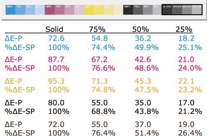

Maybe I can help.
If you do a Delta E2000 between 100% patch of color and paper.
And another Delta E 2000 between 50% and paper, the result is not proporcional.
∆E-P = Color Difference
sample compared to paper
