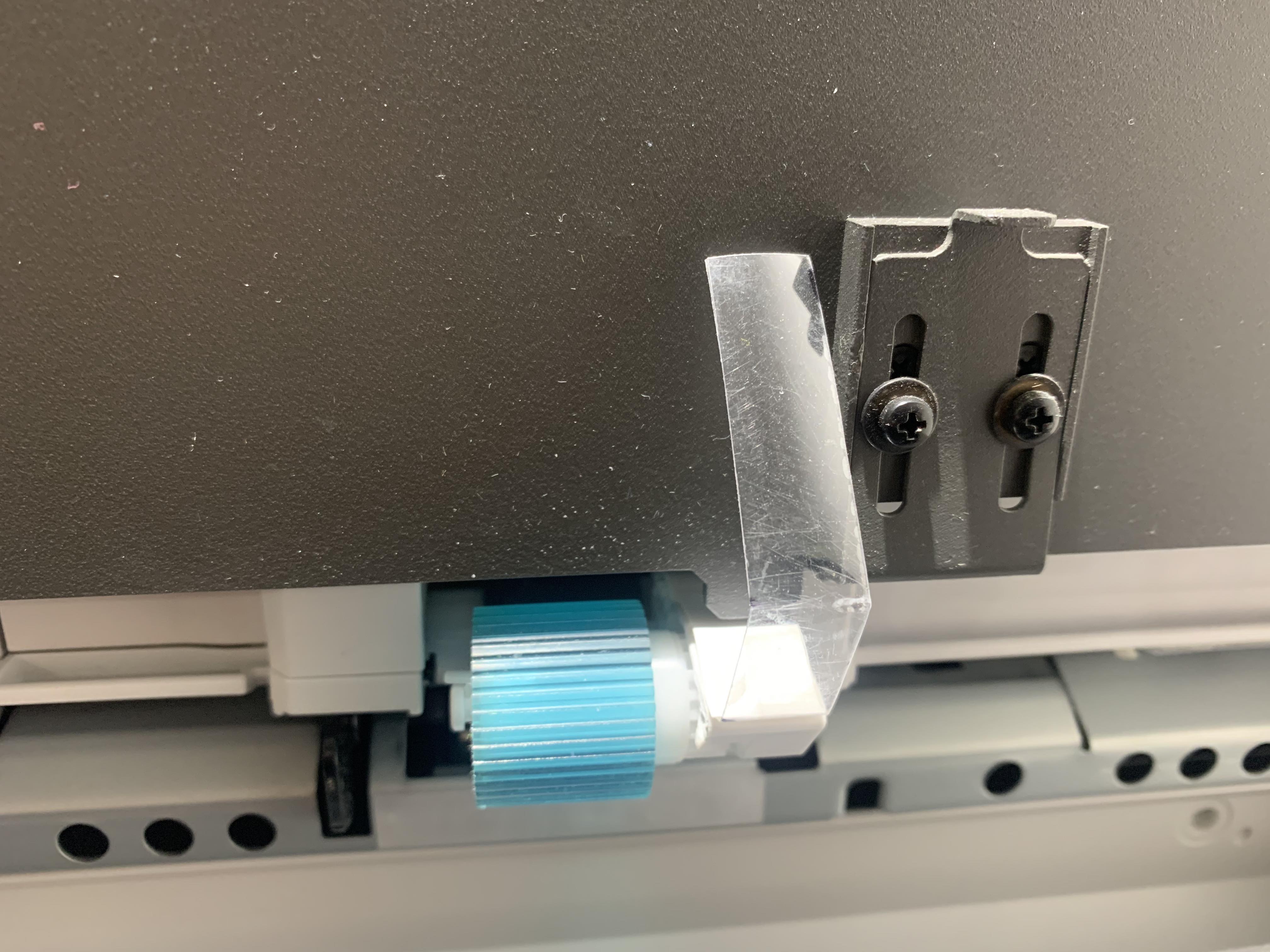

With that said, I got it up and running, and everything seemed to be working ok until yesterday, The feed roller for the envelopes doesn't move up and down. I cannot figure out why. I've tried to talk to Xante to no avail current;y. I'm waiting on a tech to get back to me.

After contacting Xante, they wanted me to buy a new bypass door for the low, low rate of $1700. Imagine my surprise and the choice words that came out of my mouth after that revelation.
After my heart rate returned to normal, I talked to my tech that we have for our Ricohs. He was gracious enough to find the service and parts manual for me, and even guided me along to find the broken part in the door. It wasn't easy and a one way bearing fell apart on me, but I found the broken part and was able to fix it for significantly less then $1700.

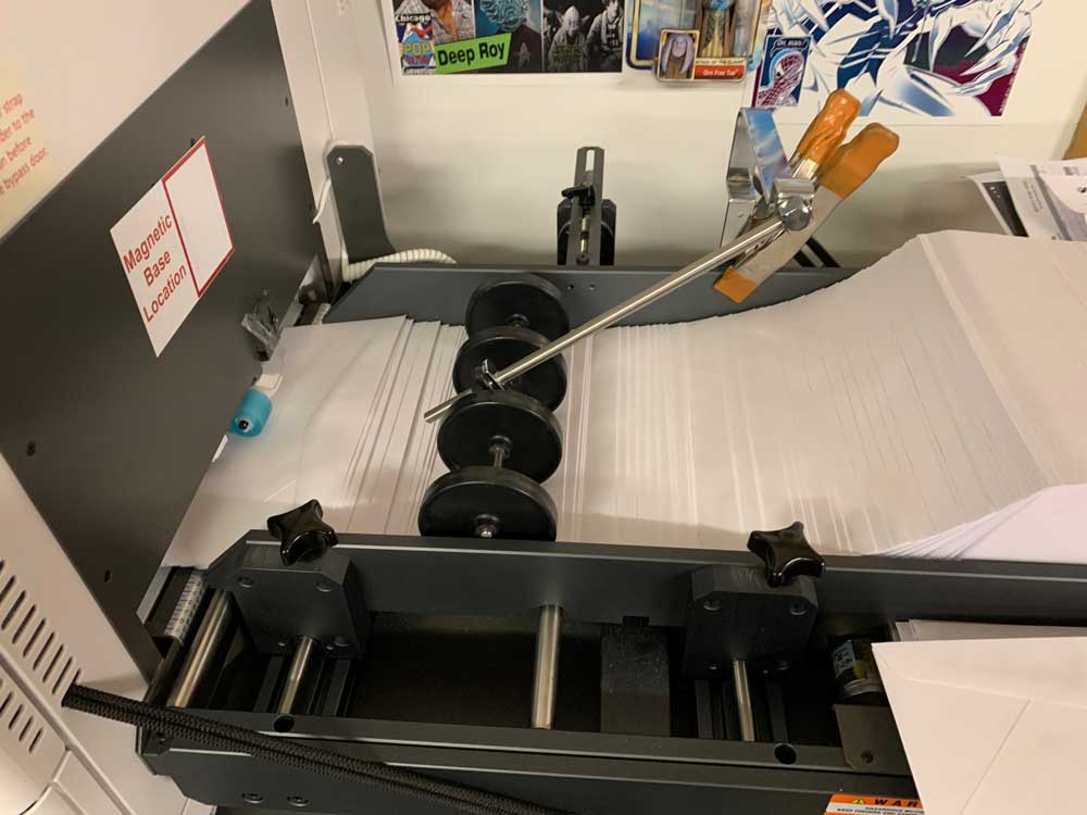

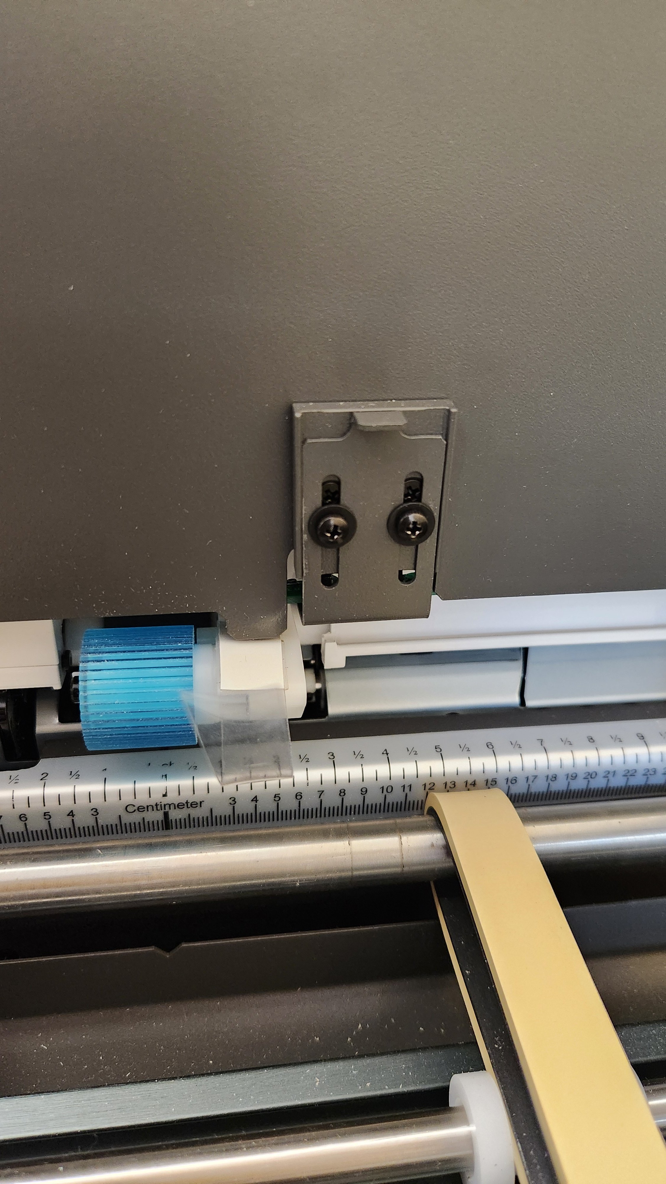

After that repair, I found my envelopes bunching up. So I grabbed a wrench and whatever patience that I had and adjusted the height of the feeder. Took a little bit of time, but it's much better then it was. I also use the exit tray roller with a giant clip to assist. Lastly, I did have to adjust the motor speed. Not perfect, but it's about where our Impressia was.

Can you provide any info on what you had to fix to make the feed roller move up and down? Mine went down today and I am trying to find info on repairs: You mention: "talked to my tech that we have for our Ricohs. He was gracious enough to find the service and parts manual for me, and even guided me along to find the broken part in the door. It wasn't easy and a one way bearing fell apart on me, but I found the broken part and was able to fix it"

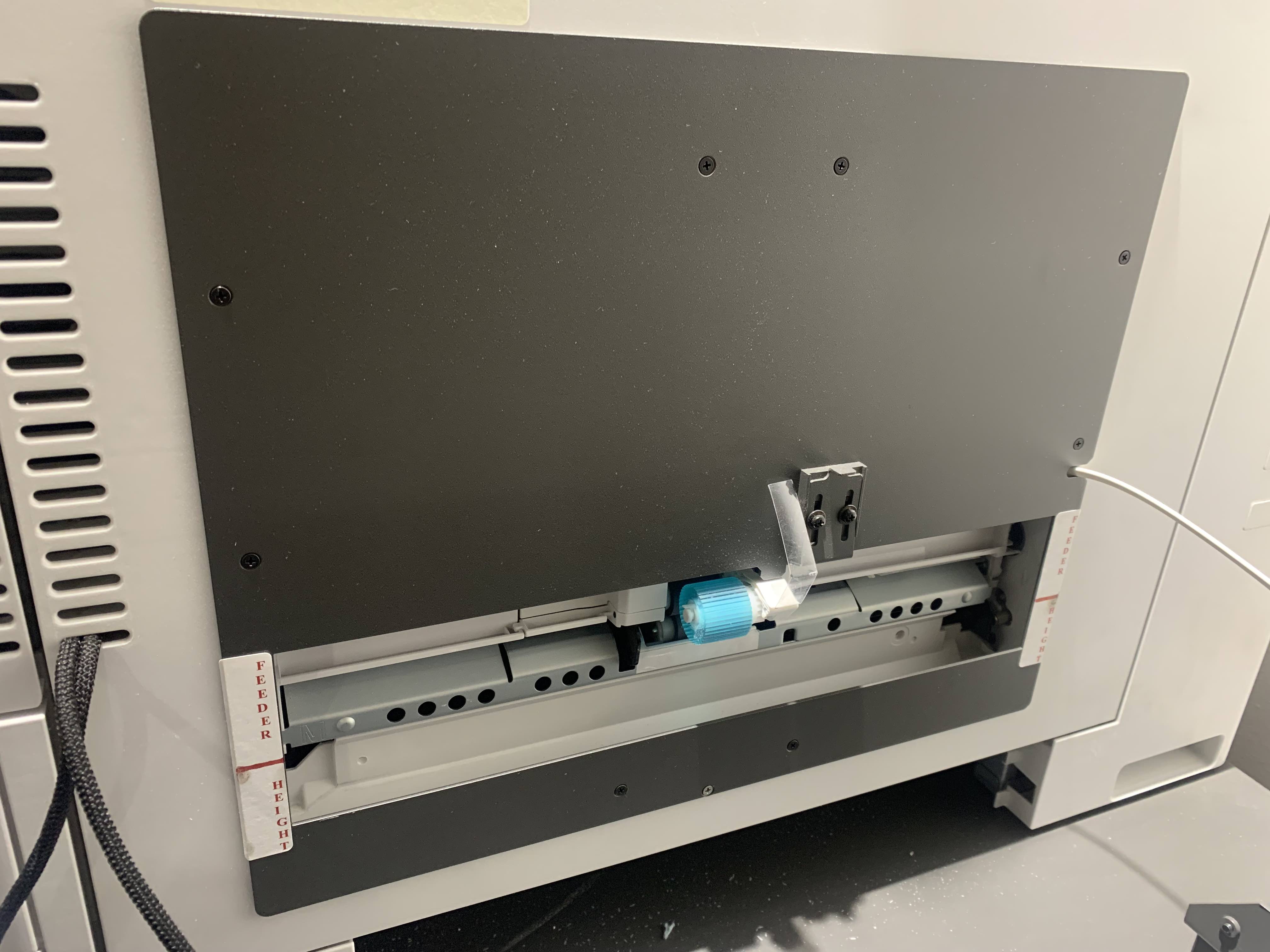

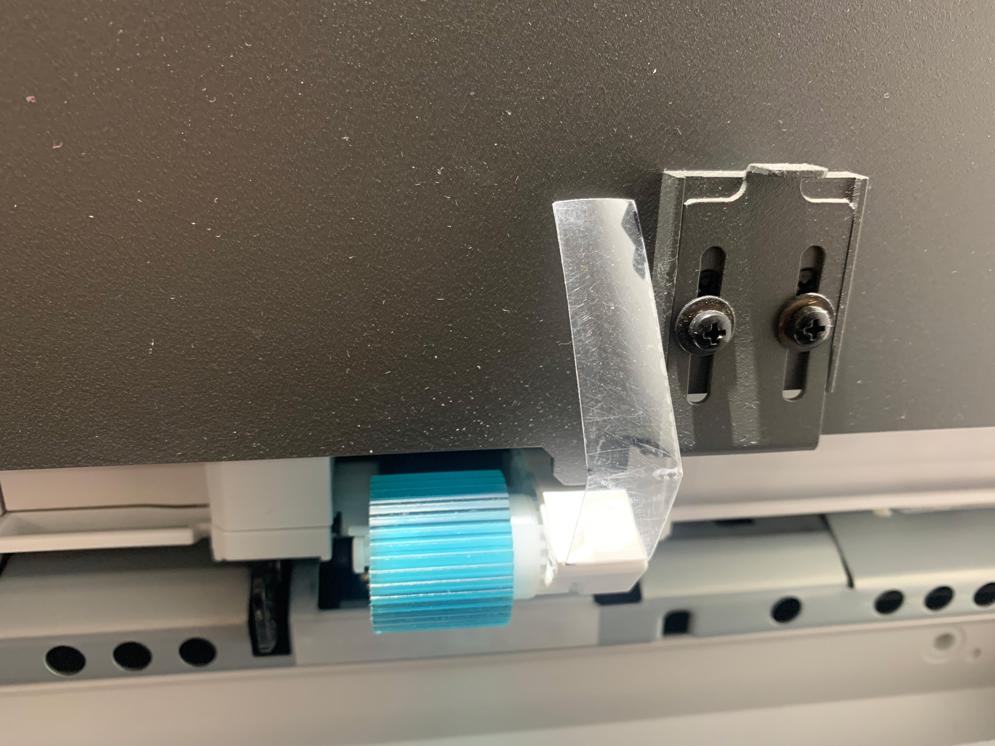

The height of the envelope feed roller can be an important setting. Way back when Lee Weaver still worked for Xante - I'm convinced he was the only tech who actually knew anything about the design of the machine, he had me mark a line along side the rollers with a sharpie and then move it up and down the slightest amount til the results were good. Here is a document I saved from setting the feeder belts, use a USB cable to the feeder to do this through iQueue. Hope this helps someone out there.

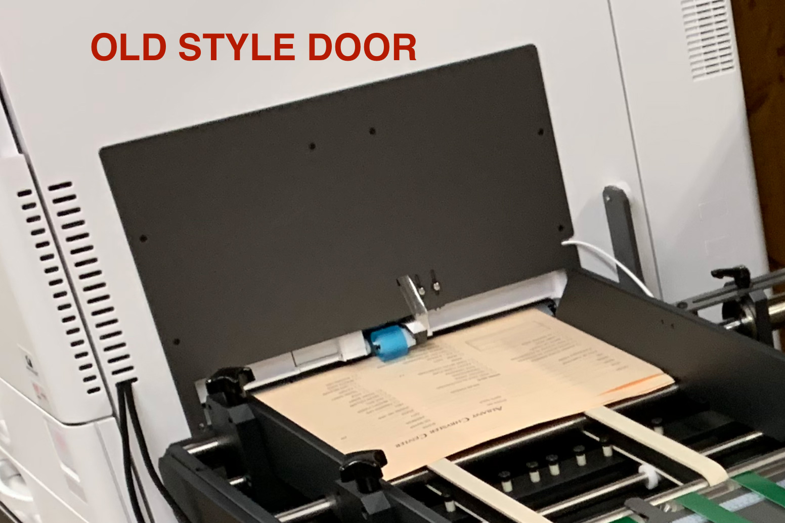

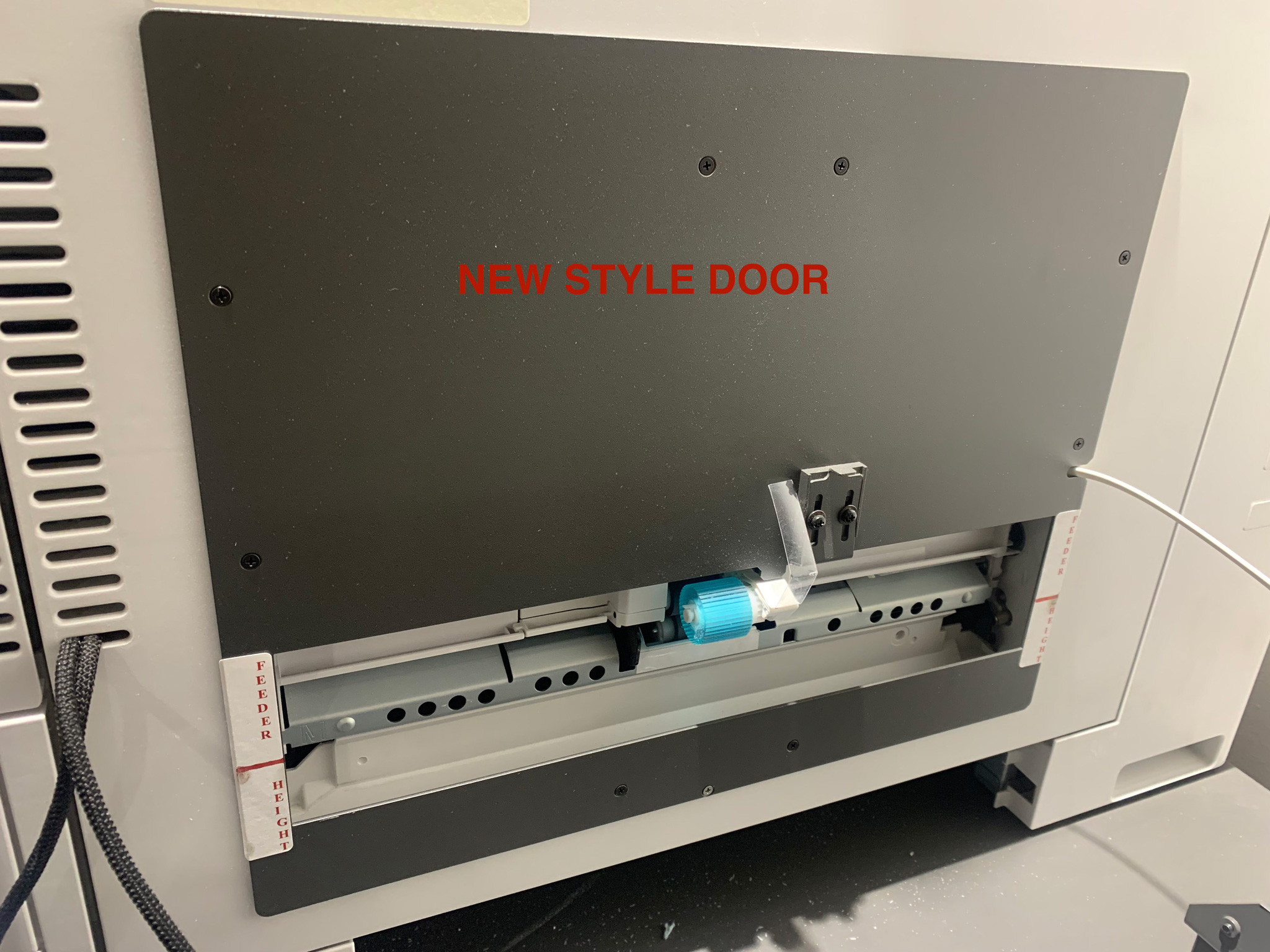

Also they did make a new style door for feeding envelopes. The attached picture is the newer style door. They replaced mine when I had to send the machine in for servicing.

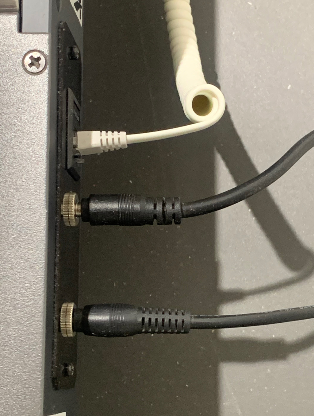

On the back side of the conveyor are two identical to the eye plugs, try exchanging those and observe the behavior. They are specific to the exit conveyor or feeder connection.

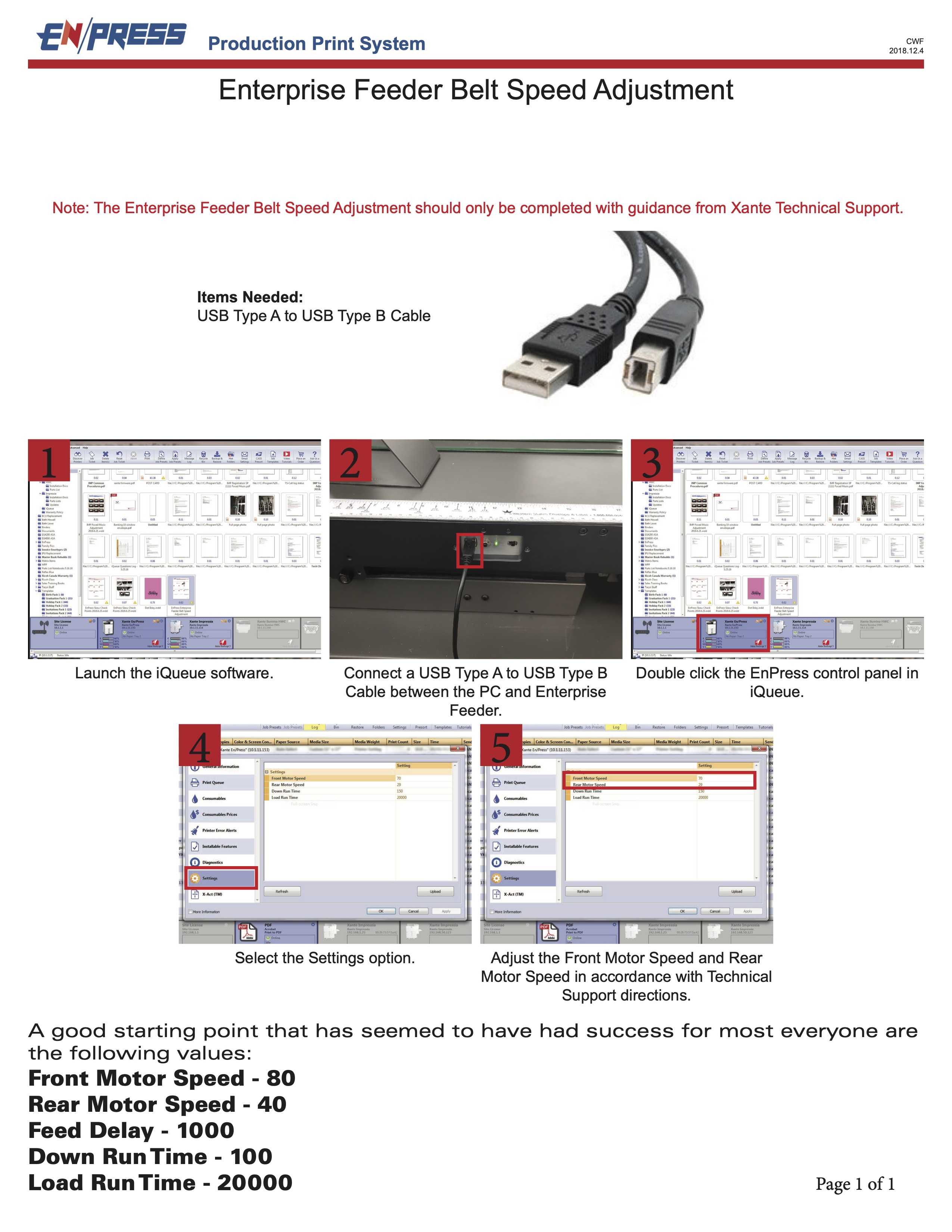

Have you connected a USB cable to the iQueue Software on your windows computer? I have attached a sample of settings for the belt speeds.

I have switched the wires around that did nothing. I started with the settings you sent me because I saw them in this thread and tried that last week and there was no luck. I don't understand what is going on. I am going to try emailing them with the email you sent me. thank you for all your help. I hope tech support will figure this out and if they do I will post the result here so if someone else has this problem they will be able to remedy it.

"Turn the feeder off, hold the advance button down, turn the feeder back on.
The LED should blink a number of times which will indicate the new mode. It goes from 1 blink then increases by 1 until the highest mode is 6 and it cycles back to 1.
We want to try putting it in mode 4."
That did not fix my issue so I had to order a feeder repair kit so will see if that helps I will keep you all posted on what happens after the parts come in.

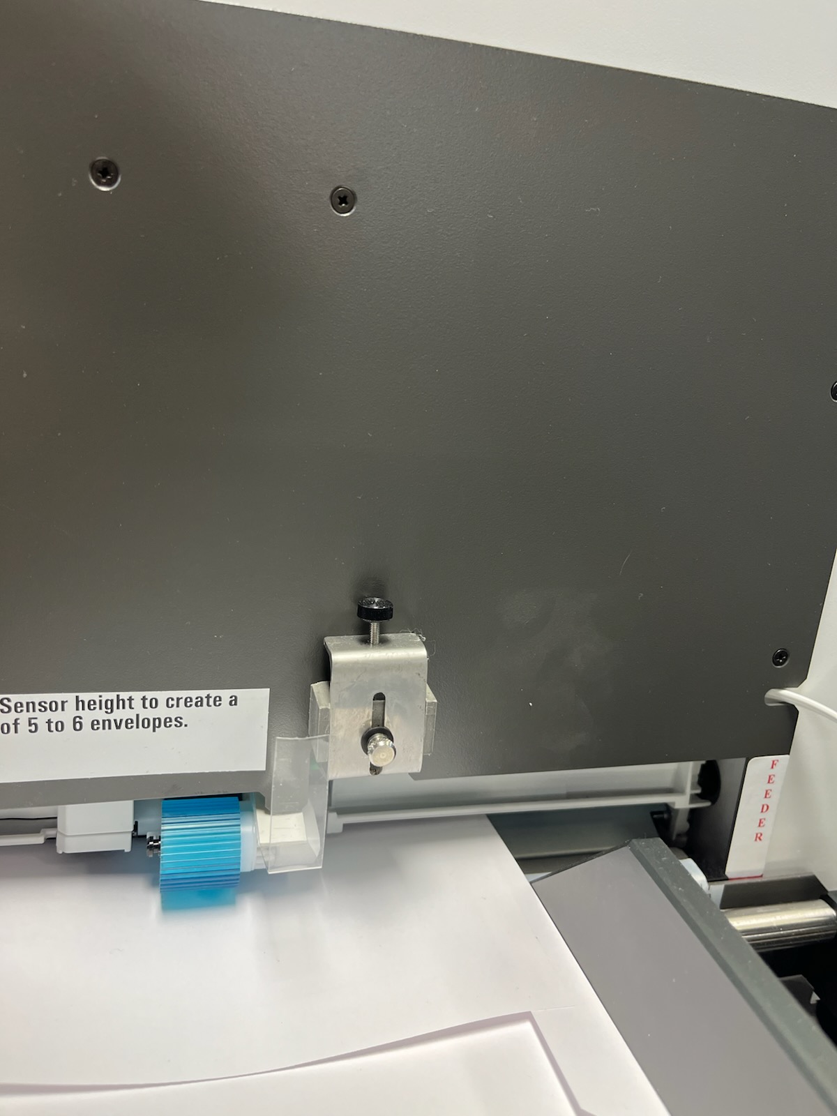

Has anyone in this thread seen the feed sensor in the 2nd pic, with the single screw on the front and top? I know someone who just took delivery of that unit and had great luck with adjusting that sensor. Xante has told me it is an old sensor. I have found documentation for the double screw sensor going back to 2019. I have a hard time believing his new EnPress sat since before 2019 to still have an old sensor.
Thank you so much for the tip on the belt speed adjustment. The box of parts had the USB cable, ya think they should have told me what it was for? Night and day difference!
