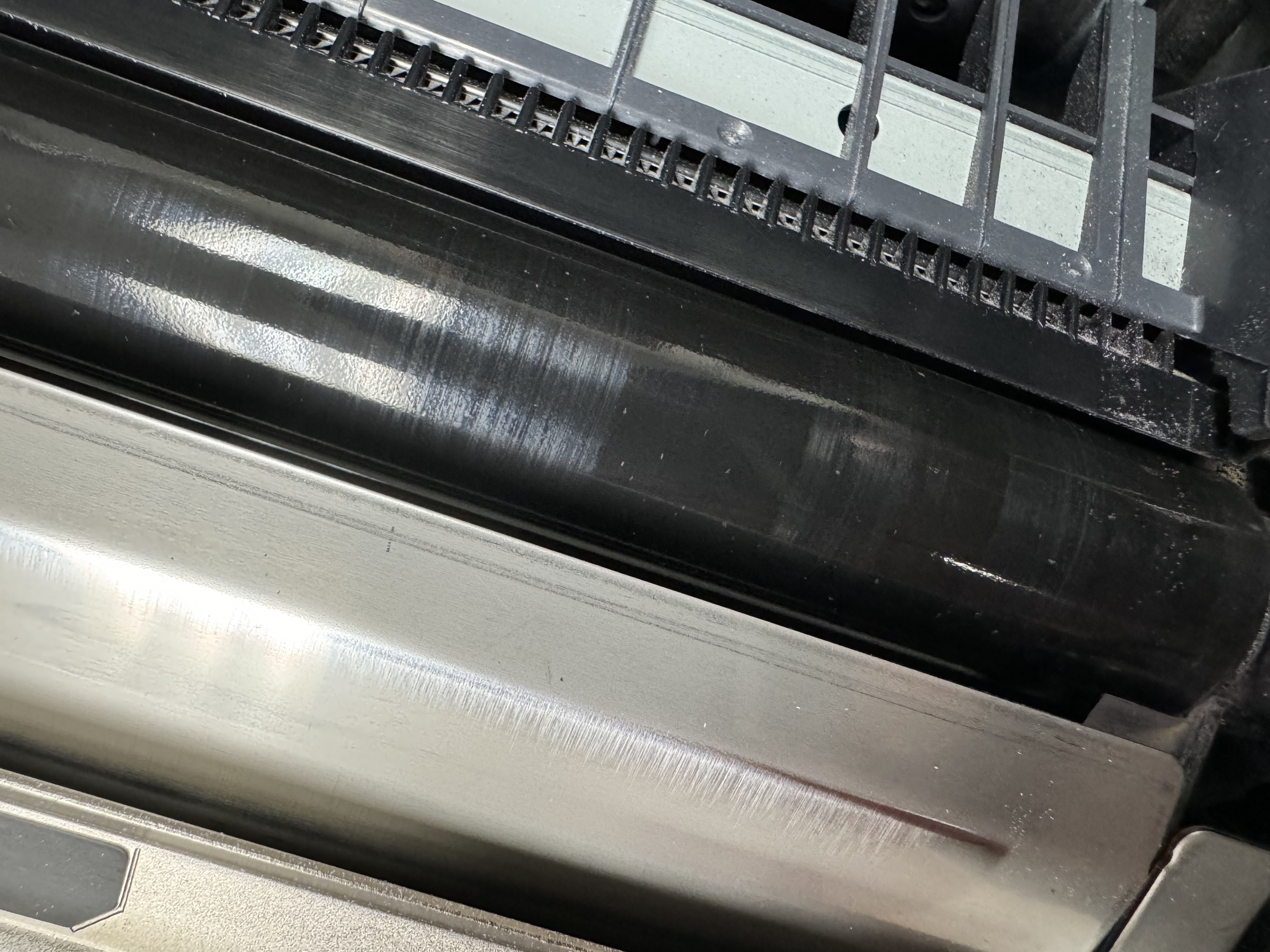

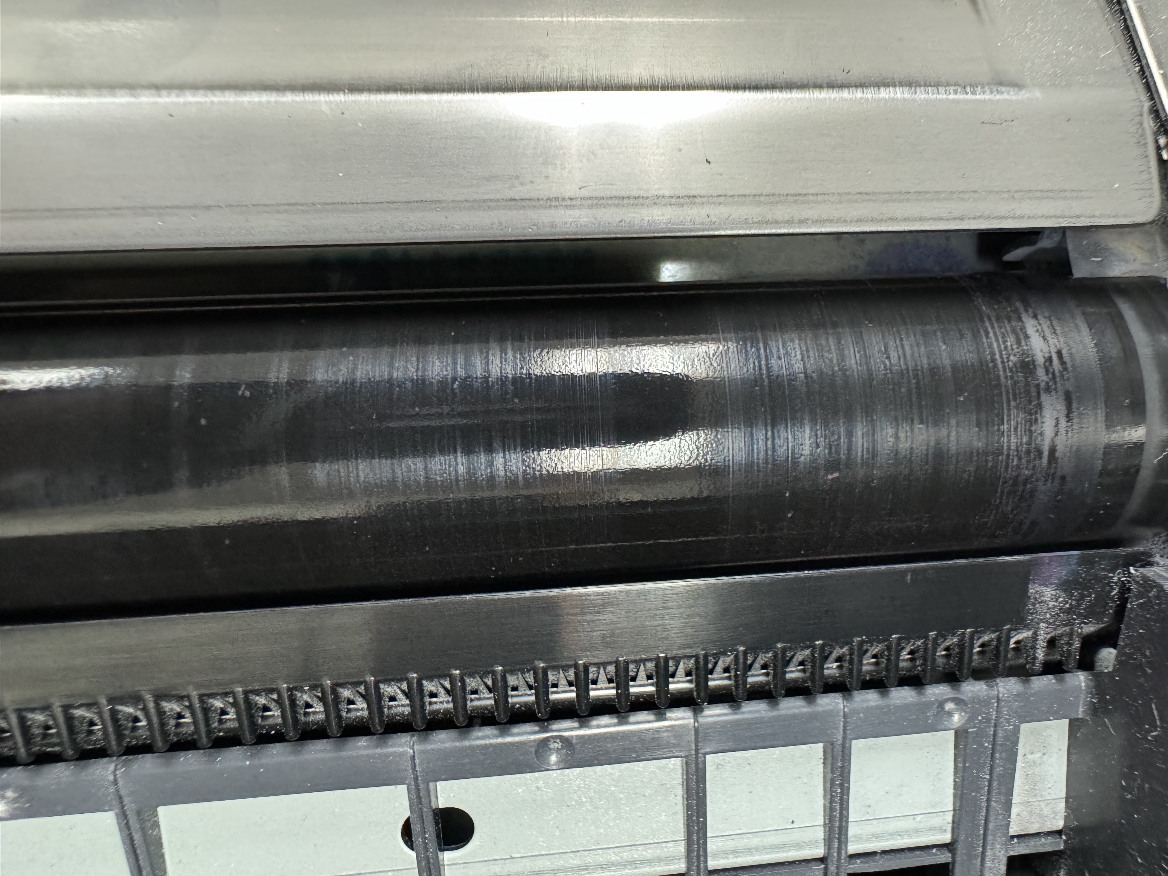

Is anyone else in the UK struggling to obtain 2nd BTR for their Versant 280? I ordered one a week and half ago and still not turned up. It's marking like mad now and at a complete stop :(

Replacing another btr this morning and something dawned on me, I've lost count of how many i've changed over the years of having our versant 80 but I realised they ALL fail with visual wear and marking on the non operator side? I don't think I've ever had one with marking on the operator side? Looking back at the couple I have on site they all have wear covering approx 3-4 inches from the non operator side, the rest of the roller looks perfect and this has always been the case.
Anyone else experienced the same wear/marking pattern or have a possible reason?
I mean the failure is suppose to be coated paper destroying the roller so why only one side every time?
Yes, same here. I’ve asked about this and got no answer. For the most part 90% of the roller looks like it’s brand new but once the end of the roller starts to mark the sheets it’s almost useless. I keep them around and will put them back in when running envelopes to get some more life out of them. I’ve given up that there will ever be a solution, it’s too bad because I do like the 280. At least now I have a spare on the shelf and don’t have any down time.
So i'm not the only one. I think it might be something to do with toner dropping down through the back of the machine. I wouldn't call it excess but there's always bits of toner about.
I find sometimes the BTR isn't marking the back of the sheets but I get a very light ripples in solids on the sheets (light lines 1mm apart). Like a gear is causing a constant vibration. Replacing the 2nd btr fixes it, this is where I initially thought toner was causing an issue on that side by falling on the exposed gears.

That's the exact failure we see as well. For the first time I actually had an engineer try and blame the paper that I was using. He said that the btr problems were all resolved and if I used xerox paper then all my problems would go away. I just laughed at him and carried on with my day! Konica are currently running the numbers on leases for a 4070 with all the trimmings so it looks like I might be moving from xerox
That is funny! He's right in an odd way, if you only use Xerox paper the problem will go away, at least in the USA Xerox no longer has any coated paper under their brand. So yes, the problem goes away because you're not using any coated paper.
I too notice more toner on that same side and thought the same thing but have no clue how to find out if it means anything.
