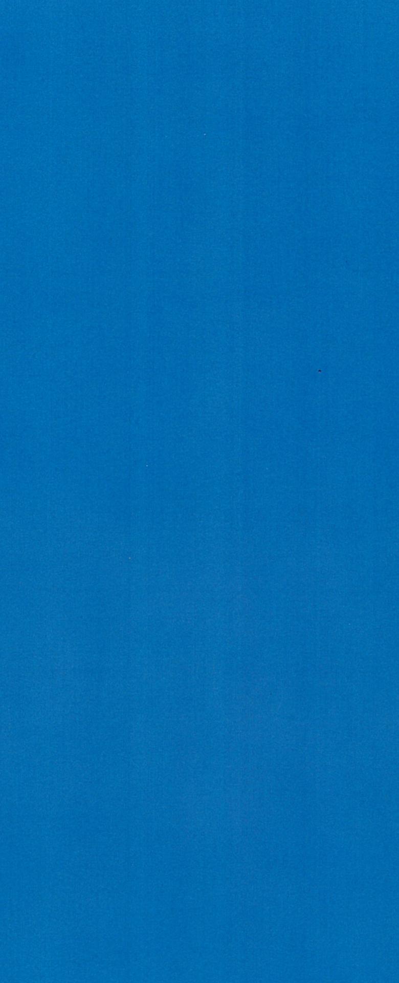

Hello, i own a Xerox 560 got it new never used and now i noticed that kind of gradient like on solid colors especially on heavy paper (300gsm), i can't figure out where it comes from, i thought maybe the drums but they'r still a 65% so any help would be welcome.
Thanks for all th info, i tried "image transfer settings" which fixed a little the black color on a full A3 sheet. i also noticed some "bands" on the paper from feeding edge to the end, it's not toner its more like a pressure on the paper, i am still waiting for a tech to come by and do a check.
On the 550 you'll have a PC app you can install to use the Density Uniformity Adjustment tool. Its on a SIQA cd.
Here's a link for you:
http://tiny.cc/siqa_cd
Now know that you can run this tool over and over again. Only needed to do that once but in that specific case, I ran the tool five time on a terrible paper and it fixed it completely, getting better every time I ran the tool. Most of the time one pass works for that difficult stock.
The Image Transfer Settings you refer to is for when, for example, your reflex blue becomes mottle on thicker stock: the machine needs to 'pull' harder via the electric field to gather enough toner on the sheet. On the 550/C60 platform this is done on a paper range basis (aka Coated 3B for example). On the Versant its on a per stock basis which is much nicer.
Your Xerox support should be able to assist you with this.
Cheers and good luck
Hi Shaare thanks very much for the answer, problem is i tried SIQA and it says that my machine is not supported i own a Colour 560 not a C60. Also thanks for clarifying the Image Transfer option, i don't know if those older models have some way of configuring the densitiy uniformity on the machine itself like the alignement and registration. Still waiting on that tech to spare some time for me.
