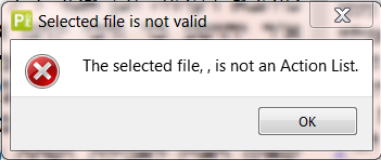

Thank you for that, BUT
my Pitstop Pro 13 Action list panel gives me the following error when I try importing both of your Action lists

In Windows 7, I downloaded the archive, went to my Action List panel, tried importing it by navigating to "C:\Users\Schmaltzkop\Downloads\Archive (3).zip," and got that error...

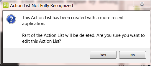

Ah yes, I did not realise that I was using a feature that was specific to 2017…

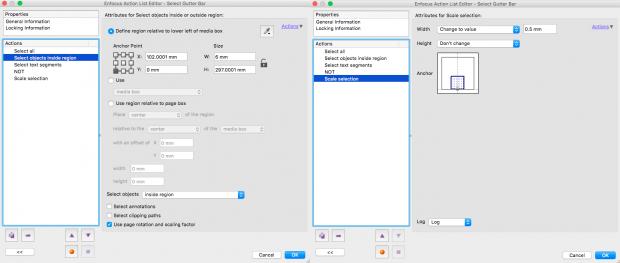

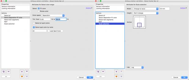

Here are screenshots of my two files, is it the resize step? Offhand the other steps should not be specific to the new version (looks like I have to re-read the release notes).

Click image for larger version  Name:	eal1.png Views:	1 Size:	18.8 KB ID:	265161
Click image for larger version  Name:	eal2.png Views:	1 Size:	15.1 KB ID:	265162

Scale Selection is a new PitStop 2017 Action, so it won't work in older versions.
