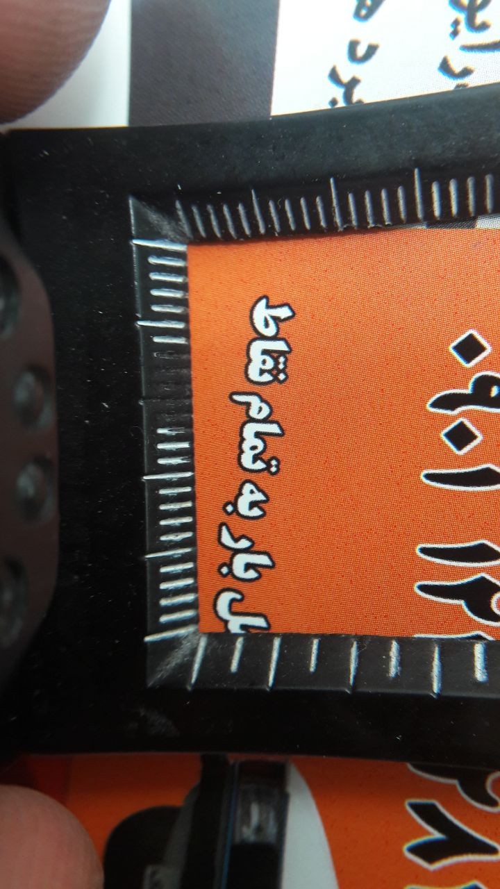

Hi wyagow I'm still having the last issues and just looking if u could help, just have a look at the pic I've post and let me know what u think about it

Yes it should have no influence on your printing. It's only function is for washup. On my press the stripe should be 4mm in the center and 3mm on the ends. This is the stripe to the ink form roller (blanket). You can double check your intermediate roller stripe to dampening form roller. It should be 3.5mm. But your picture almost makes me think your ink form may not be making contact with the plate cylinder on that end. Check that stripe and if you could take a picture to show me the stripe. Or you have some dampening rollers settings not set correctly too. Also if you could take a picture of your entire press so I could see what kind it is would be helpful.

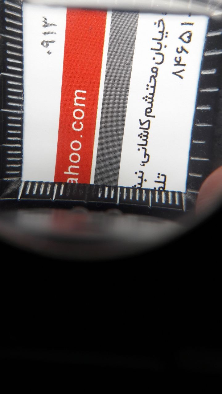

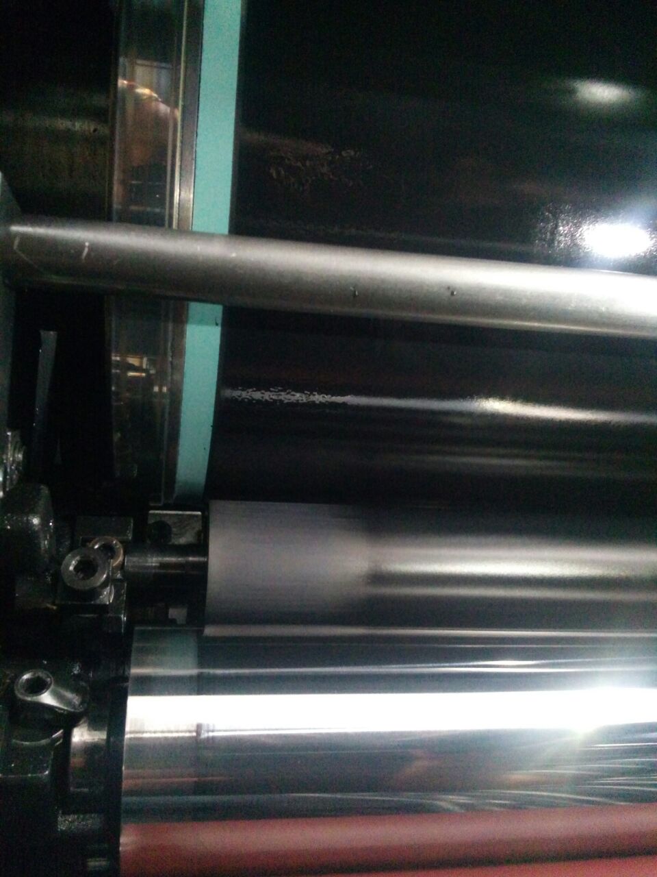

Here are the pictures

moha,
I suggest you LOOK at the Image Areas on the plates through a Loupe before they go on the Press !!!
Are these so called "Dots" already there ? if so then you have Badly Imaged Plates !!!!!!!!!!!
Regards, Alois
