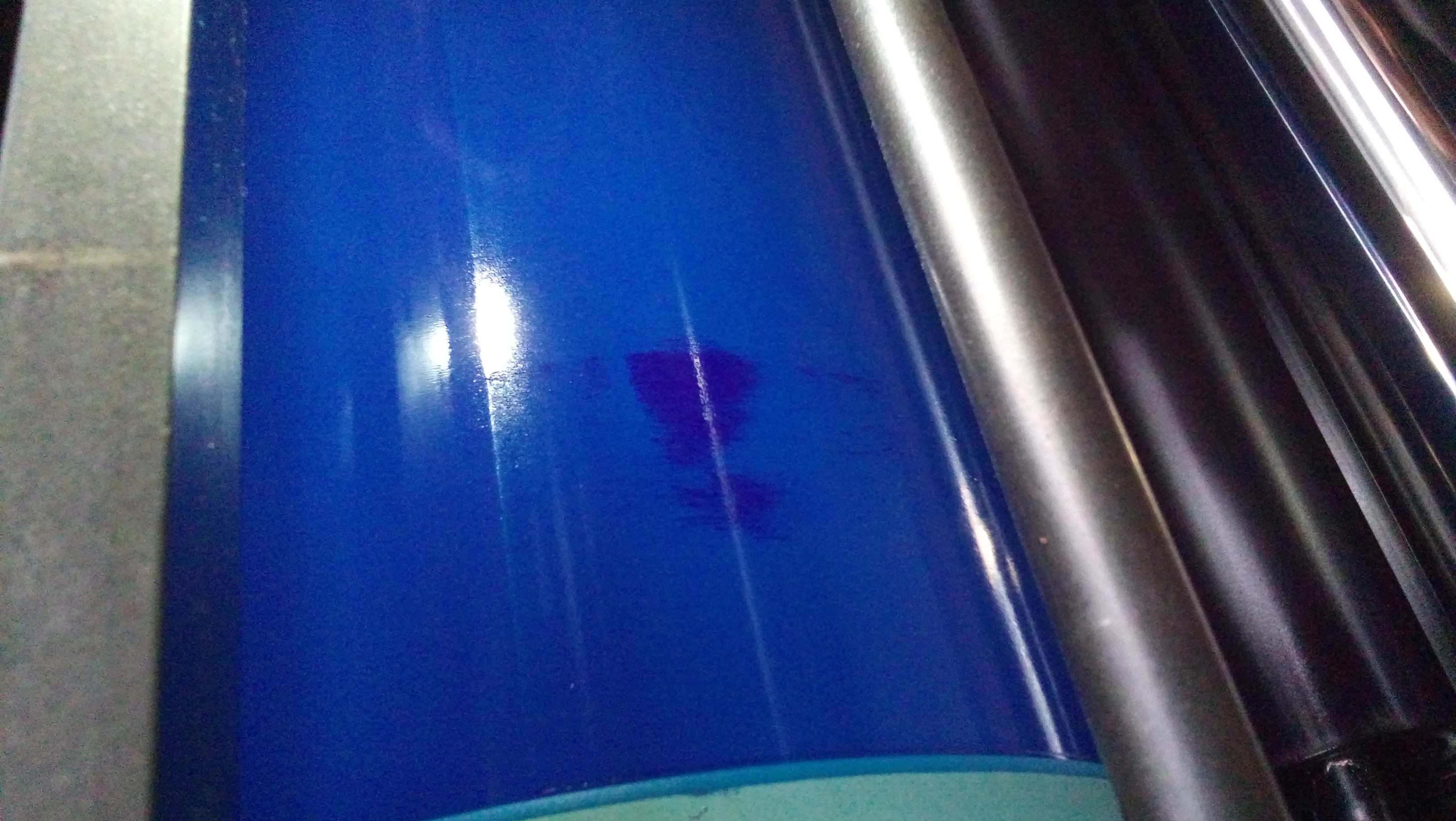

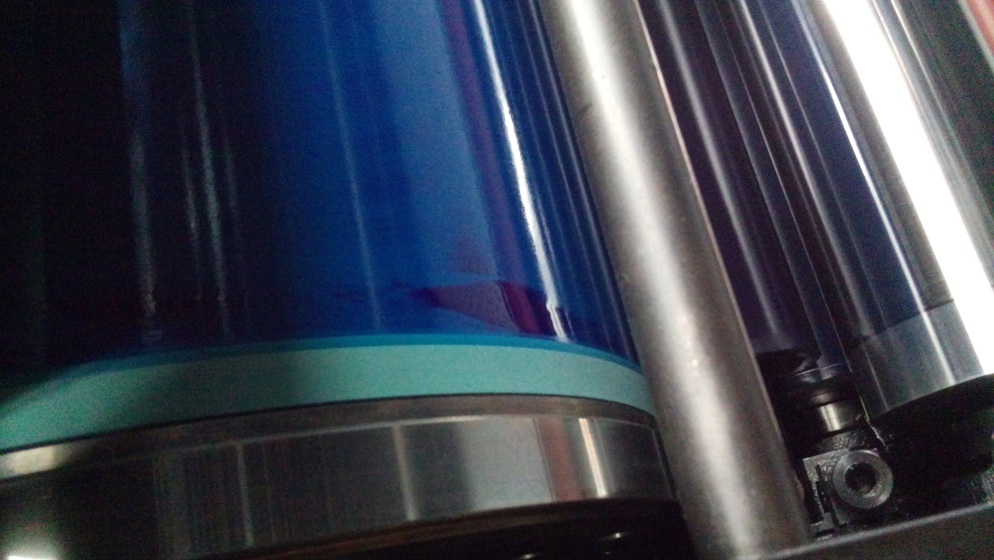

Hi everyone, i had the following issues on an anicolor press, sometimes when we print there's a thick layer of ink at about 20 cm on the operator side, it's not all the time, it happen usually when we change job or make a change plate, at the beginning we thought it was dampening issues, we made a check of our setting and everything is fine, our dampening rollers unit are good, our ink chamber are ok, we even change our ink form roller blanket but sometimes we still have the following issues. Can somebody have an idea of what can it be, can it be the pneumatic pressure.

Without seeing pictures my guess is ink water balance. Its critical on my press that the stripe from chrome metering roller to water form is set correctly according to manual. Try checking chrome to water form with the water drained from water pan to avoid possible misreads. Also water form to plate. If these roller stripes are out of sorts so to speak you may encounter emulsification. It happened to me on the operator side yellow unit once. I reset rollers numerous times till I finally figured out what was wrong. I would double check them. Send pics if possible.

Could also be ink chamber blade not seated firmly down and square, straight. If you get one of these things in crooked even just a little bit you will have ink issues similiar to your problem. Check your stripes from anilox roller to ink form and ink form to plate cylinder. Make sure these are set to specs. I have had to have Heildelberg reset these bearer settings on 2 units.

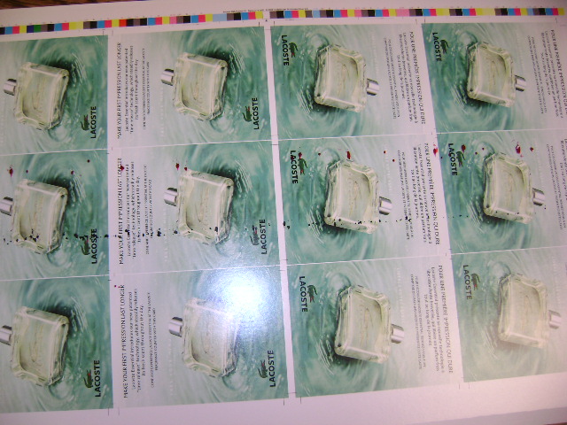

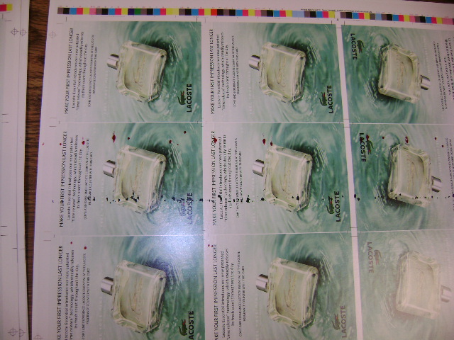

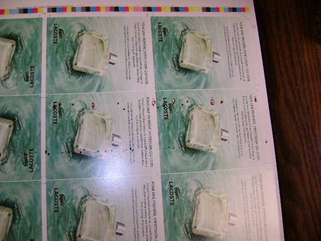

No Title
Hi everyone, had another kind of issues on my press, have anyone sees there before? The just put a clean inkchamber with fresh ink, our dampening rollers are well set, these issues appear regulary and we have it on at least 2 unit, it mostly on the cyan and magenta, can someone help

Good Morning,
I would refer to operators manual under Dampening system. In my manual it is B section 6 page 26 to 32. I use page 31 constantly and set my rollers exactly as it says on that page and in that exact order. I also set the rollers with the vario turned off. The section is called Removing, fitting and adjusting Anicolor Dampening rollers. I am almost certain this will correct your problem. I have been known to have to do this a couple times in a roll over a 2 day period just to make sure it is done correctly. Good Luck. Hope this helps.

wyagow
Yes I feel it is your dampening roller settings that is the problem. Drain all your water pans by turning off the Techno Trans system. Take all your dampening rollers out except water form roller. This is the roller that makes contact with the plate. I use a dab of yellow ink on the form roller and idle press a minute. Check stripe between form roller and dampening distrubutor, adjust and proceed to the next step on page 31 and so on.
