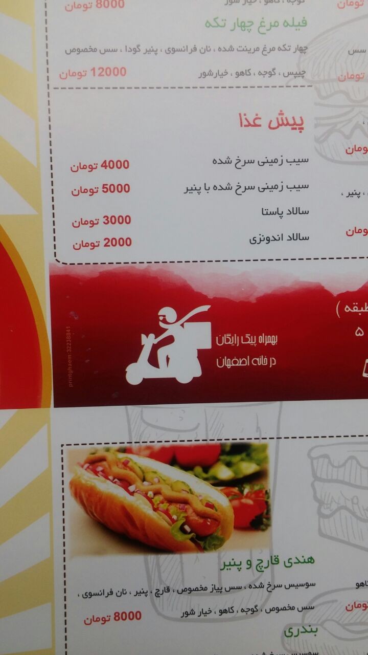

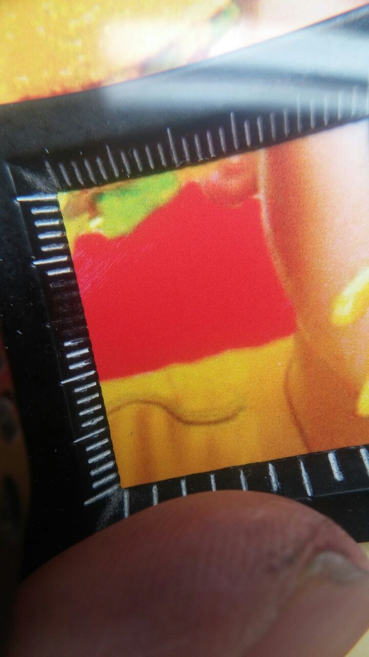

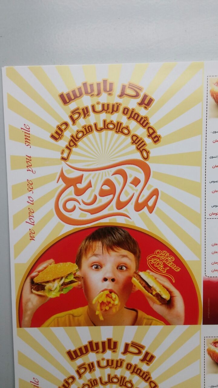

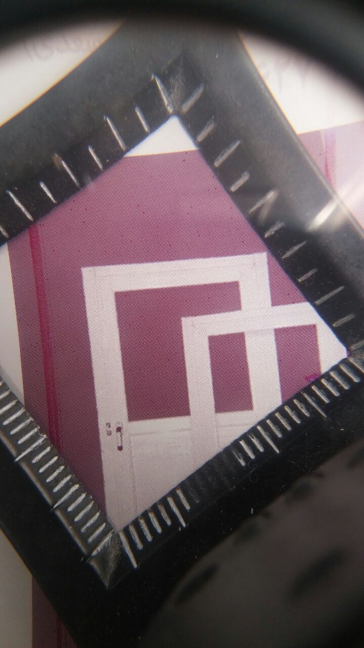

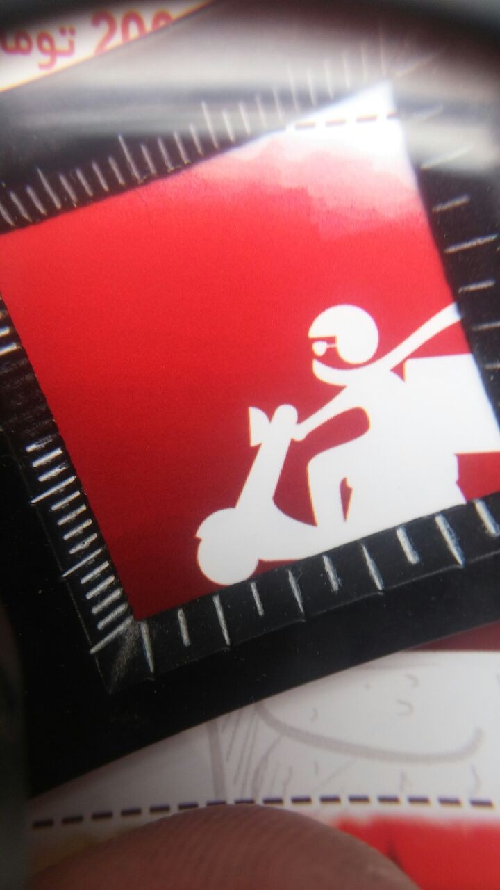

What about if fountain solution is not able to clean all surface of the plate and leave some part of the plate un cleaned. these dots are not something added to job these are dpis of the plate which has not been cleaned by the water rollers i think look at my pictures more carefuly one more time plz
One more point if i change my dpi format from Am to Fm these dots almost disappear but its hard to ask all my customers to do so because l dont have the platsetter of my own and fm format is not suitable for all jobs and challenging to print

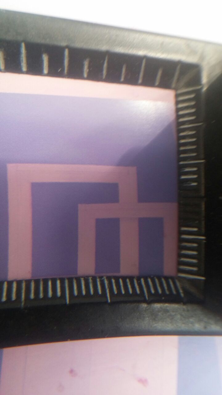

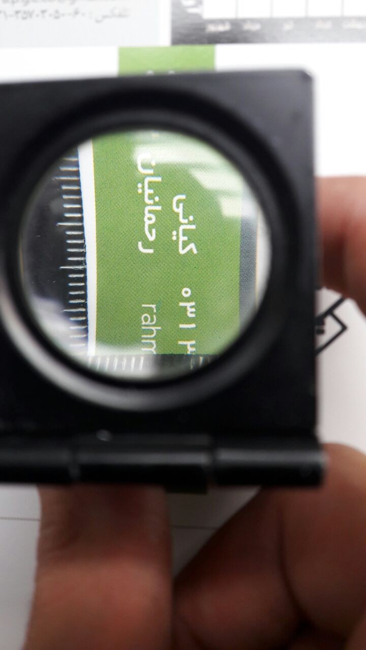

One more picture

This job is in Fm format as you can see on the pictures there isn't any dots

I'm not sure what you mean by fm and am. I know that we tried doing staccato screening on my press once and it caused similiar issues so we went back to original format. Some dot patterns are not compatible with anilox rollers because of the concept and screen angle on the roller itself. A part of me also wants to say that you should check your transfer jackets for ink buildup. These should be regularly cleaned as I'm sure you are aware of. Also have you tried adding alcohol to your system? You may already be using that though. What kind of press do you have? Could you take a picture of it?
I have a sm 52-4 anicolor/2008
its not related to transfer jackets

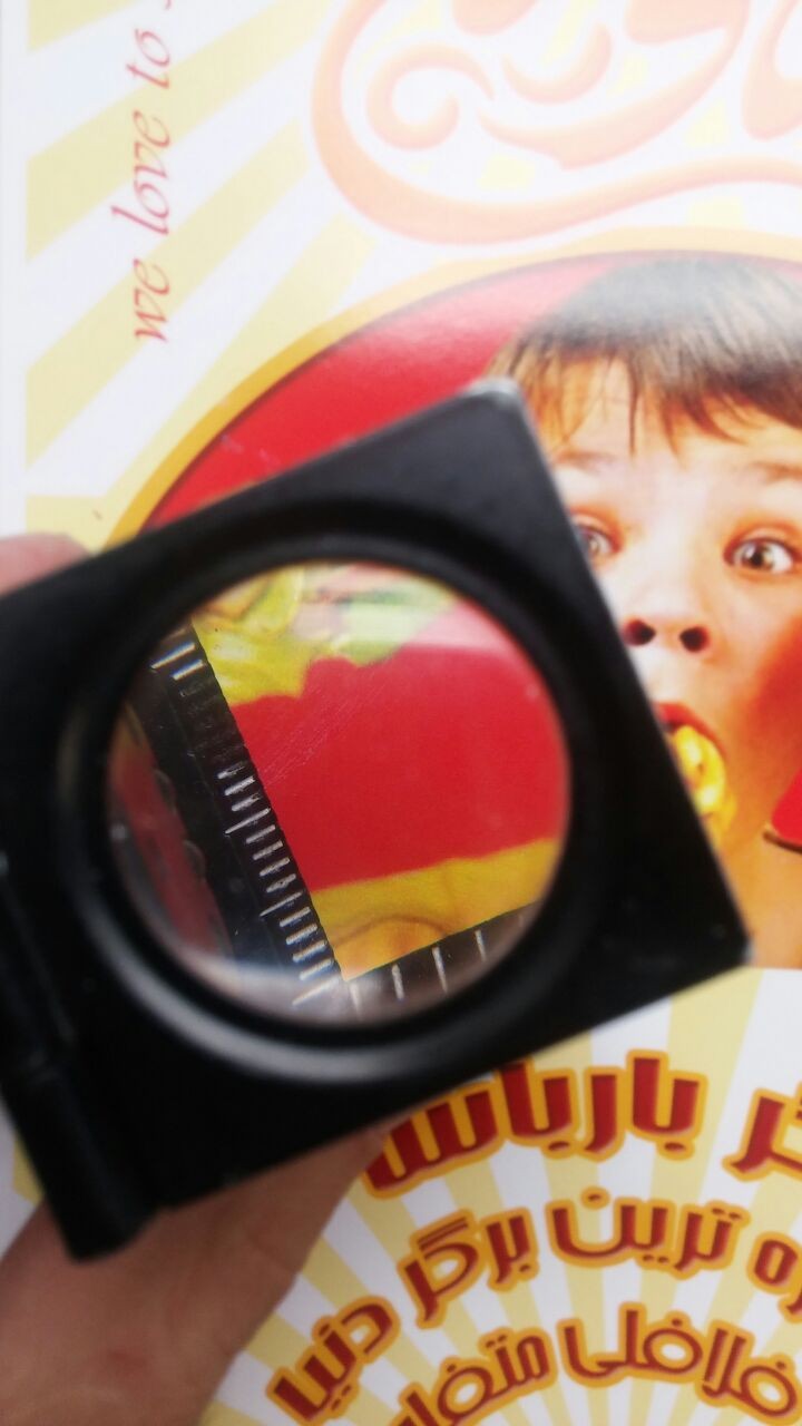

The plates are ok but there is sth wrong whit my press that i don't know what it is. these pictures may clear up the mystery...as you can see the plate dpis are ok but when i print my press is not able to apper all the dpis by thier correct shape

Hello moha,
Questions : L. H. image, is it a view of the Plate ?? R.H. image print view ? ?
Regards, Alois
PS we need to see views of the Plates/ Printed KCMY at a "Higher Magnification 20x or +++
not the 8x/10x of a normal Loupe !!!
The quality of pictures decrease here. What my pictures show is that the plates dpi are ok but when l put ink and water rollers on the plate the dots appear
