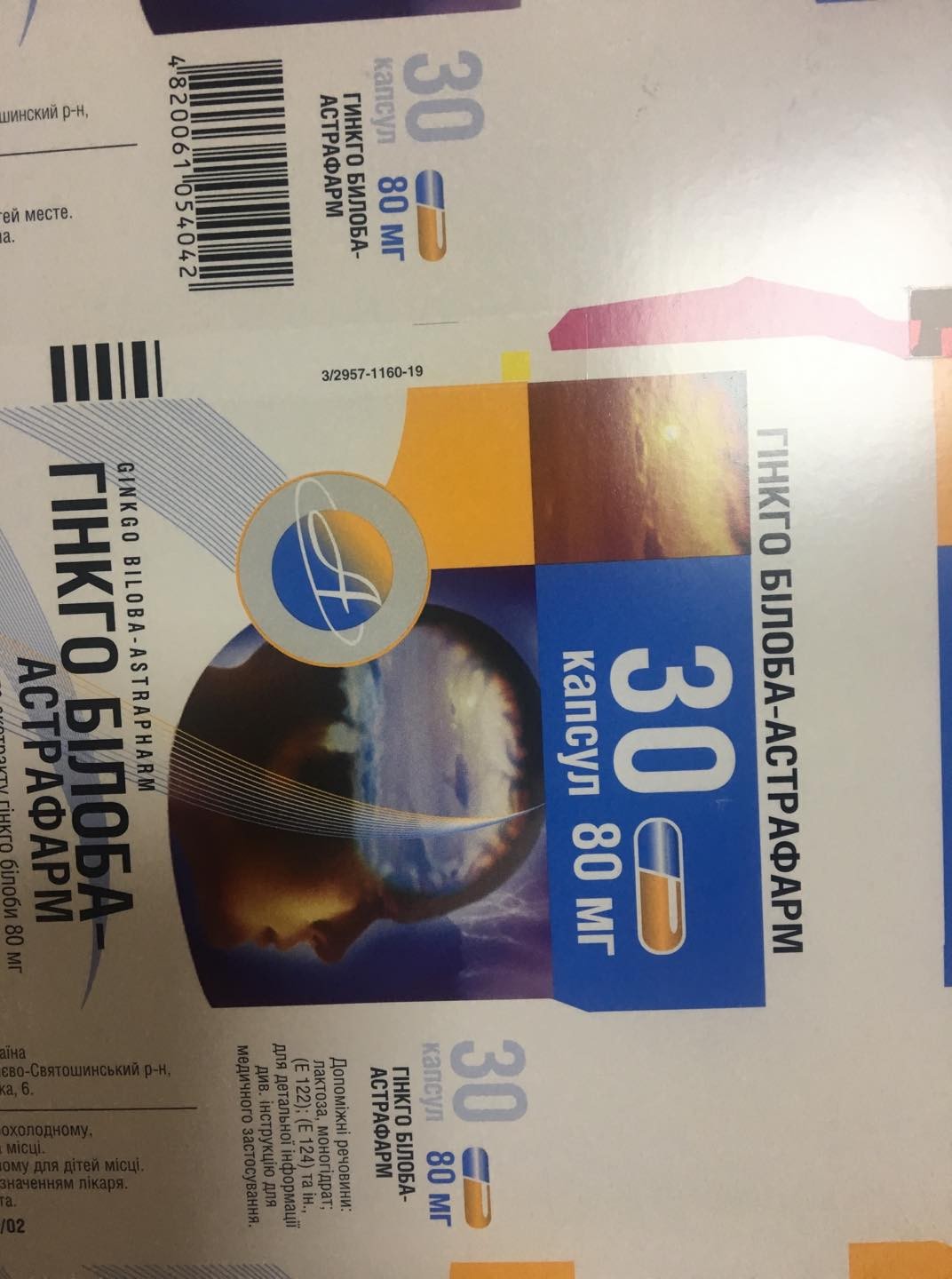

I can't make a photo today. Next week. But the naked eye is not visible, but the customer saw and complained to the director. Now they were given the task of getting rid of this effect. (Two photos. Reduced tacc with oil and without oil.)
p.s. Reduced tacc oil add 6%. dot field 10-90% is fine/

The problem looks like Paper Mottle, without changing anything on Press try printing different Paper Samples.
Next - hold a blank "Sheet of the Job Paper" up to the daylight and see if it looks cloudy view?

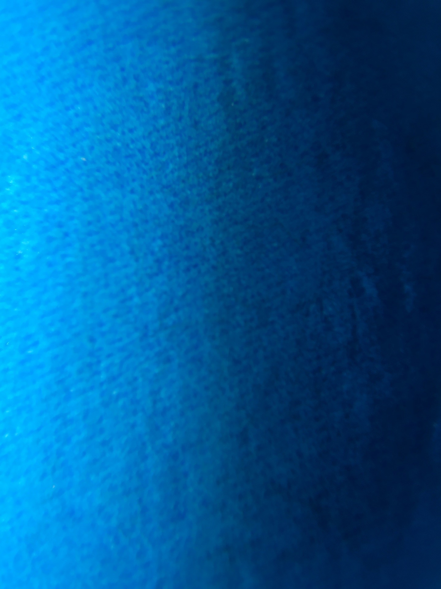

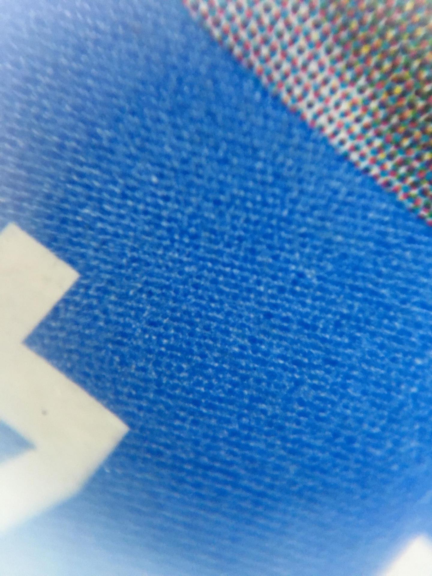

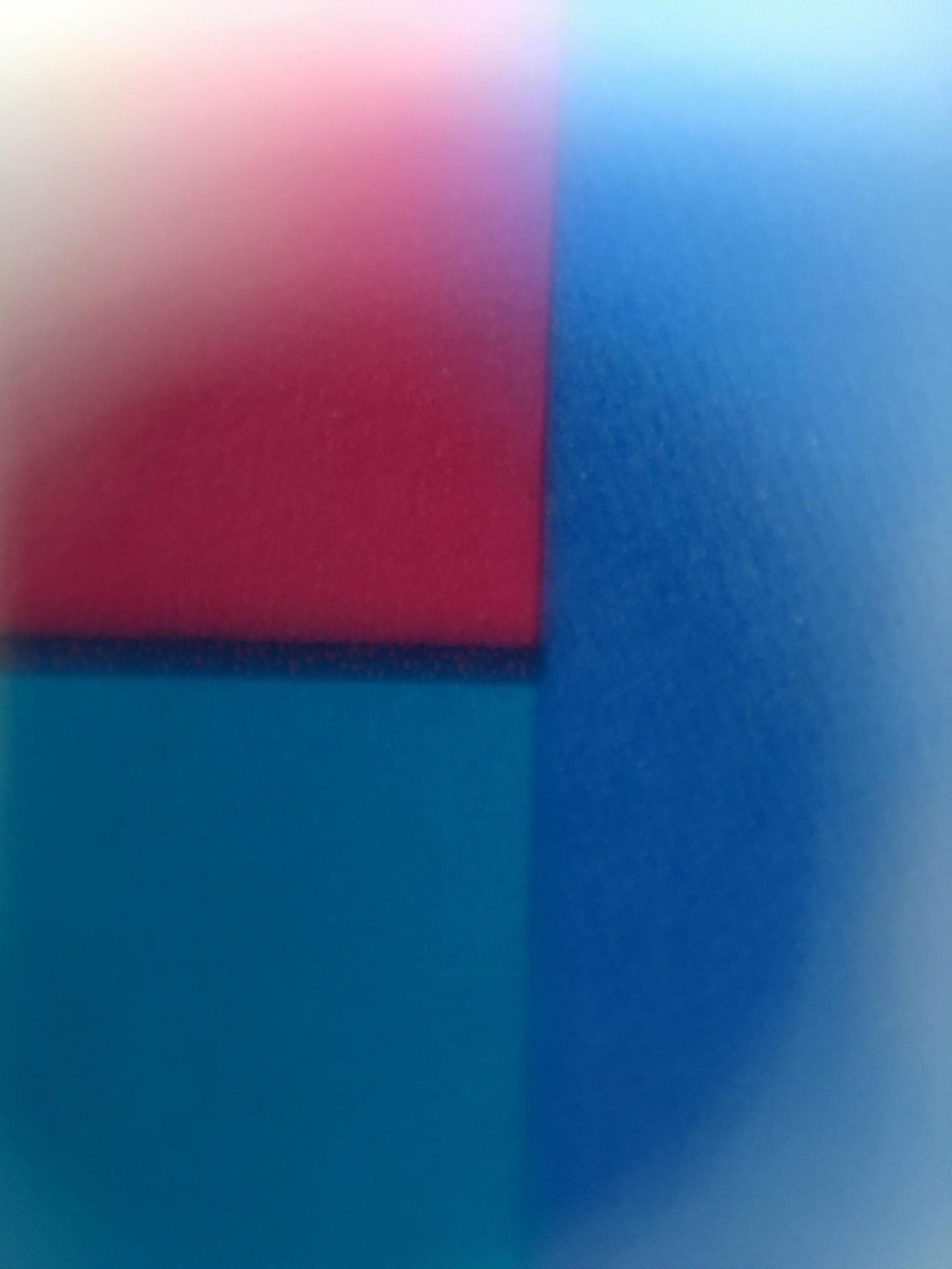

Hello, guys

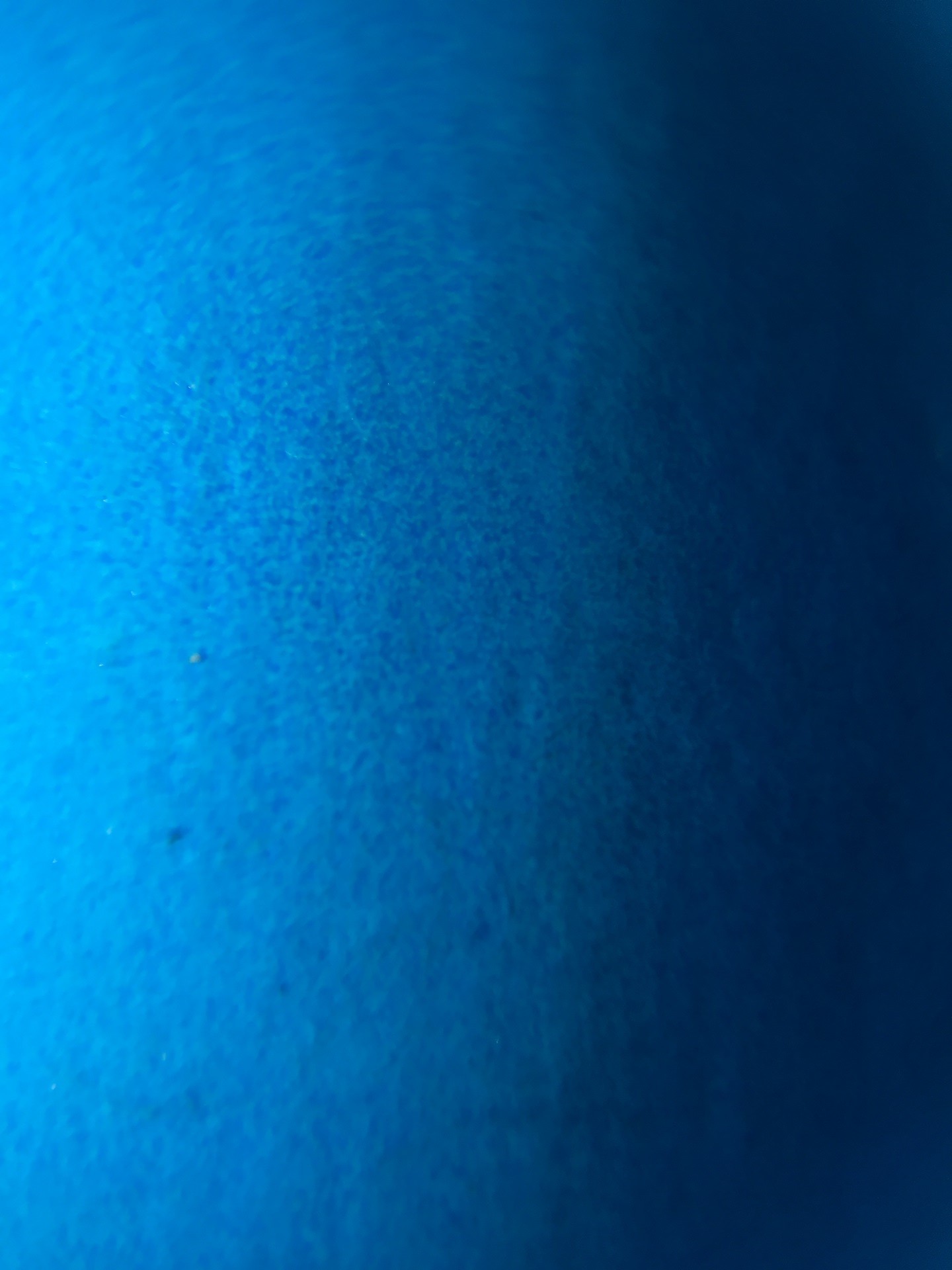

Nothing helped. Installed rollers from Heidelberg and this trail from anilox has not changed. We and the guys at Huber Group have developed a new ink that satisfies us. But this problem does not change the spot color. This is visible in the add photo. (Magenta, Cyan, Spot color P-2727). On the second photo is a solid field (100%)

Hello Anton,
"Nothing helped" ! ! this is no answer, I suggest you list all the steps you have taken to "Eliminate this problem"
1) A picture of the Print Control Strip 2) A larger picture of the area covered by the pictures you posted
Regards, Alois (Semi-redundant now)

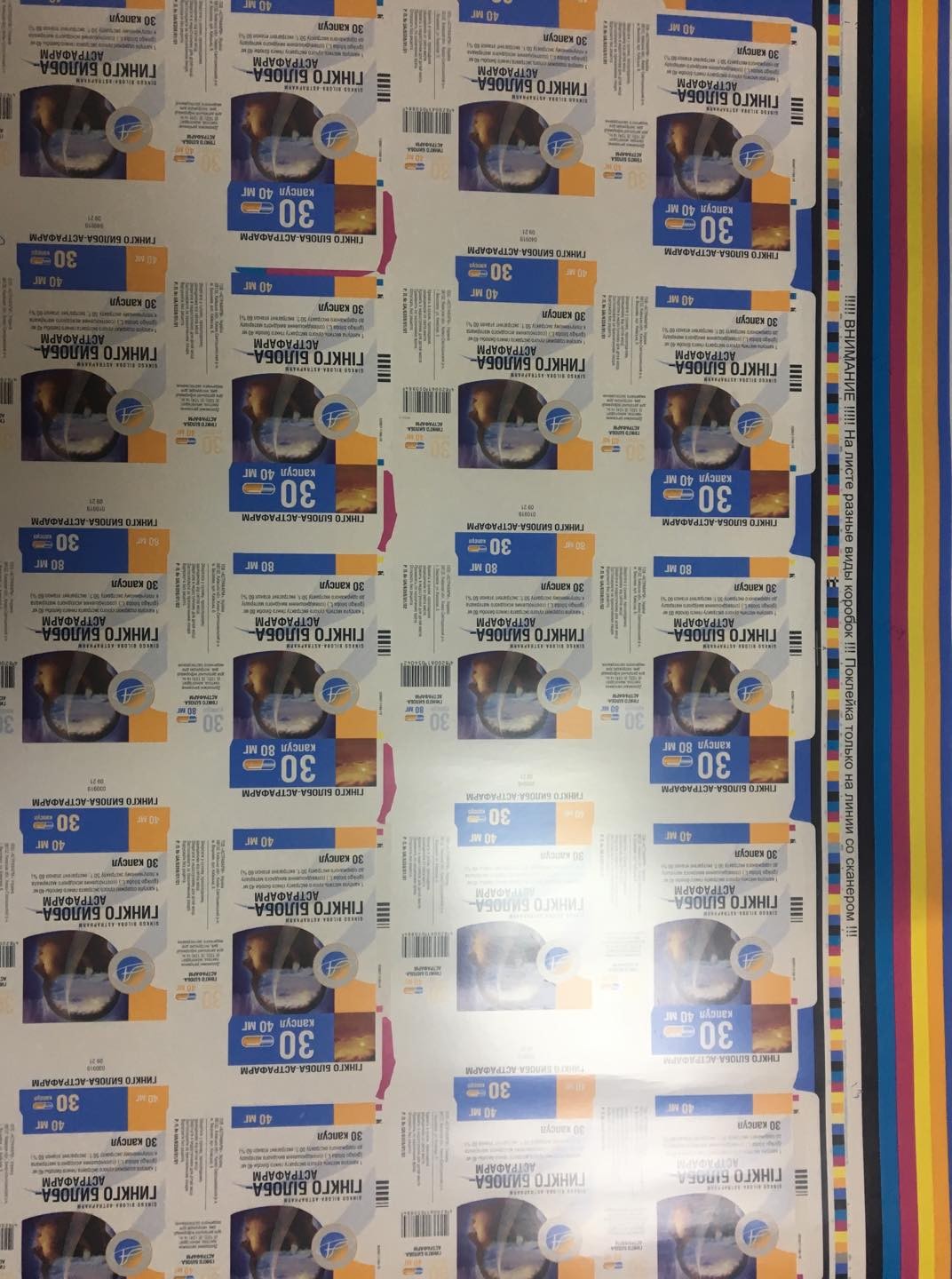

Sorry, really not correct from me.

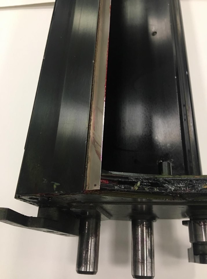

- First replaced the submersible fountain rollers with the original Heidelberg. (Didn't help)
- Then colleagues from Poland recommended to try their application in the fountain (buffer), they work on it. (foto add) But there is a very low pH 4.0-4.2 (It got a lot worse. The hydrophobic layer is damaged by high acidity, and plate stay very sensetyv. Foto add) We returned to Sapphira.
- On the transfer cylinder we had a hybrid blanket(oil and UV). We replaced it with a softer one and only for oil ink. (Didn't help)

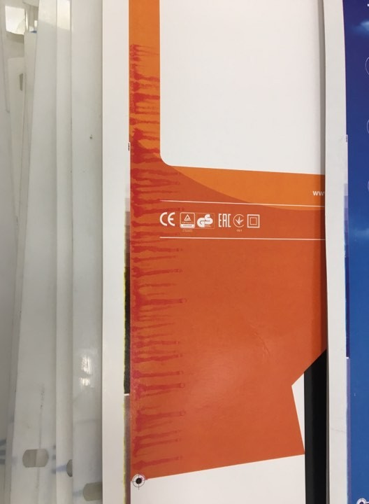

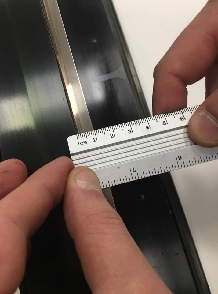

- Then tried the blades of another manufacturer with a different angle of sharpening. (Foto add) Also tried the knees bothsharp. (Didn't help)
- We asked the Huber Group guys to help us. They created the ink process specifically for ours Anicolor. End thise halped. But the problem with spot colors remained.

I don't know how much help I can be to you but I will give you a list of simple things to check. When I say double hit when running PMS spot color jobs I meant one plate solid and the other plate 50% screen on 2 units. This helps with color matching and ink laying flat and smooth on press sheet. This is because pantone spot color inks are not formulated to run on anilox roller. I would check your ink chamber blades. Are they installed correctly, not backwards, upside down etc. Refer to your operators manual that they are installed correctly in regards to blade bevel etc. Check your roller stripe from anilox roller to your ink form roller. On my press this stripe is approx 6-7 mm in the middle tapering to 5mm on the ends. Also check your ink form stripe to the plate. These 2 stripe settings have gone out of adjustment on my press a couple of times. Heidelberg has to come in and reset these as they do not want untrained personnel to touch them. Pull out all rollers in affected unit and start over by setting all adjustments very light and increasing to desired roller stripe setting according to your press manual. Make sure you reinstall rollers and check stripes in the correct order to operator manual instructions. Check stripes to plate again. I don't know how many rubber rollers you have but on my press I only have 4 per unit. 2 rollers are rider rollers that are tension by spring so there is no setting for them. That only leaves 2 rollers to set. Many times I have found that my problems can be fixed by checking and resetting these rollers and it only takes a few minutes. Good Luck!
Dear Colleagues,
If analyzed and traced, this problem is independent of the unit, it depends on the viscosity of the ink. When I got a job and when I was shown a problem. The first thing I thought about was the plates. Then I checked the fountain solution. Then the blades and contact lines. The blades are made so that they can not be put otherwise. There are labels and there are grooves. Moving on the chain, I stopped at the viscosity of the ink. I cannot use one color for two units. Because I have a lot of jobs where four ink processes and two spot colors are applied. Or all six spot colors. Please tell me you have a similar track on a solid field? In my country (Ukraine), this is the first such press, and I have no one to compare it with.
I'm out of ideas to help you. Also I'm not familiar dealing with a press that was converted from UV ink to oil ink either. I suggest you get a Heidelberg tech back in there that is trained to deal with these kind of problems to help you unitil the problem is remedied. Good Luck!
