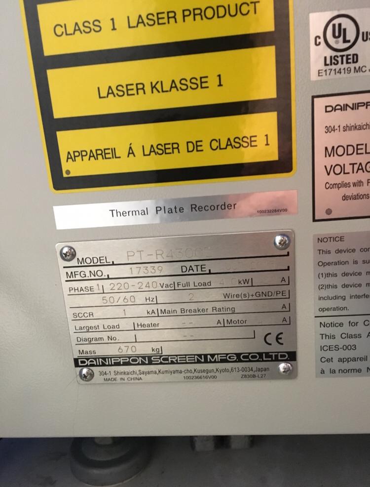

There is usually a blue or black box that connects the rip to the screen device.(Agfa Avalon)
What is the exact model number.

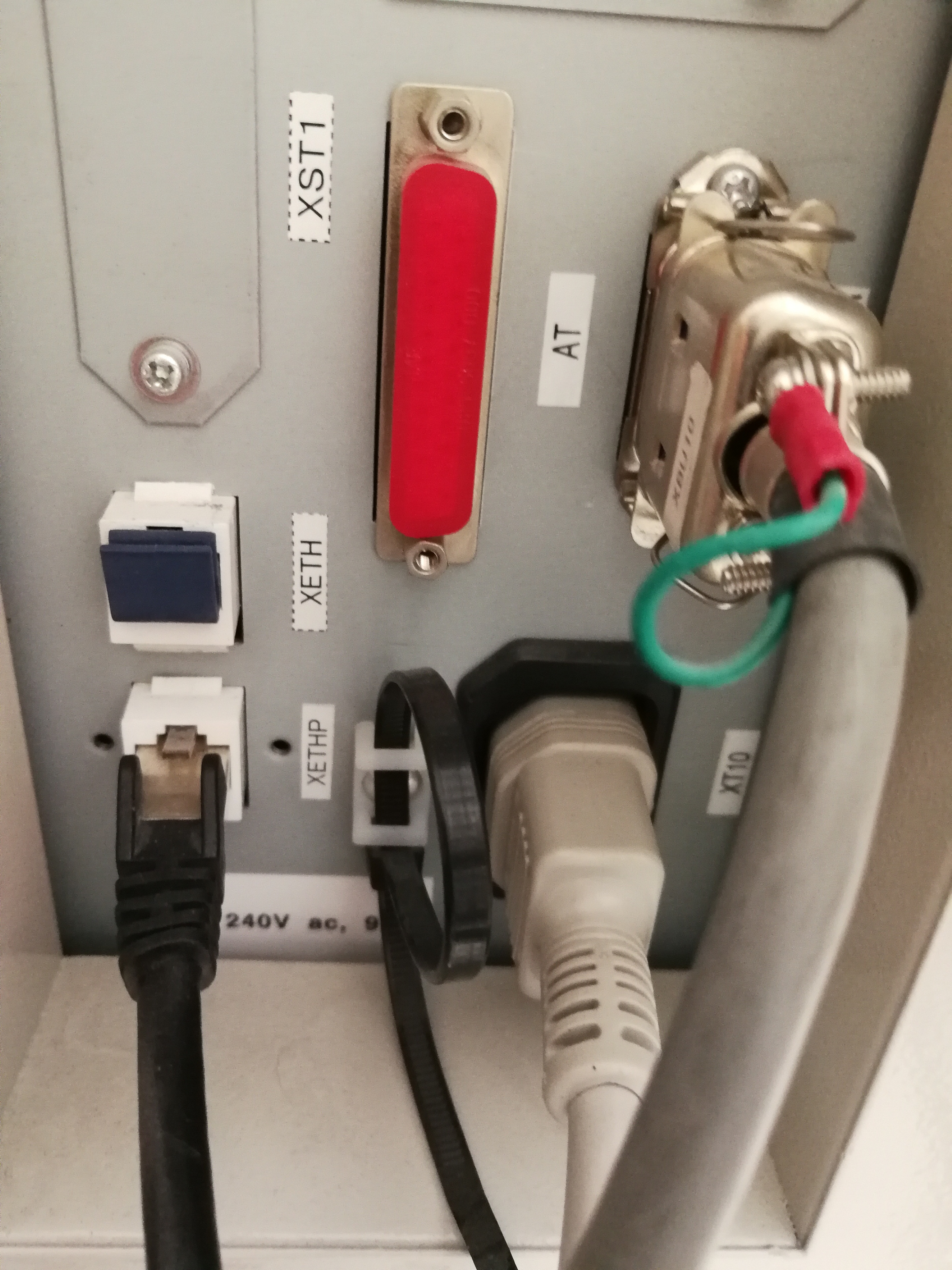

Here are the pitures , is there anyway to use a Pif Board to conneted this machine ?
If yes its more easy 4 me .

My guess is that a PIF card won't be an option as I don't see a port on your platesetter labeled, "PIF1". If you get a RasterBlaster PC, I'm thinking it would just need 2 ethernet ports; one that would connect to your network so that Apogee can send TIFF files to the RB PC and the second one would be a direct connection between the RB PC and your platesetter.

Hope you got this sorted in the end, for those confused about the interface on this device. This seems to be a rare build I believe only Agfa has, It does not have a PIF interface, nor as I understand can it have sockets retrofitted. Instead it is network only. The network connection actually is the EPB-101 board (blackbox board) but mounted in the CTP. changing IP cannot be set from CTP control panel, but instead must be done via the dip switches and web server interface exactly the same as the box itself.
As for which Tiff catcher to use, I found some to have issues with this machine, a kind of jitter effect on the dots when looking with a microscope. while other tiff catcher worked fine.
