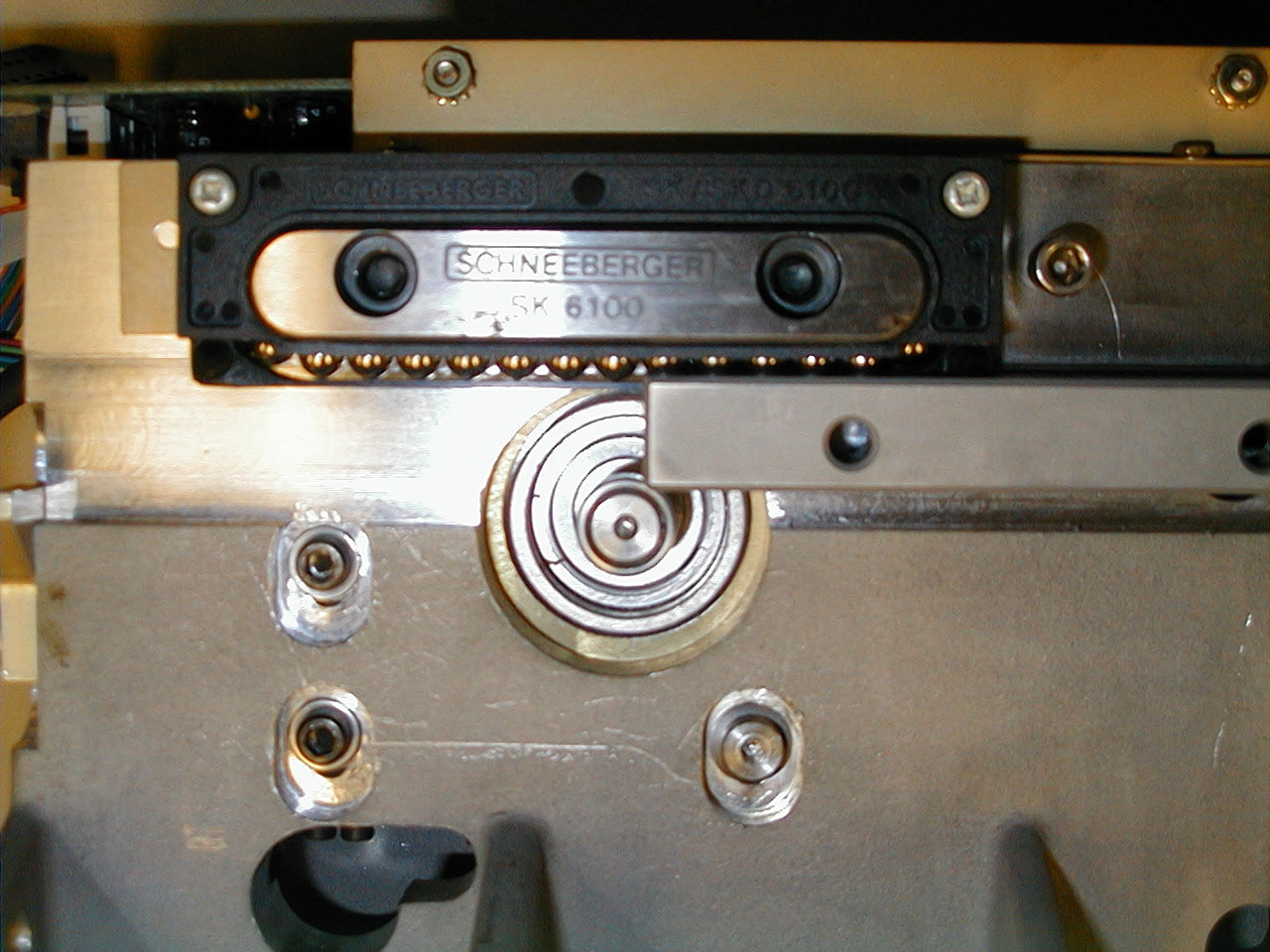

You have 2 Bearings on the carriage. Be careful not to damage them. You can see one of them on the rail. Please open the attached file.
