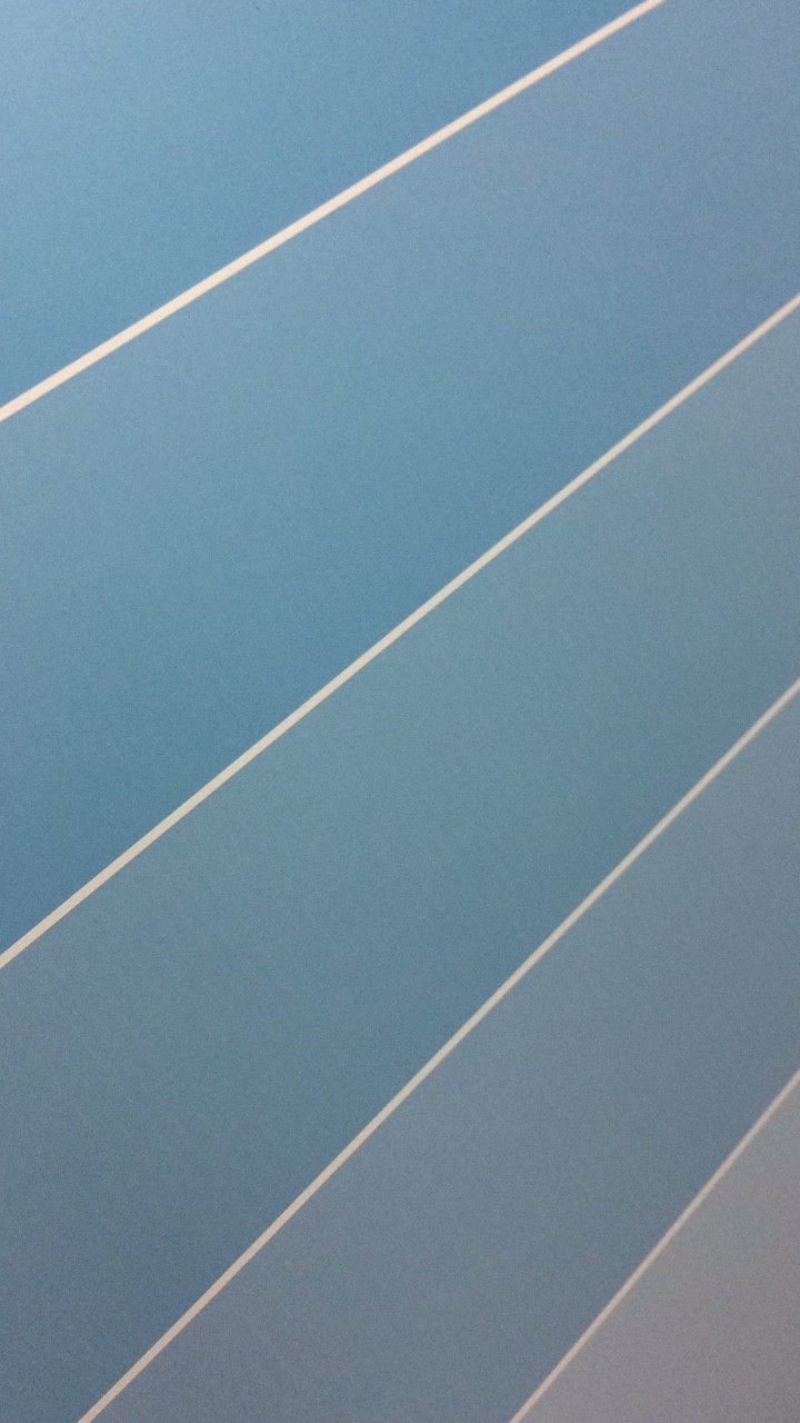

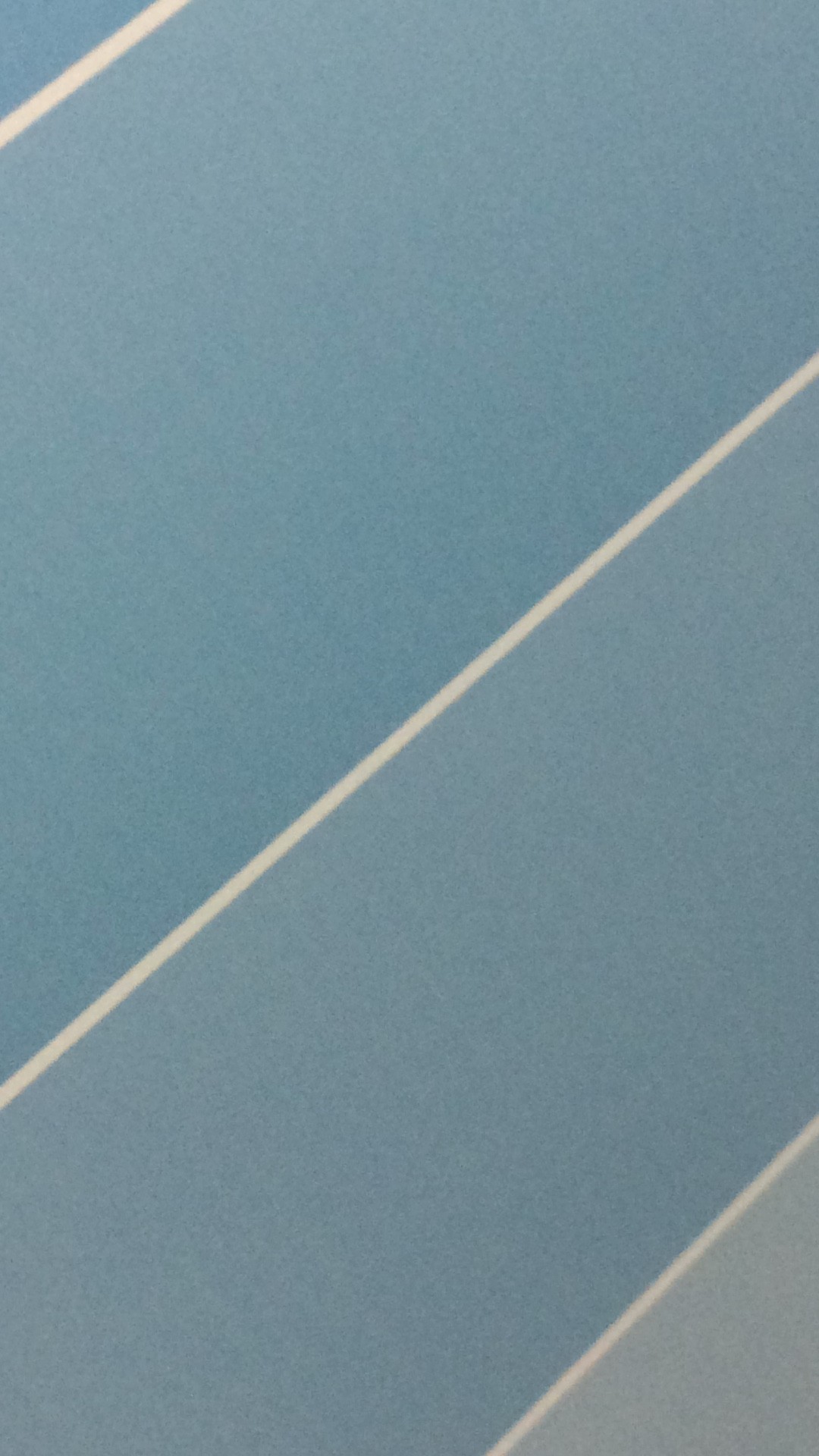

Thank you for your fast response, please see pictures of test jobs, the tech is increasing and decreasing the laser power and drum speed but we haven't been able to reach a perfect level.
Ask the vendor to image a set of plates through one of their other clients for comparison, with 256 steps per channel available the distance covered and the amount of change from start to finish in any given gradient could the primary factor in causing banding
