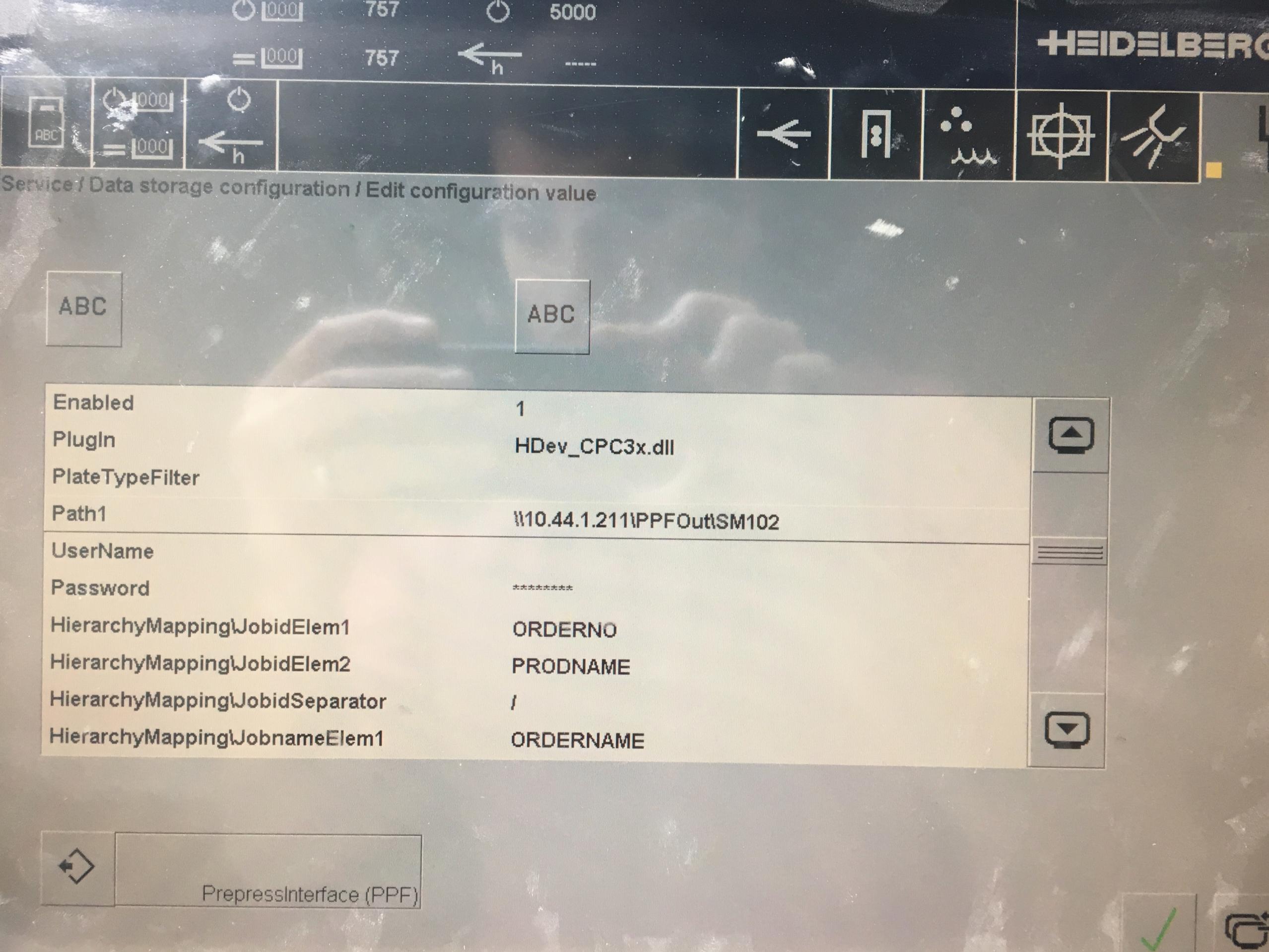

Thanks for the reply, I've looked everywhere in service mode but can't find where the IP for the CP2000 is set. I have changed in PPF path under Service/Data Storage Configuration/Edit Configuration (see attached) but where is the CP2000 IP stored?
Thanks,
Naysan

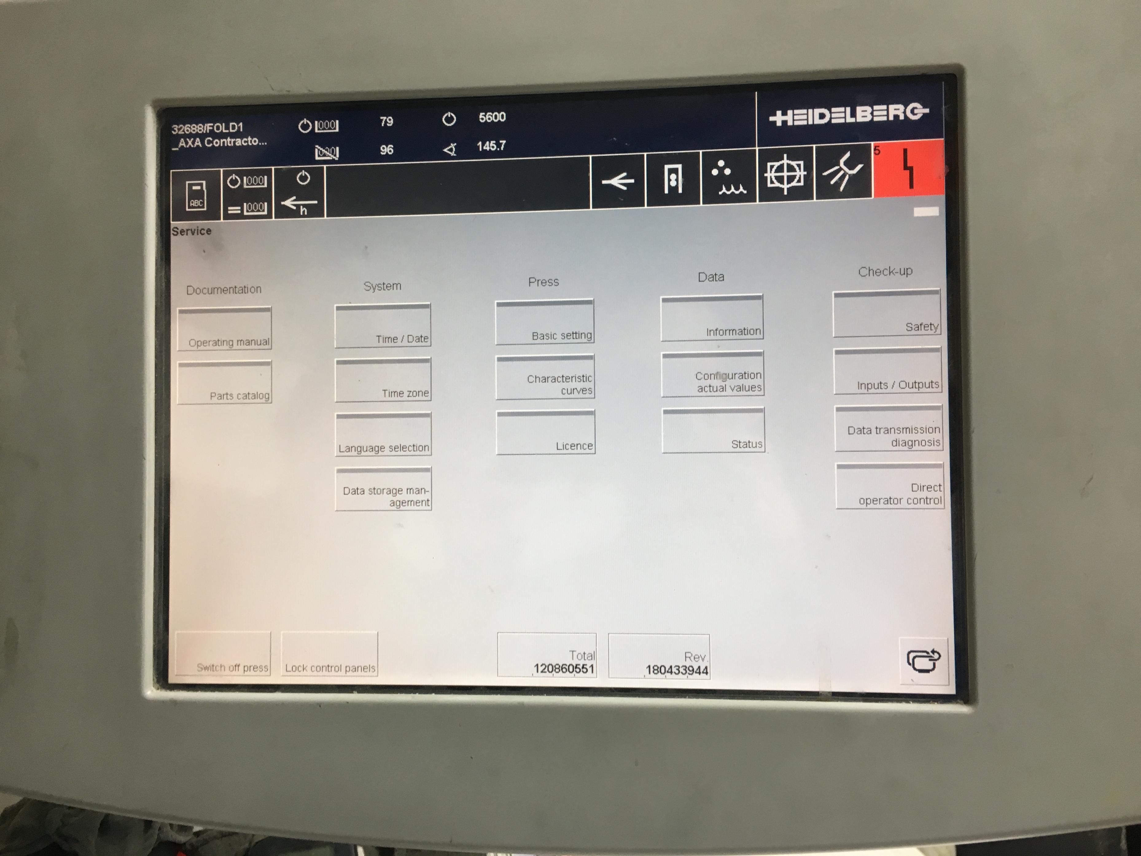

Too deep)) IP can be changed from the first screen of Service Mode. Make me th picture and I'lll tell you.
Service mode picture attached, I've probably just missed it somewhere! All the settings I changed were in Data Storage Management in the System column.
I have been trying to change the TCP/IP settings within Windows NT on the CP2000 machine but the user which auto logs in (OPI) doesn't have local admin permission to the machine so I can't change any settings.

It's because you are trying to do something as standard user of CP 2000, NOT SERVICE. I will try to ask my client to make photos of screen of CP 2000 to show you.
Thanks for the reply. Yes I totally understand, I was trying to change the IP of the machine at the Windows OS level but then realised that I need the password of a local account that has admin permissions.
Are you are suggesting you can change it at the Application (CP2000 Center) level too? I appreciate the support!
