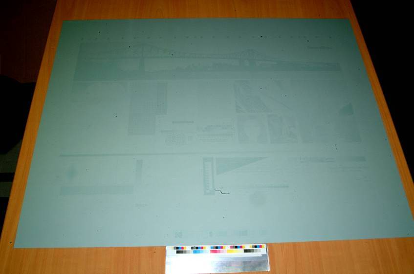

Question for awaltd:
First, thanks for the explanation on how the coating is removed. My question is how does the pressman know which plate he's putting on the press. Is the image obvious enough that you can tell which signature and what color it is before it goes on press? How do you QC the plate before it has the emulstion removed. I don't think think the time to check the plates is when they are already loaded up on a multi-million dollar press. Is that not an issue?
Hi 30Years -
Attached is an un-manipulated photo (sorry for the dirt on the CCD... it's an old DSLR!), with a grayscale to compare to.
We fully admit it's not measurable with a densitometer. However, I'd counter that the Stability of both the plate reproduction, and the imaging (assuming you're using a Kodak engine of course!) make that immaterial other than the initial one-time setup on press. We find that many of our processed-plate customers don't even own a densitometer these days either, and the ones that do rarely ever use it to meausre plates - because they don't need to.
The contrast, while low, is certainly sufficient to see which job and separation the plate is, to get it on the right cylindar.
Kevin.
Well we must be the exception I guess. We do own a densitometer and use it a minimum of 2 times per shift. In addition we do a visual check of the wedge on every plate. We very seldom need to make adjustments but this is a requirement of our ISO procedures. Even go so far as signing off and recording that this has been done on a daily basis. From an ISO point of view... how would you QC these plates?
Kevin, is it quite visible in yellow safelight?
A few pressmen told me they had some difficulties to read plates, probably it depends on personal eye conditions.
