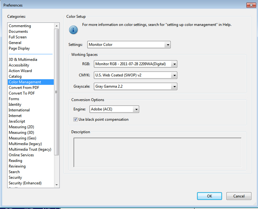

Under Preferences > Color Management, Acrobat was set to
Settings: Monitor Color
Working Spaces -
RGB: Monitor RGB - Custom Monitor ICC Profile
I know that's not usually recommended!

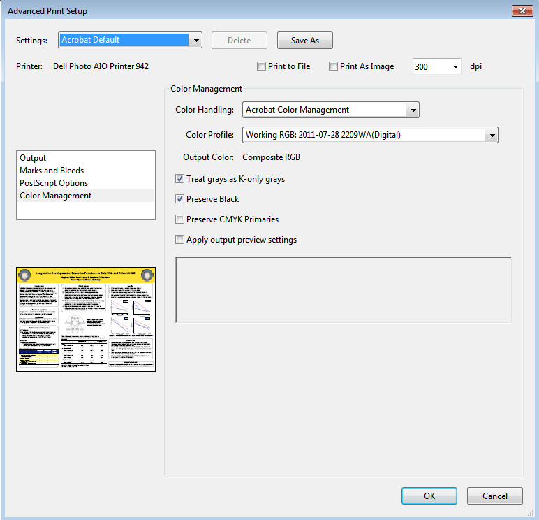

From the Print dialogue, in the Advanced Print Setup box, Color Management is set to
Color Handling: Acrobat Color Management
Color Profile: Working RGB: Custom Monitor ICC Profile
Output color: Composite RGB
Shouldn't the color profile be my Printer/Paper-specific ICC?

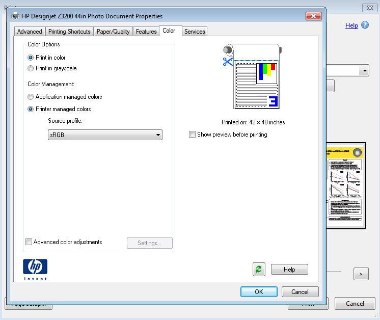

Finally, in the Print dialogue Properties menu of the HP Designjet, in the Color tab, the Color Management is set to
Printer Managed Colors - Source Profile: sRGB
Are these settings as conflicting as they seem to be? What should my RGB working space be? What type of color profile are Powerpoint > PDF documents likely to have, assuming the customer is paying no attention to color management?

Well, the good news is you're pretty much right in all your assumptions, and you're asking the right questions.
Acrobat seems like a completely different beast in this regard and I am lost.
First thing to understand about color management is that there's never a different beast. It's always the same stuff. And as such, you're right, you never want to use your monitor profile as your RGB working space.
Ever.
Shouldn't the color profile be my Printer/Paper-specific ICC?...
At this point, no. It should be whatever working color space you choose to use. Usually some RGB space, and usually sRGB or Adobe 1998 RGB, although there are other options, and reasons to use them.
You get to pick your working space, and what you pick might depend on several factors. What you then want to do is use color management to get incoming files into your working space. Powerpoint to PDF would depend on the PDF conversion settings, but I'd guess they'd either be sRGB, or already converted to CMYK in the PDF creation, most likely SWOP.

From the screen capture of the Color tab of the printer driver window, you may have to explore print results from the Color Management, Application managed colours vs. Printer managed colors.

In the Advanced Print Setup - Color options, if I choose Acrobat Color Management, the program suggests I choose an ICC profile that "describes the target output device." I assumed that this meant the ICC profile I made with my printer/paper combo I use, but now I'm not so sure. I tried a test print, and I got much more accurate results using sRGB here compared to my custom paper ICC. So do I want to choose the custom printer/paper ICC, or do I choose my working space (sRGB as the default) here? Under what circumstances would I want to choose "Same As Source (No Color Management)" or "Printer Color Management"?
Also, if I have Acrobat Color Management selected in the Advanced properties, then do I also need to have "Application Managed Colors" selected in the Color tab of the print properties window? If I have Printer Managed Colors, is the file being double-profiled?
If I choose Printer Managed Colors, I understand that sRGB should be the source profile since that's my RGB working space. But what about when I have a file that's been converted to CMYK? That's not a source profile option. Should I always go with Application Managed Colors in that instance?
That is what it means. If you're getting a better result using sRGB as your printer space, you've got something out of whack somewhere else, because your printer color space is not sRGB. It's possible, for instance, that if you assigned your monitor profiles to your incoming files, they got jacked-up enough that assigning sRGB back to them might make them print better than converting the incorrect files correctly to the proper printer color space (ICC profile). However, without going through your entire workflow, it's impossible to know just where your issue is.
Basically, the only time you want to run "same as source" is when you're printing profile patches, which you'd never want to do from Acrobat in any event. And myself, I never recommend "Printer Color Management" on these types of printers/drivers for any reason.
Yes.
If you have to use this printer and not drive it with a RIP, you should use application-managed color regardless. But in response to this question, understand that most people serious about color wouldn't run this printer with this driver. It's pretty limiting in what it allows you to do as far as controlling the printer. If you're serious, you might want to look into getting a RIP.
That said, you'd just have to try it and see what happens. It might be that if you sent an actual CMYK file, the driver would give you a choice of CMYK source spaces. Or it might have no CMYK emulations included, as, since it's an RGB driver, it has to send an RGB print-stream to the printer.
