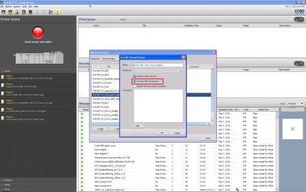

I'm not sure what it dose or how it works exactly but I had the same issue and checking that box worked, its like it ignores the default size of your PDF and uses only the one in you imposition.
Here's a screen shot

found it!
Worked perfectly!
Thank you ever so much!
