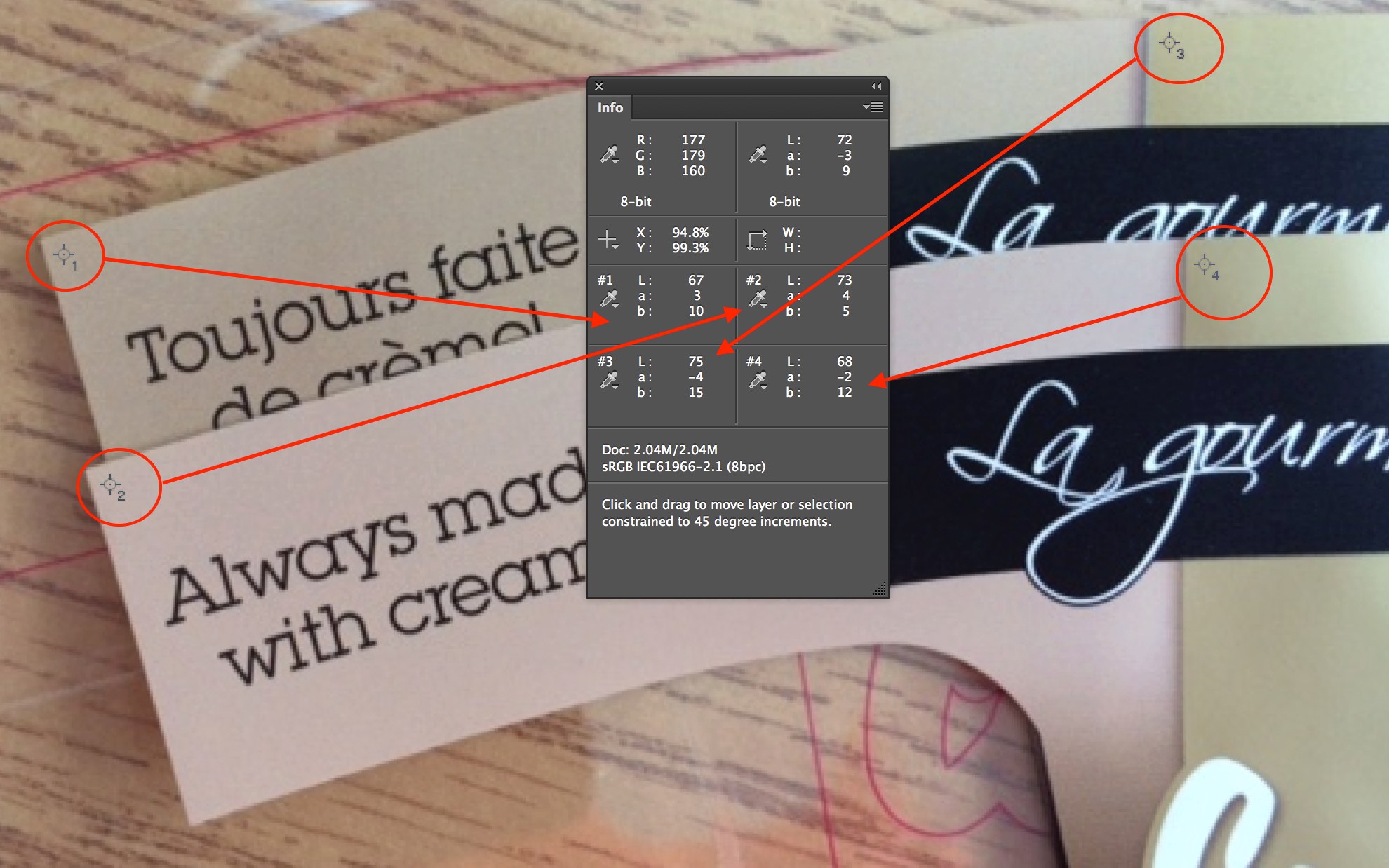

The labels are produced in sheetfed offset with non uv inks. The substrate is BOPP (Biaxially oriented polypropylene) Here is a pic of the label in question laid on top of the first production run.
Tamale
Thanks for the image.
The left hand side shows the variation between runs.
The centre/right hand side appears to be much closer together.
Depending on the colour builds of both areas, chances are if they tried to make the left hand side match between runs, the centre area would then be off between runs. If the press operator had a gun held to his head and was asked to pick an area of the label to match – they would probably pick the centre area (I am presuming this is some sort of tub label?).

Stephen, the issue is actually from top to bottom. The bottom label being the new run. The gold colour to the right of the letter G is a spot gold.
Before reading the above answer, my first thougt was the same as what Stephen thought. That the more "reddish" label was the new one. Now knowing that it is the other way around putting myself to the pressmans shoes looking at the label he actually might have manually adjusted the press in order the make the two colors appear as different shades of the same color. I could easily see that happening. But if that was the case then a proper color proof or a sample of the previously printed label could have been the fix.
