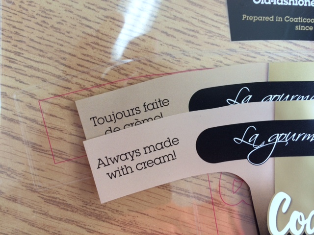

The issue is with a label printed with a cmyk yellow-gold background. On the new order we just received the colour is now a reddish-beige and they claim it is within tolerance.

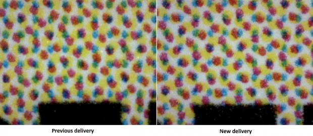

Here is a pic they sent . Is it me or is Screening angles.png.jpg there a difference in the two yellow screens?
Here is a pic they sent . Is it me or is there a difference in the two yellow screens?
OK, Here's the step by step so that my thinking and conclusion can be challenged.
First I traced the direction of the CMY dots:
Then I moved them to common centers so that I could measure the angles:
Then I rotated each by the same amount (-15°) in order to make the Yellow the reference at 90°
Then I overlaid black lines at standard angles - 90°, 15°, 45°, 75°
What this does seems to indicate that the M angle stayed the same at 45°. The C angle stayed the same (at 30° ! ). But the Y angle was moved 15°
So their old relative screen angle set was:
C: 30°, M: 45°, Y: 0° - This could lead to a C/M screen moiré (C only 15° away from M)
Their new relative screen angle set was:
C: 30°, M: 45°, Y: 15° This could lead to a C/M and C/Y screen moiré (C only 15° away from M and C only 15° away from Y. BTW C being 15° away from Y is a standard compromise. Because Y is so light and typically run at 108% of the other screen lpis the C/Y moiré is usually not noticeable.)
So, if I'm right, they've gone from the possibility of having one screening moiré to the possibility of having two screening moirés.
Could these differences in screen angle cause a shift in color? Yes, because it shifts the overprints of the CMY colors which in turn can shift color. Also, if there is a C/M moiré caused by the new screen angle set, that moiré can show up as a periodic shift in color. I.e. over the distance of the repeating moiré pattern the colors will shift at those points.
Something is very wrong here.
On a sidebar. To bring the Y to 90° I had to rotate the angle set by -15°. Some vendor angle sets are rotated by 7.5° (to avoid single channel moiré). It's interesting that the 15° happens to be 2x the 7.5° rotation. I don't know why that was done.
I also checked the lpis of the two versions - they are the same.

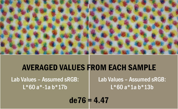

Attached is a sample from the provided image, however it is not known if both photos were taken under exactly the same white balance conditions, so this may or may not be an accurate test.

So I repeated Stephen's test but white balanced the two versions (BTW sure looks like offset not flexo)
This is what I got:
and the Delta E
Delta E 1976 would be the most used industry method.
Of course this is spiralling into speculation since we don't have anything to actually measure. But it's a interesting exercise none the less.

On my color Tool....
Delta E 1976 for Stephan Marsh sample was 4.000
and gordo's sample was 7.3485.

Close Stephen, there numbers result in db76: 4.18. They are using de2000, please refer to the email containing the data they sent.

Thanks Gordo, this is a great exercise, I can use this information in my questions to them.
As you can see in the Color Difference Calculator - if you change the formula for how the difference is calculated you change the apparent level of match. In this case Delta E 76 says the colors are quite different but Delta E 2000 says its a close match.
