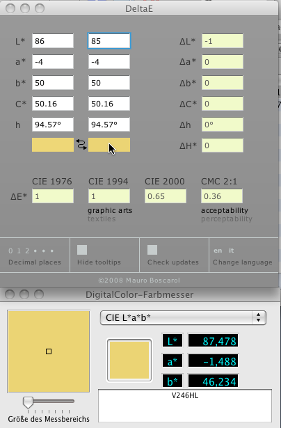

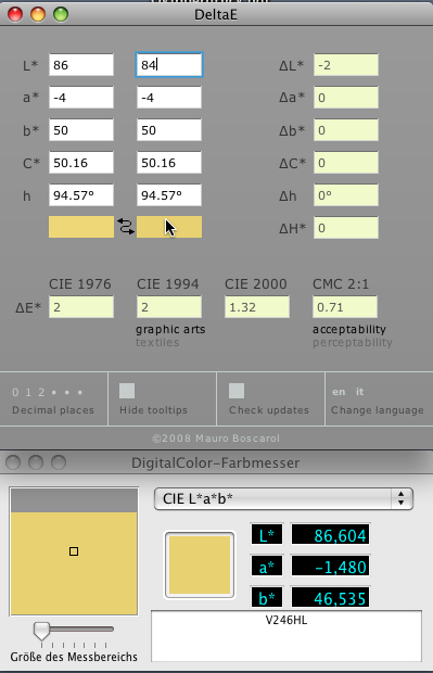

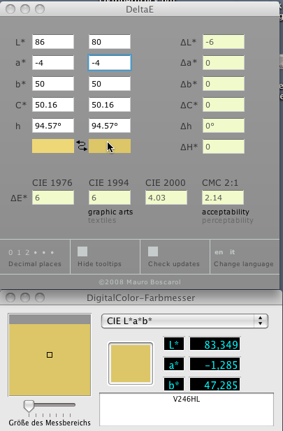

in this other example i try to proof that there is an importance if you will use the values for math as a base for "judging" (or using in a mathematical content ...), nevertheless that the ability of the human eye is limited to underline this fact... ;-)
But i am not able to explain the used formula in detail and so i can not really check Steve´s vote in an other way:
