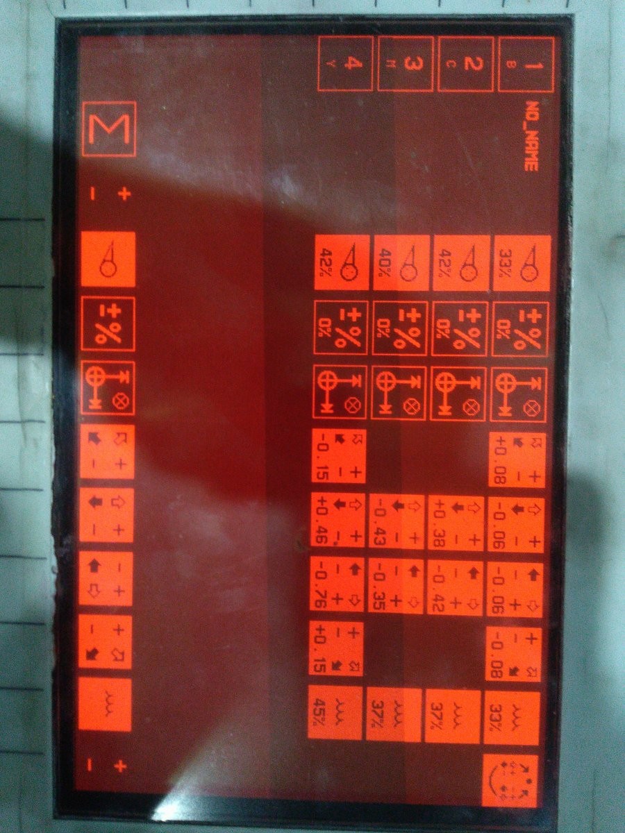

Hi,
on my cpc 1 i have lost command icones for the diagonal registers on two groups,
how can i get them back??

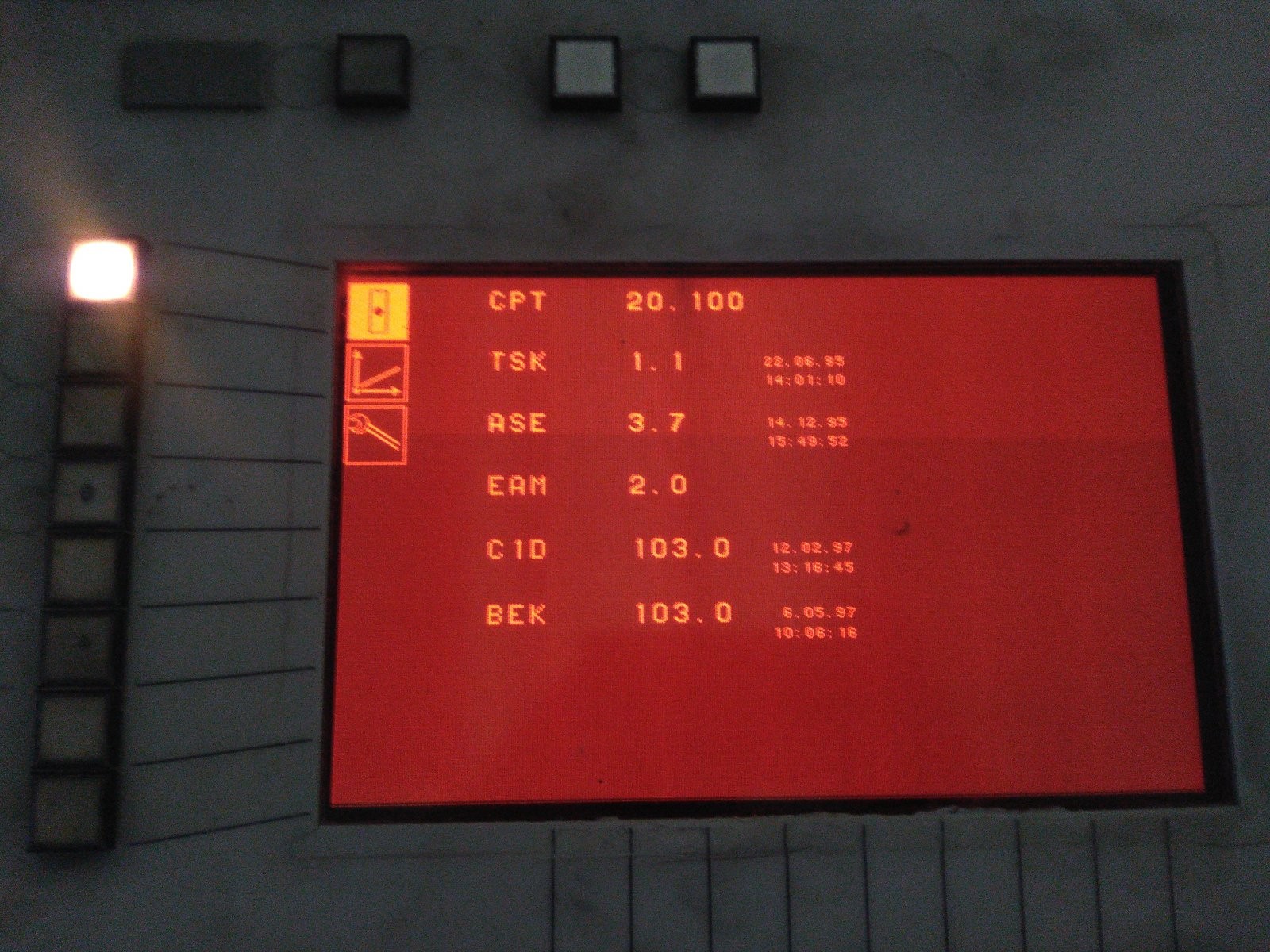

My guess... when you powered up, those 2 cocking motors failed the init test, so CPC will not recognize they exist when it loads. When CPC started up, what screen did it display? Did it say SSK at the top and have a number blinking below?
Hi,
The CPC boot normaly without any blinking number.
When i exchange motors connectors inside the cpc and switch it up, nothing happend except that i can control the exchanged motor from the other group.
