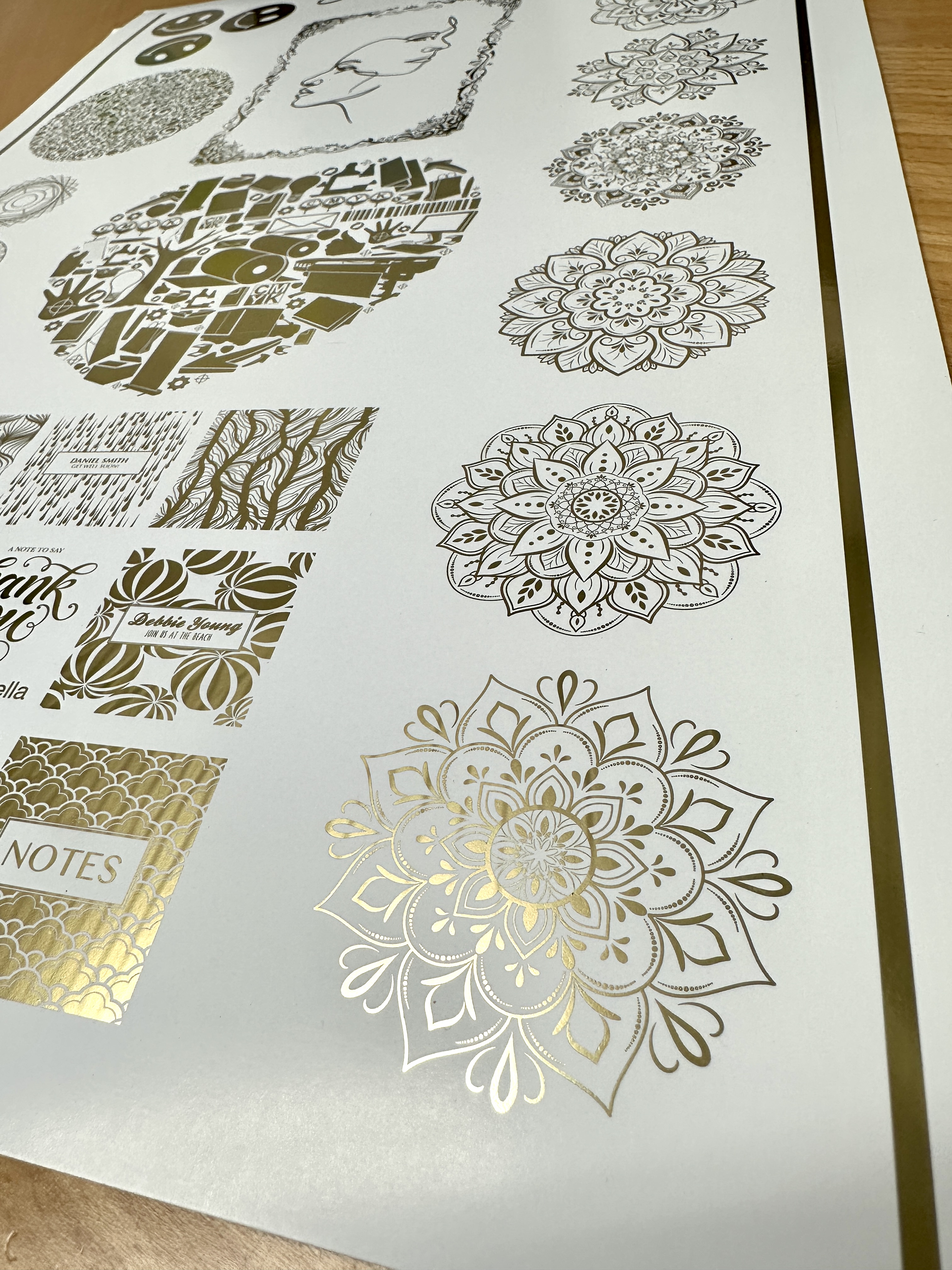

Bill, we have a Xerox Iridesse and the results we are getting adding Sleeking foil on top of the printed sheets is really good.
We've tested both Coated, Uncoated and Soft Touch laminated sheets with Great Results.
Can I reach out to you for a quote with sleeking foil?
Sure, we are not a wholesale shop, but will help any way we can.
What do you need?
attached is a sample of the Gold foil on coated paper.
my email is [email protected]
