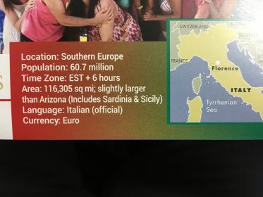

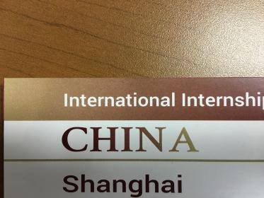

Attached are two photographs that I consider good examples of the problem. Both pictures are of gradients that were printed in 20 micron stochastic-screening. A third picture is of a proof and our printed result. The third picture was printed in traditional screening 175 line 2400 dpi round dot shape.
I was unable to upload pictures earlier because I guess I'm simply too incompetent to run a print-shop during the day and upload pictures to this forum at night...
I appreciate the replies and I will admit that my descriptions were not exactly scientific in nature, but this issue is hard to describe and now I have a few examples and can find others if needed.
I feel like the common denominator is the plates but visual inspections and plate control strip readings show the plates are very clean and focused and are VERY consistent. We measure every day off the processor. So, I'd be surprised if it was the plates but am certainly open to suggestions.

I believe you're dealing with slur, or marking. There are a few ways to diagnose the problem but you need to provide a little more information first. Your operator(s) should be able to help you with this information but to me (if your plates are in fact, very consistent), it does look like it's an on press issue.
Edit: After looking at your photos again, it also looks like it may be a squeeze issue, could it be that simple?
Judging by the very low resolution heavily compressed artifact filled images there is, I think, a suggestion of mottling - which could be caused, as alibryan says, by a squeeze issue or basic ink/water balance issue.

Is it possible to have (much) higher definition pictures?
On these pictures, I don't know if it is the printing problem OR caused by low resolution pictures, I see low-res rasterized gradients in the 2 first and a low-res printed image in the top of the third...
You said in your first post that the problem is "especially in color gradients"... so, are you sure that your RIP is processing the gradients correctly, in vector mode, and not simply rasterizing the gradients at a (too) low resolution?
Other possibility, the gradients could have been badly made by the designer, (mis)using a transparencie effect, and somewhere in the process (PDFization or rip processing) the transparency is flattened with a low-res setting?

Alibryan: Our 40in is a 2007 Heidelberg SM102. Our 29" is a 2001 SM74. Problems exist on both presses. We measure dot gain with handheld Xrite 518 densitometers (factory certified every year) we use a plate densitometer to check plates everyday too. We see these effects on both cover and text weight stocks
There is not any gum build up or scum line on the plates we output.
We aren't on the current version on our Prinergy system - in fact we're switching RIPs next week - having said that I wouldn't doubt that our PDF engine is behind and may contribute to the gradient/transparency issues but I don't think that would explain some of the "scum" we see randomly in other screens.
