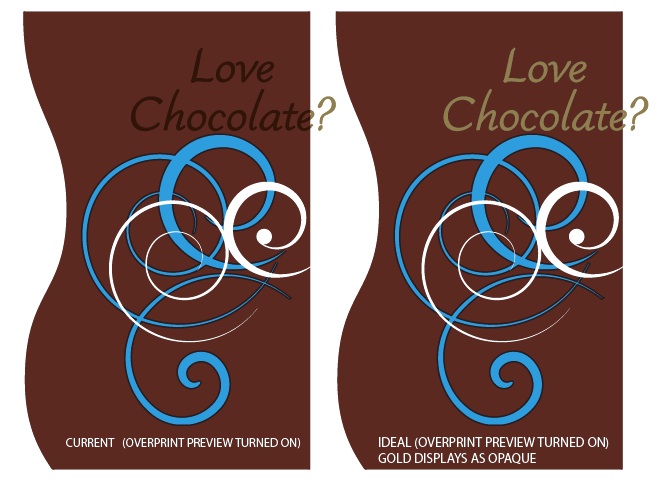

I am trying to create a pdf with showing an opaque gold ink separation (which is overprinting a dark brown background) in Illustrator CS4.
Is there an alternative to Esko's ink manager where you can define inks as opaque so they display as opaque. I want to display my traps on the pdf with overprint preview turned on but I need to see my gold as a bright gold not an overprinting dark gold, I hope this makes sense.
My work-around is to turn the gold overprint off to create the PDF however this is not ideal if left turned off.

I can't run any colour under the gold, as the customer checks the pdf for separations.
oh.... In that case, the only one option you've got.
Is to reverse it out of the brown and drop the gold in ?
You've done it with a blue

why can you do this to the Blue ?.......but you can not do this to the gold ?
what's the reason you knockout the blue from the brown
what's the reason you knock out the blue from the brown
Spider, it is my guess that the person soft-proofing these files is savvy enough to know that the gold should not knock out the underlying inks and that it is opaque and probably printing last in the ink sequence - while the blue is printing earlier and the ink is transparent and thus requires a knock-out and trapping.

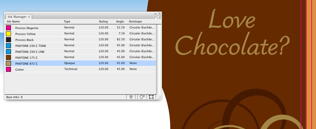

Yes the client is soft proofing these and we have a 'single pdf' workflow, therefore the same PDF get approved that is the print tool. Therefore I can't have two pdfs one thats correct for colour and the other thats correct for separation. The gold is not gripped/trapped and just overprints (like a foil gold) where the other colours trap. Esko lets you define ink separations that are opaque and provides a pdf that looks correct and prints correct, I am looking for an alternative. I hope I'm making sense ?
simply because the mis-registration error is higher with metalic foil blocking station than a normal colour, so the trap/grip would have to be larger plus the foil is opaque to cover the inks without any show-thru.
See attached pic of Esko's ink manager window. This lets you define ink properties /print sequence. Unfortunately I only have a demo version !
