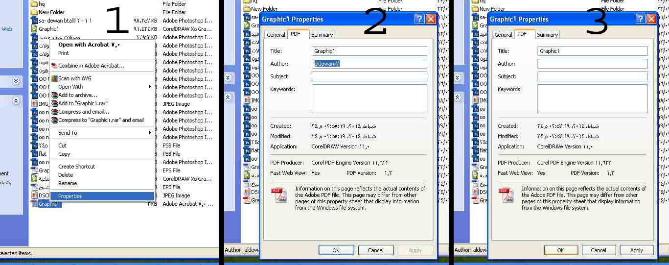

try to remove any other names in the PDF properties
