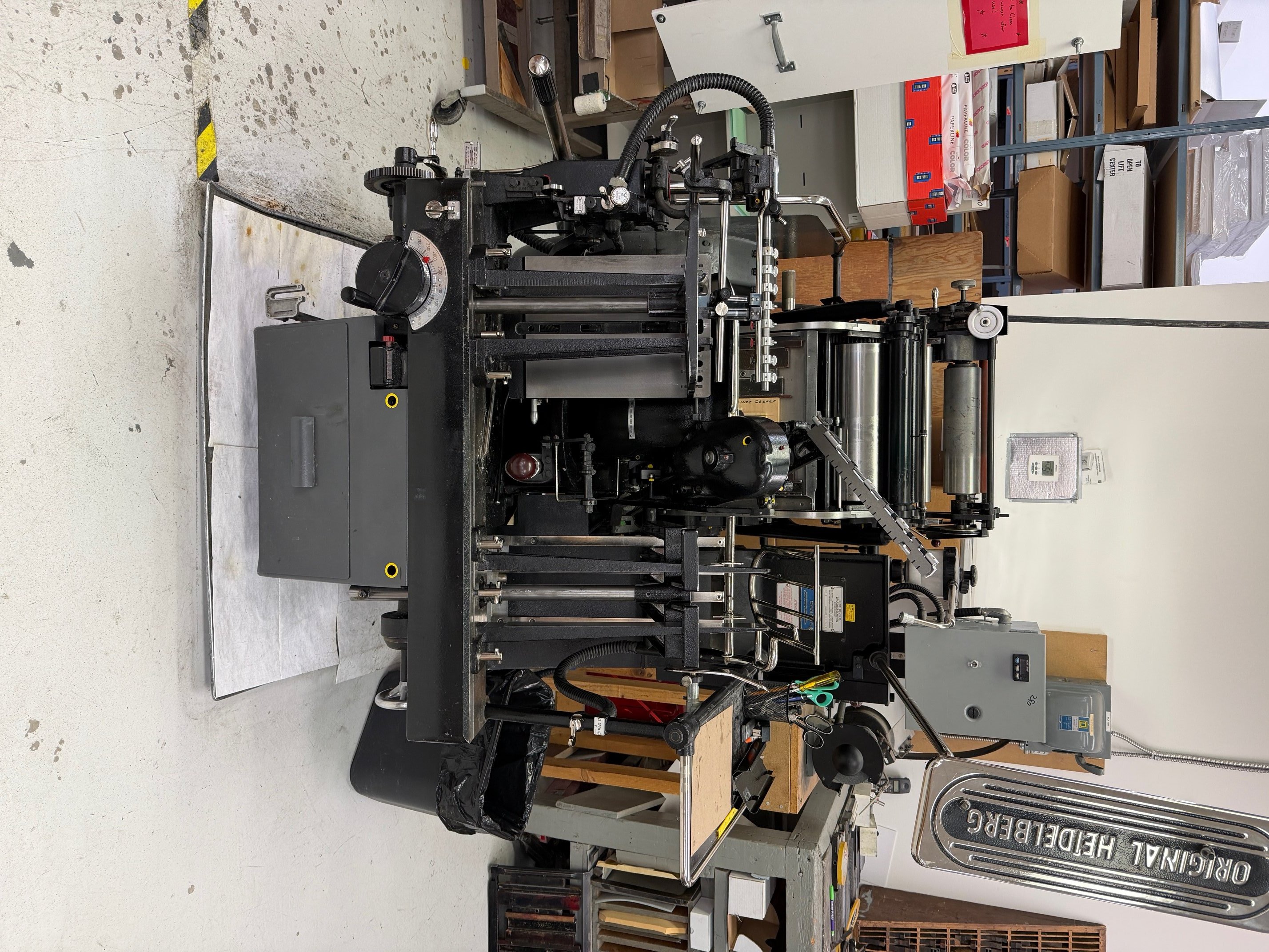

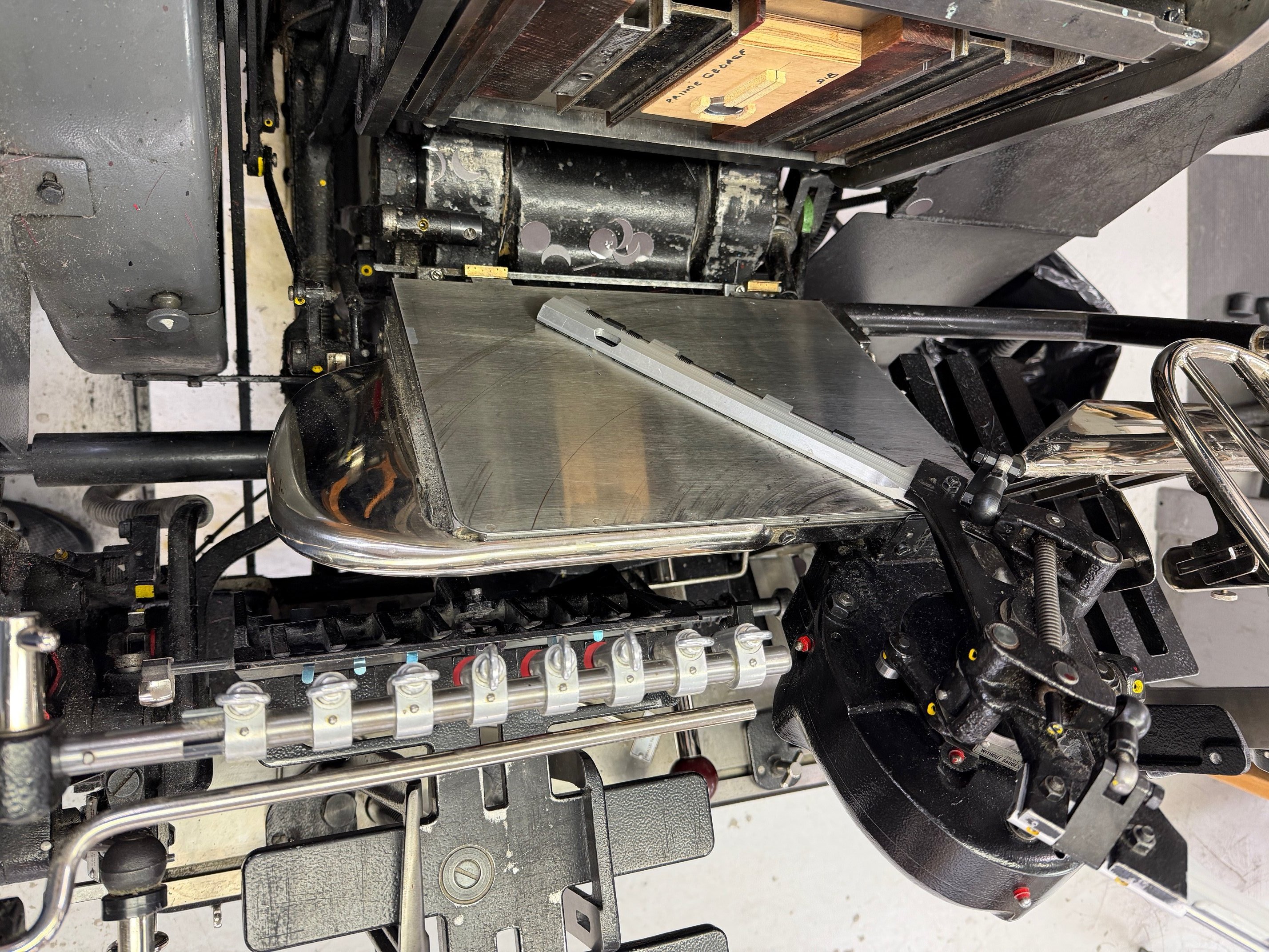

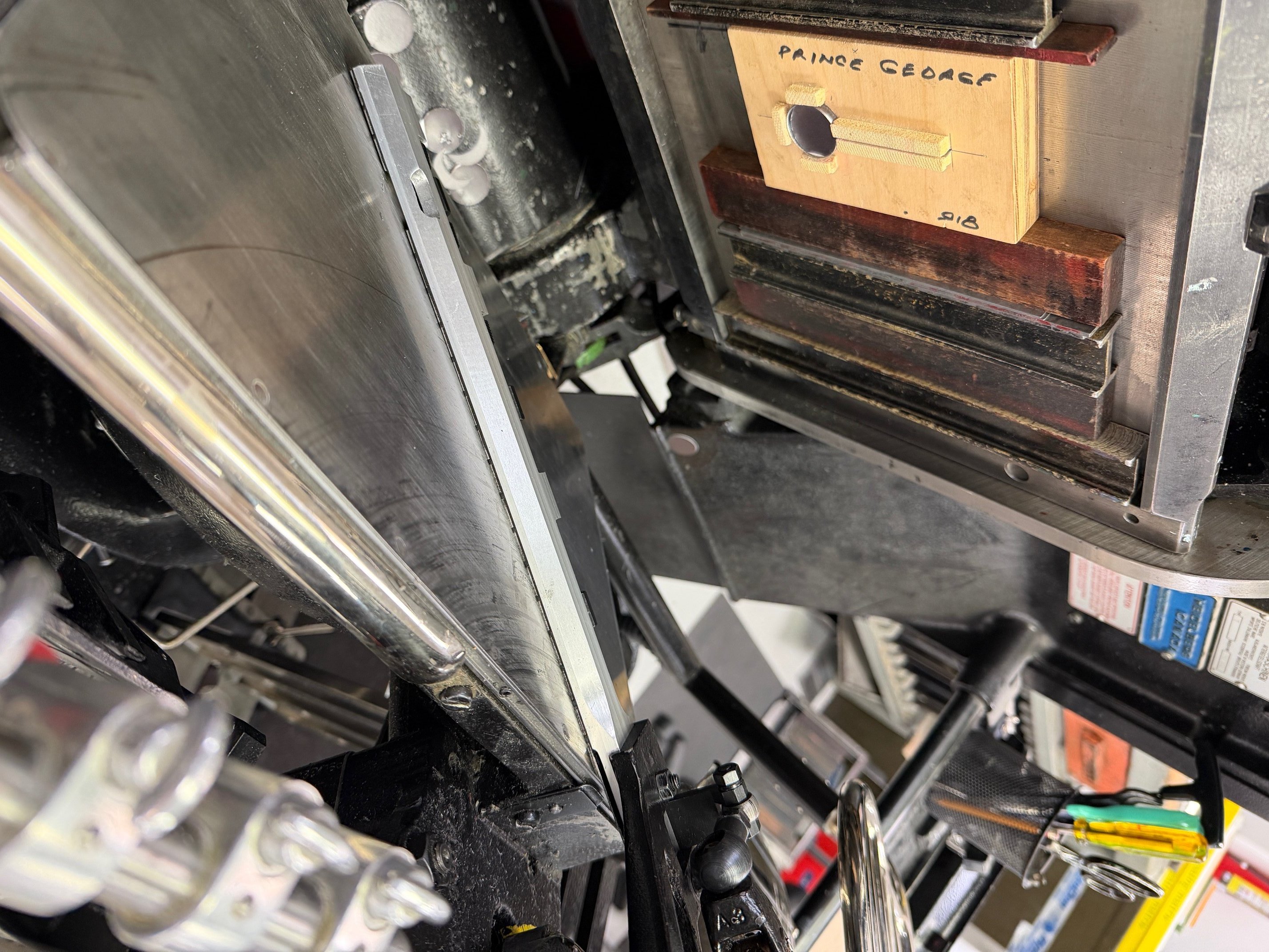

We just changed out the gripper bars on our old T-PLATEN letterpress and now they are rubbing on the back steel.
Does anyone know how to adjust them so it doesn't rub?
I have attached some pictures for reference.
Thanks!

There are two mounting bolts for each arm.
Loosen both enough to wiggle the arm a bit and shim under the outer edge. I've shimmed with chipboard, because chipboard fixes everything, and plate material.

I just took my set to the machine shop and had them mill down the arms a little where they connect with the 2 bolts so they cleared the die jacket.
been running fine for the last 5 years sense i did it.
Im guessing these are reproduction arms and have just been manufactured to thick.
You could use card at the back edge to rise the front but I dont recomend this as it can throw the 2 heads out of time with each other.
Tonez of getting a machine shop to take a little off the top would be best.
It is possible to file it manually but again it can throw the 2 sides out of time with each other.
Hope you find a soluation that works
