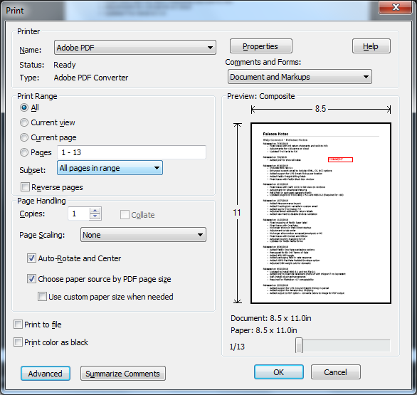

I tried with Acrobat Pro 9 on Win 7 (get with the times, I know, I know...). I added a comment to a test file, printed to the Adobe PDF printer instead of using "Save As" and the resulting PDF had the comment in it. This assumes of course that you're choosing "Documents and Markups" or equivalent to print. Screen shot of my Print dialog box:

well a work around was open in it google chrome then save it out. Somehow it flattens the art... weird but it worked.
