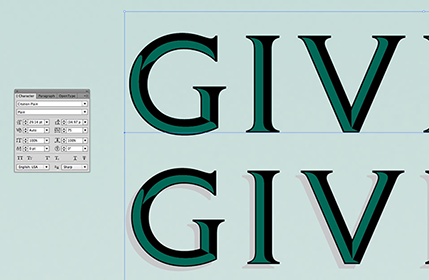

Citation is the font for sure. Good eye!
Erik, Thanks for that. I now have the font at least.
Next question is how to get the green. I see that WI-Flexo has gotten it, but my skills in Illustrator or nil. What I have so far
I. Create text to size
2. outline text
3. release compound path
After that everything just turns to the same color. Do I just select each highligh/bevel and change it or is there something easier. I only ask as I have about 100 titles to do this to.
Thanks everyone for your help so far. I am much farther along than I thought I would be at this point.
Paul

eyedrop to get the green color, use direct select (white arrow) to select a piece.
Paul, I have experimented with different methods. All do what you require. The first two will increase your skills in illustrator which is a plus. The minus is that it will be repetitive to do this for 100 titles, even with the aid of an action.
I will try to get back to you later in my day...
There is another method, however you will need a font editor to "simplify" the font for the solid fill.
Paul, here are links to two quick movies that I made to demonstrate the process -
Method 1:
Pathfinder
Method 2:
Live Paint
The first method could mostly be recorded as an action, you could also include your drop shadow creation etc. Instead of using the pathfinder one could just release the compound path, both methods achieve the same end. This method would be OK for digital printing as shown. If you were going to separations on a traditional press, then there would be issues with registration with this method and you would have to use a negative offset path to shrink these edges under the black keyline edges.
The second method using live paint does not really lend itself to recording in an action as it uses manual paint bucket moves, however it is probably technically better than the first method if you were going to traditional separated printing where trapping would be applied.
There are of course many ways to go about this task, including others I have not shown - and I have not shown every step that I would do on a live job, such as removing unnecessary paths etc. I am just trying to show some possibilities that do not take too much time considering that you have many letters and many titles.
Hope this helps and let me know if you need me to expand on any of these points or steps in the videos.

Thanks everyone. I now have something to work with. Not sure which way I will go just yet, but will give all of them a try.
Paul
Paul, I have attached an action to automate the process of the first video (except for where it requires manual selection of objects or other moves). This is the method that I would use as a "last resort", the live paint method is the better of the two.
  • Solid Fill Citation LET Font.zip
Stephen,
Thanks for that. After trying all the methods described, I have decided to go with the live paint option. As this is going to be trapped in the rip and I want to keep items vector whenever possible.
Thanks again everyone for the tremendous help.
Paul
