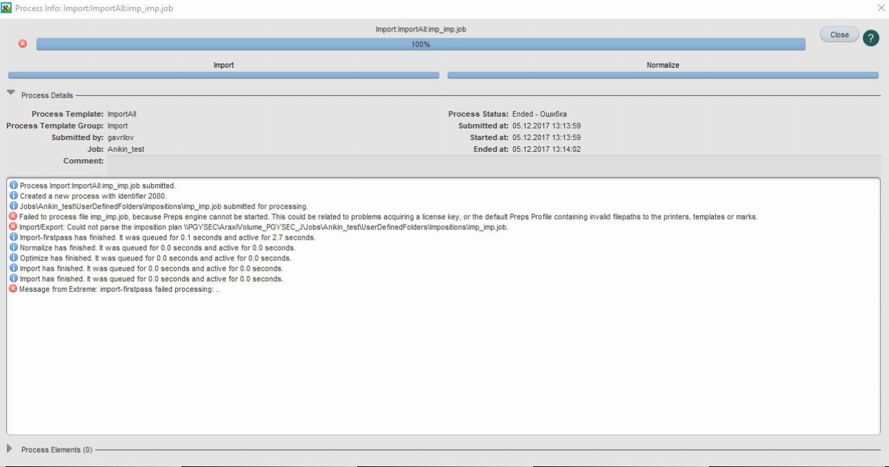

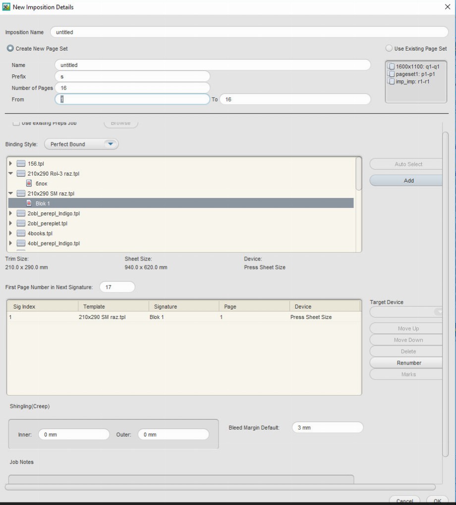

I got come problem with creating new imposition with Prinergy Signature Selection, Error comes out : but license is ok, paths to printers, marks, templates are ok too...
May be someone know, whats the problem?

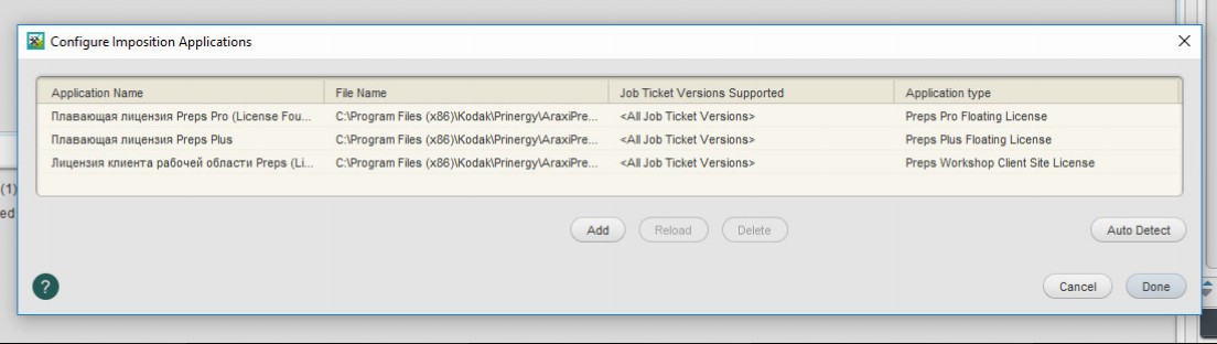

The Prinergy Preps daemon always uses the default.cfg file when converting .job files to JDF for importing. That file should contain only one line: -UNITS:1
If the default.cfg file contains a substantial number of other configuration entries, it is likely that someone has started Preps from the AraxiPreps folder on the primary server.
The errors show that the Preps engine cannot be started, which is essentially the same thing as starting Preps. When you start Prepsstand–alone, it checks the PPDs, profiles, and so on.
