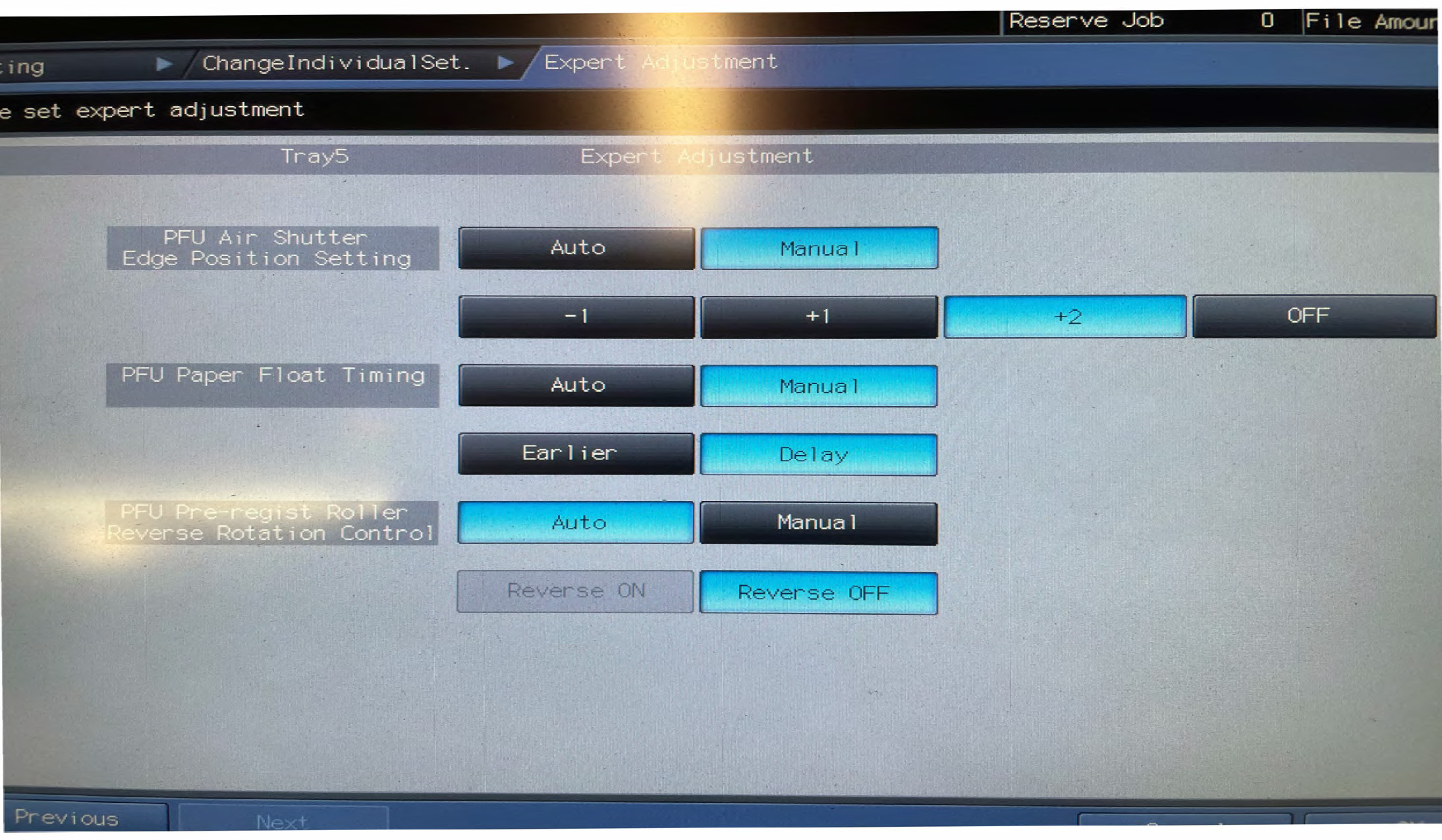

JeffJ
I had a similar problem with heavy stock on my 6136. We changed the timing to a delay on the paper settings. When I go in tomorrow I will send you a screen shot. It seems to be working 95% better.
