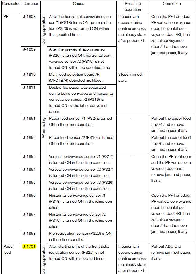

looking for a thread about codes we are getting code j-1701 every 6-8 sheets of paper machine jams somthing about a ps_22 sensor
Turbo, you need to place a service call and have a tech look at it. The PS22 is a registration sensor that is not turning on at the right timing. See attached screen shot of the service manual.
