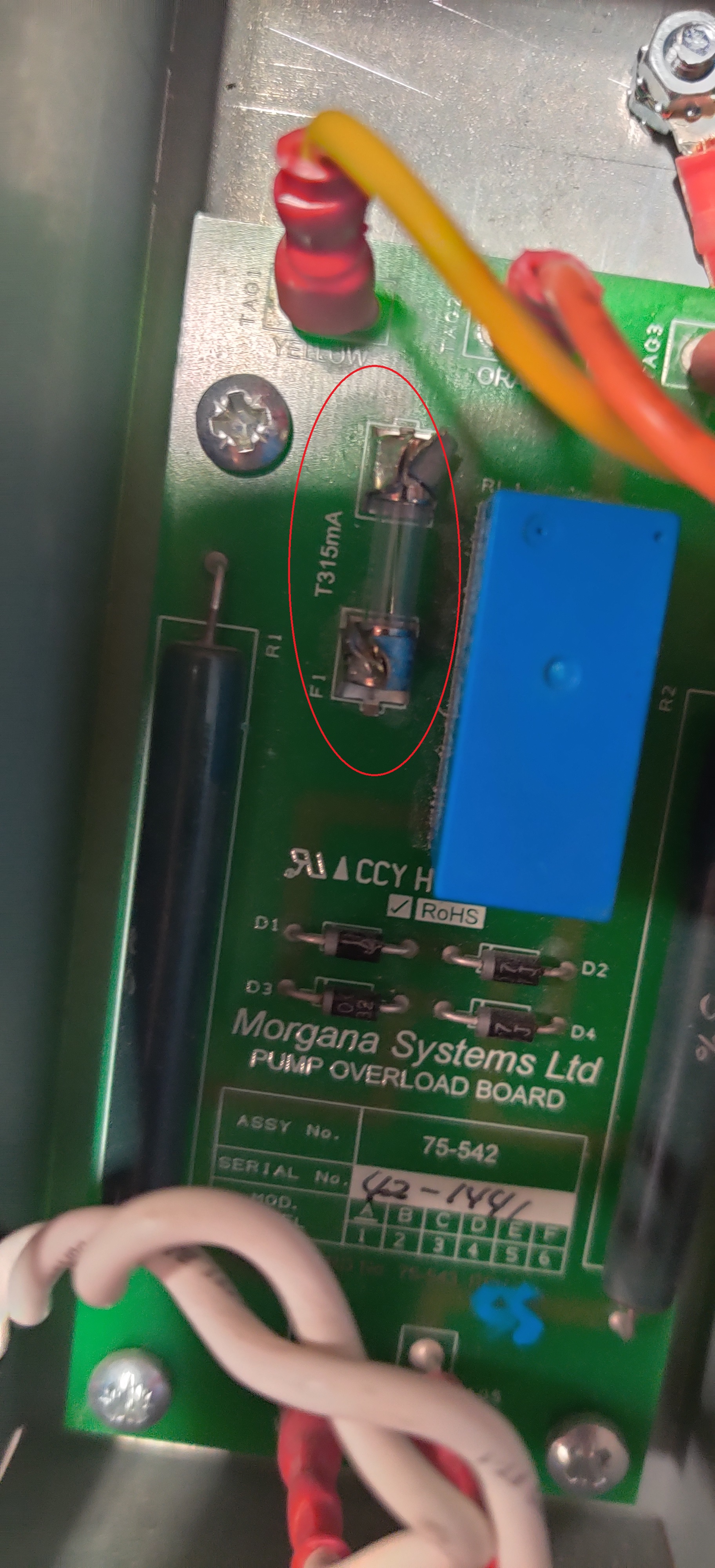

Good Afternoon All,
Our Digi fold has lost its suction and drive to the the drum. Has anybody any ideas? I'm thinking a fuse but not sure which one. Thanks
We only have the Autocreaser, but I have a feeling it's the same pump. If you take off the front panel there's a fuse box on the right side. It's just one fuse, just make sure after you change it that the fuse clamps are tight. you can probably see in the photo that the clamps on ours are pretty tweaked from changing it so often.
Turns out it's the main pump thats gone and blown the fuses. £1000+ to replace Morgana are telling me. will have to look around for the pump, if anybody has any suppliers please speak up.
Thanks
In these types of situations I look for the pump/motor identification plate/label, then go googling. It's amazing what's available out there, usually at a much lower price than you'll get from the OEM. Doesn't always work out, but it's free to try.
