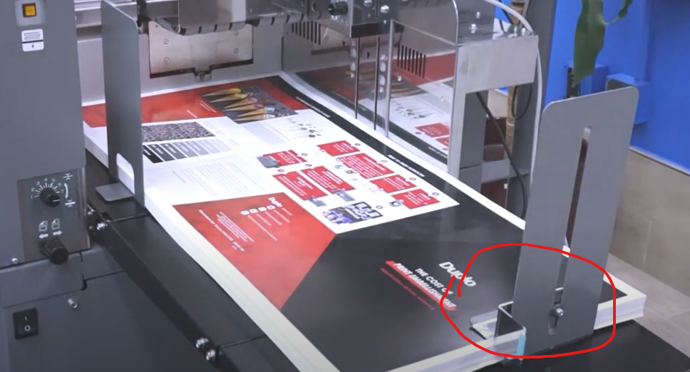

I will upload my fan setting tomorrow, the weight is basically to press down the sheets and also prevent air escaping from the tailedge so you have better separation , i use the one from my Duplo machine, or you can DIY it, it may or may not help, but works for me.
