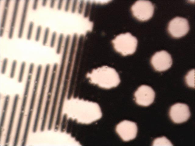

dot problem with my AGFA avantra 44
hello i need help with this problem, i have attached a pic of the problem, i dont know if is the car or the laser...
Hi, Peovide me with some information.
Do You see black lines on some areas of film?
Does it happen on a specific resolution? have you tried tried resolutions?
What is your exposure set at for different resolutions? Get an exposure test steps 10, resolution of your choice(ie:2400). Do you see the same problem?
Let me know the serial number and the Firmwares revision of your Avantra 44
Best Regards,
Farshad Faghihi | Armya Inc.
CEO and Service Manager
